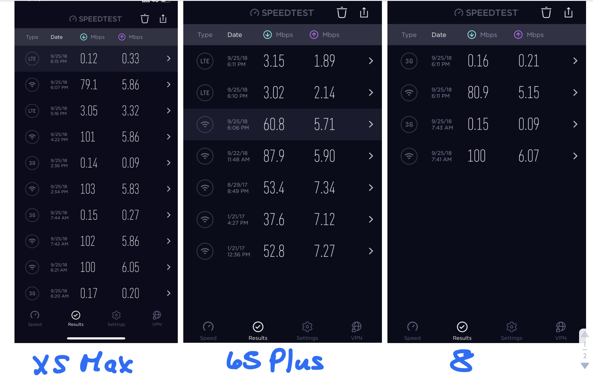

View attachment 789781 My test results all done at my kitchen table. All 3 phones were on iOS 12. Really also odd is that the 8 was running extremely slow as well. The older 6S Plus was clearly the champ here. A restore as new did help the 8 but not the Max. I also have an IPad Pro 9.7 that had had zero issues and runs as usual on LTE. The iPad has not been updated.

Hmmm...your 8 is slower than normal because its only getting a 3G signal instead of LTE. And your Max only got a LTE signal twice out of 5 tests (others were 3G like the 8). That is weird!
Absolutely bizarre I agree. This is why I think it’s a combination of software and hardware problems. The LTE signal earlier in the day for the Max was not at my house but downtown. We have always had LTE signal at the house. The Max actually only got the 3G download speed ever at the house. I totally thought initially it was all software related as the Max and 8 were both on iOS 12. I had to swap my Sim back to the 6S Plus to see that it was the only phone in the house with LTE. The Plus also on iOS 12. Believe me I was trying to figure it all out in hopes of getting a fix for it. Apple ran all their tests on it and could definitely see how slow it was on LTE in their store. They weren’t able to fix it.
The other thing with the Max was that I could do a hard reset and get LTE for like 3 minutes and then it would revert to showing 4G but only test at 3G.

I know nothing about the chipset or 4x4 MIMO - not that technical. These are actual test results. They are what they are. I did capture all these to bring in to show Apple. They didn’t even look at them, only the Max which they clearly could see had an issue that they couldn’t fix at this point. Thus the return.
The test results for the 6S Plus were a couple of minutes delayed as I had to swap the Sim to it and fire it up. And faster? I wouldn’t say the results are fast at all but at least getting LTE and not 3G.

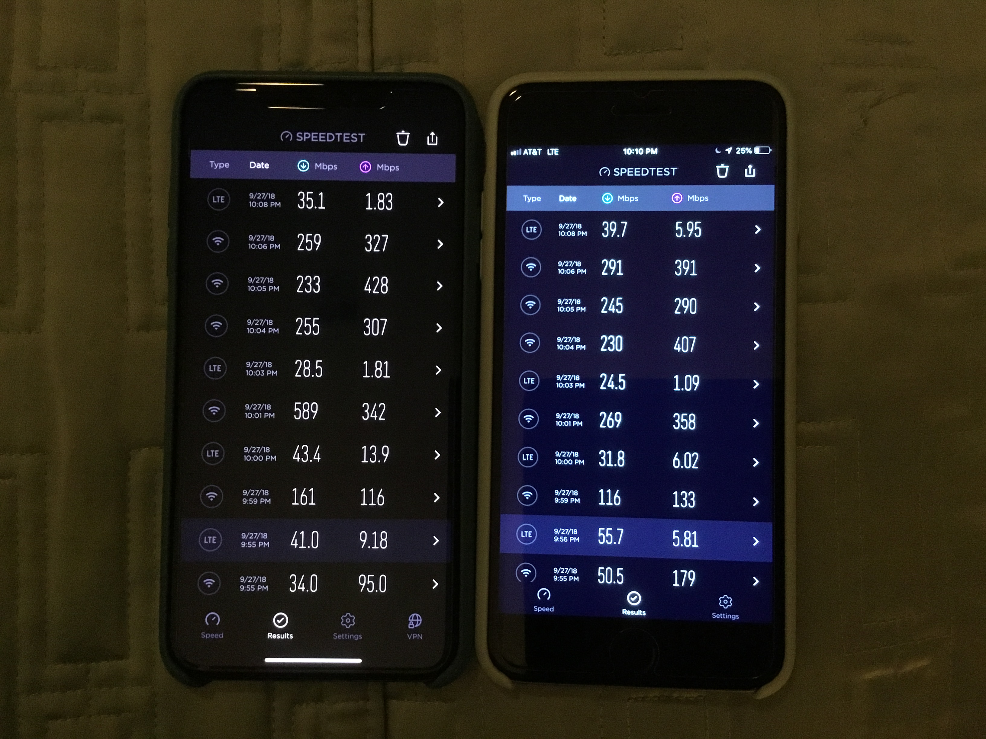

Finally had some time tonight to borrow my old 6s plus from my wife and did some side by side Speedtests in various places around the house.
Any thoughts regarding the results?
