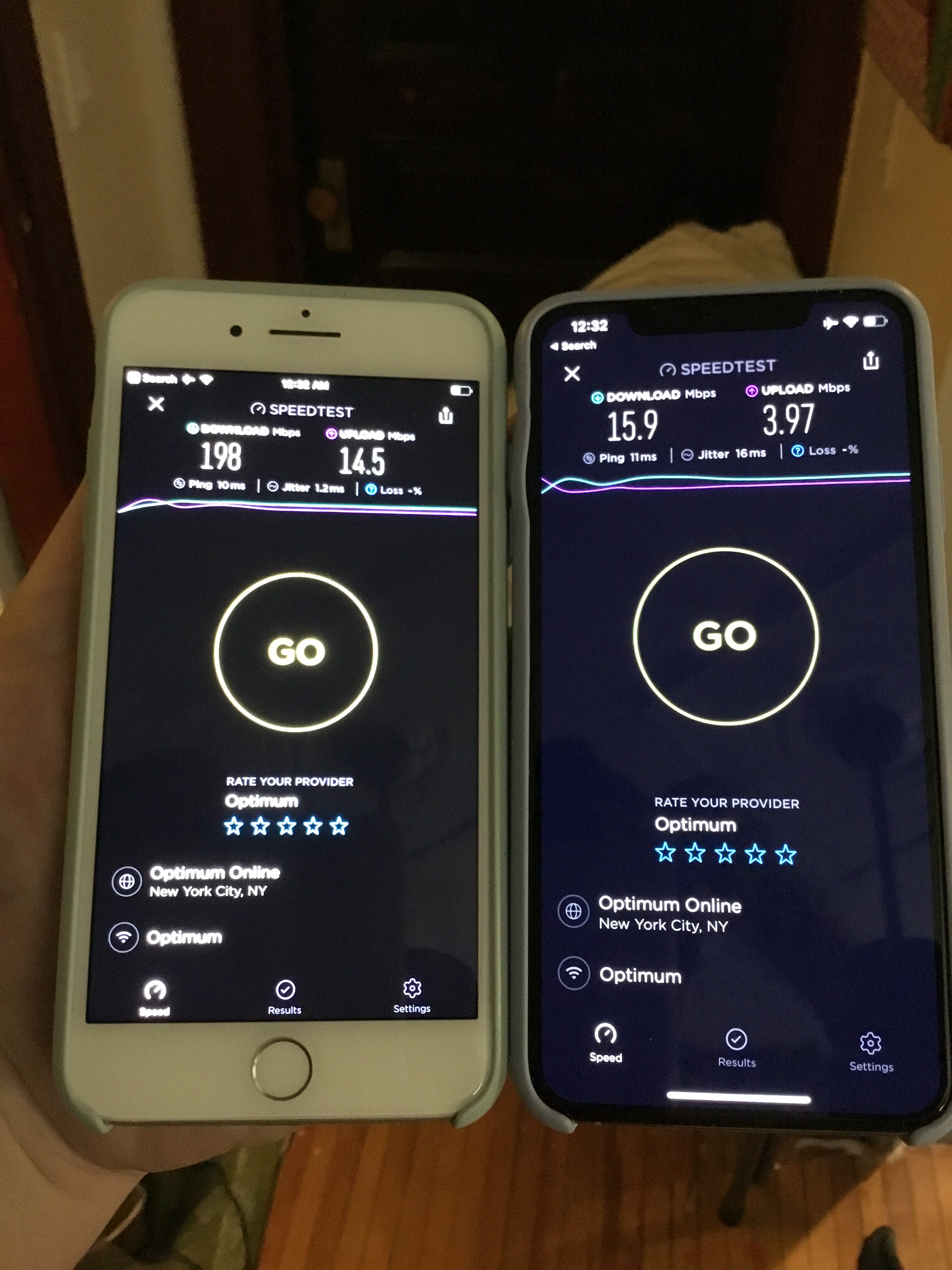

[doublepost=1538887787][/doublepost]My Wi-Fi side by side 5ghz XS max and 8+ (separate SSID than 2.4) so yes, both using 5ghz

Guys, speed tests are great and all but really don’t tell us much. Even if you’re doing two phones side by side, it may mean less than you think.
Why? Band acquisition. You need to be sure that not only are they in the same place for these tests, use a tripod and do several tests, but, you need to be sure they’re pinging the same serves, and the big one: the same bands.
If your phone is getting crappy speeds on say band 41, and the other one is getting good ones on band 26, you’re not comparing apples to apples. And remember, some of the older phones don’t even receive some of the bands in use now.
So make sure you use field test mode on both to verify that as you’re testing and do multiple tests to help rule out variables.

2. At home, the XS D/L speed over LTE is absolutely atrocious even with two bars. I just tested several times and got around 1 Mb/s or less with a wildly fluctuating latency.

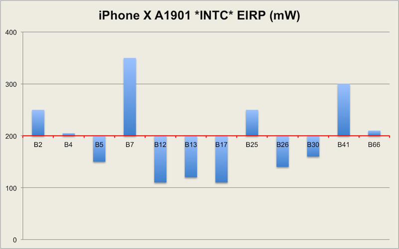

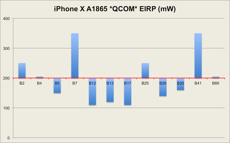

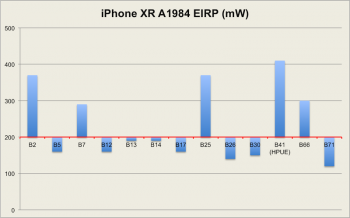

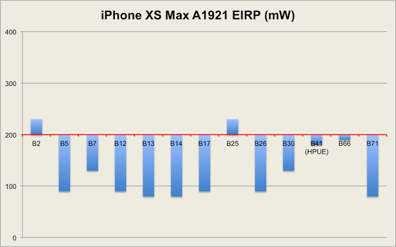

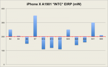

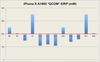

It's interesting that the X uses steel. I think the Qualcom Intel thing was an intelligent place to look, but the fact they have a side by side test that proved they are roughly equal and why they likely aren't the culprit was satisfied for me here. -here's the quote from the link:
"The two 2017 iPhone X variants -- with Qualcomm base-band and with Intel base-band -- perform almost identically in RF testing submitted in their FCC authorization filings."
Same antenna, difference intel and qualcom, identical lab tests.
Also, the antenna (RF) performance of the X moderately was worse than the 8 series, but the hardware was basically the same on the antenna side of things.
So, maybe Apple figured since the RF performance of the antenna with steel was only incrementally worse, they didn't have to test the new chassis to see if the new 4x4mimo band addition to the antenna would be any different, but from what I gather, you can be surprised how adding something like that under enclosed conditions performs much worse or even much better. A lot to do with positioning etc.
So maybe it's a steel frame+ the 4x4mimo+ likely some software fine tuning, I don;t know how 4x4mimo works, but I don;t think they can tweak individual power to individual antenna bands, that would be the ideal software fix. I think they can only raise the overall power, which is maxed out already to the xs and xs max. Also stated in the article I linked.
All I'm saying is that not testing the new antenna live in the new chassis when you believe you've basically already done that is a believable scenario.
