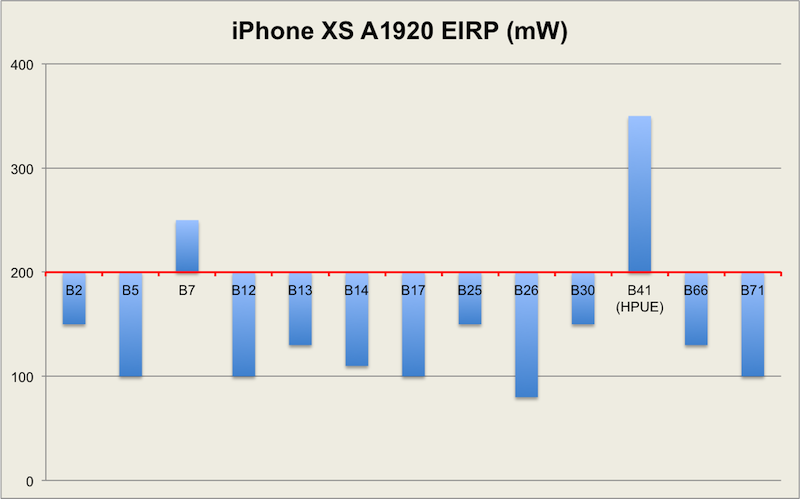

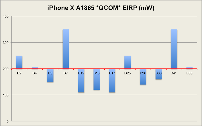

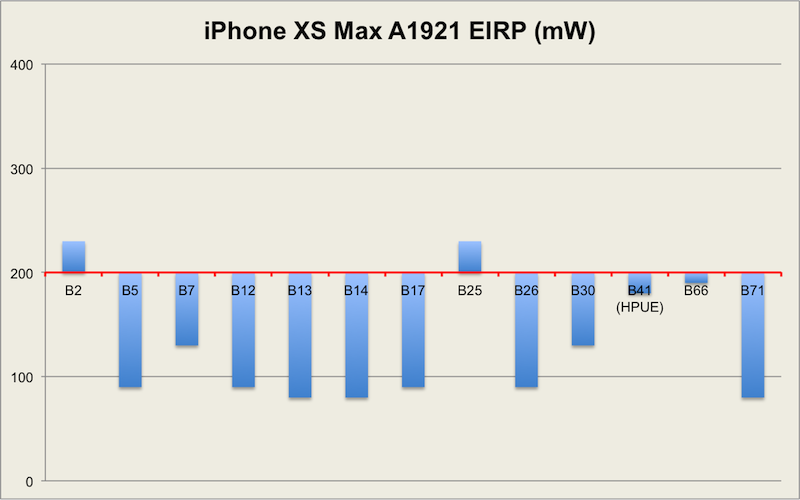

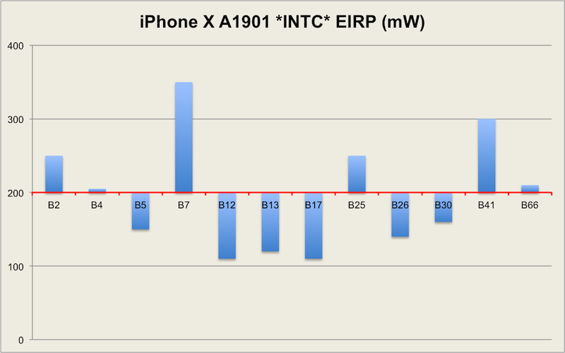

You're correct about the iPhone X last year. It has a stainless steel frame and chassis and it has good reception ratings based on those FCC documents. To me it's starting to look like 4x4 mimo antenna is the culprit. A few software tweaks could possibly help remedy the situation. I'm sure Apple seen the documents and findings but didn't realize the "real" world impact it would have.View attachment 792968 View attachment 792969 View attachment 792970 View attachment 792971 View attachment 792972
Top notch post, very well done and said. Just look at that XS Max, my sad current device. It’s striking. I’m calling ATT now, reverting to 8+ and going all in on XR, but it’s likely my last iPhon me unless Apple makes connectivity a priority. Now that I live in the city and move around a lot, I need top flight connectivity, and Apple simply doesnt offer that in every model. Rarely even.

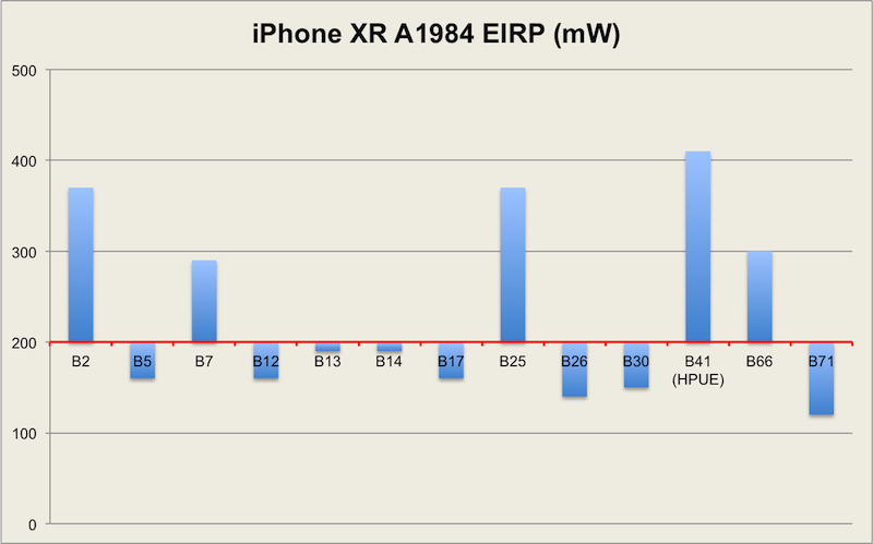

https://www.wiwavelength.com/2018/09/iphone-xr-trades-4x4-mimo-for-greater.html

The Xr chassis only supports 2x2 MIMO, so there was basically nothing to redesign: they’ve used the regular X antenna design.
