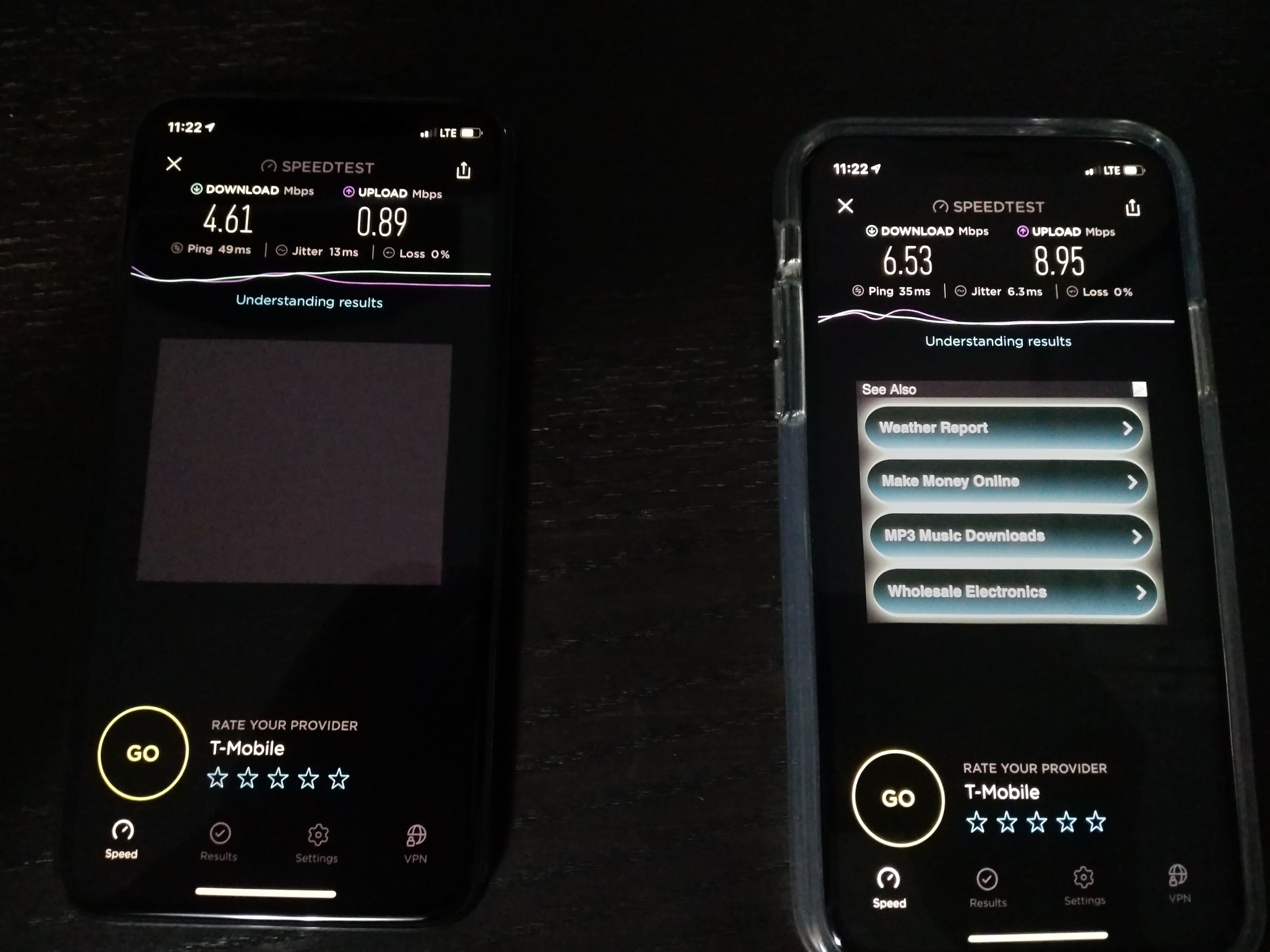

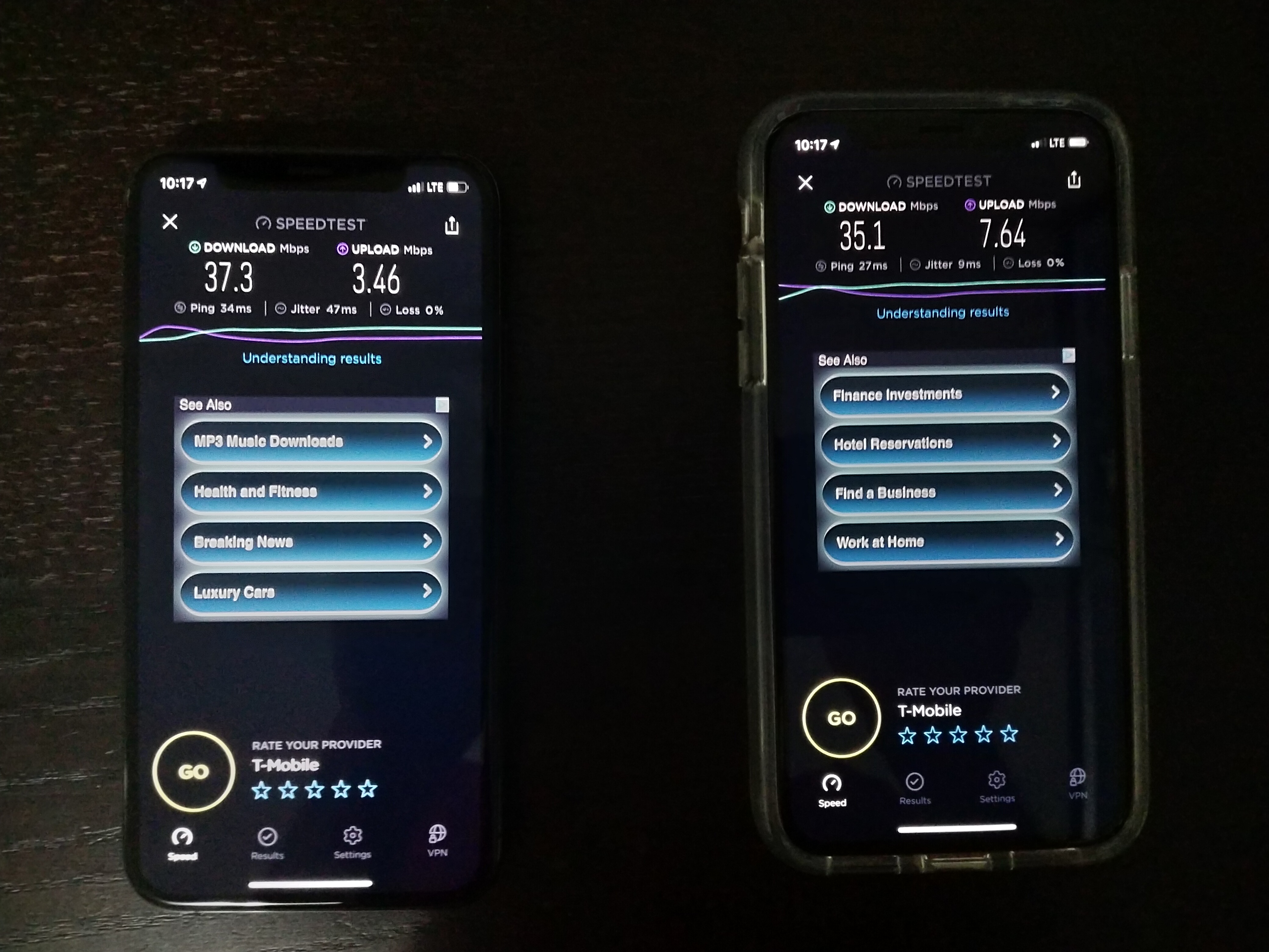

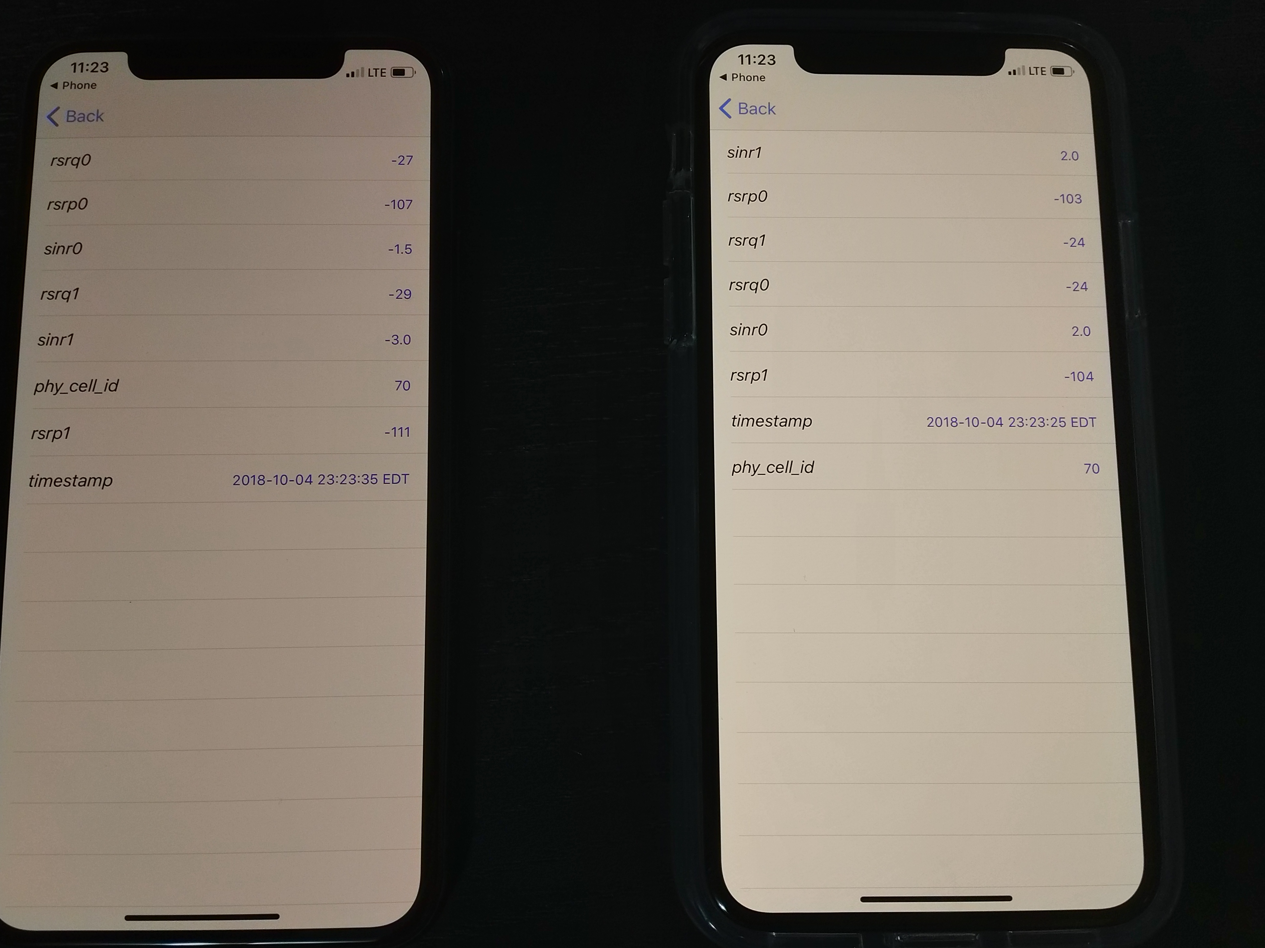

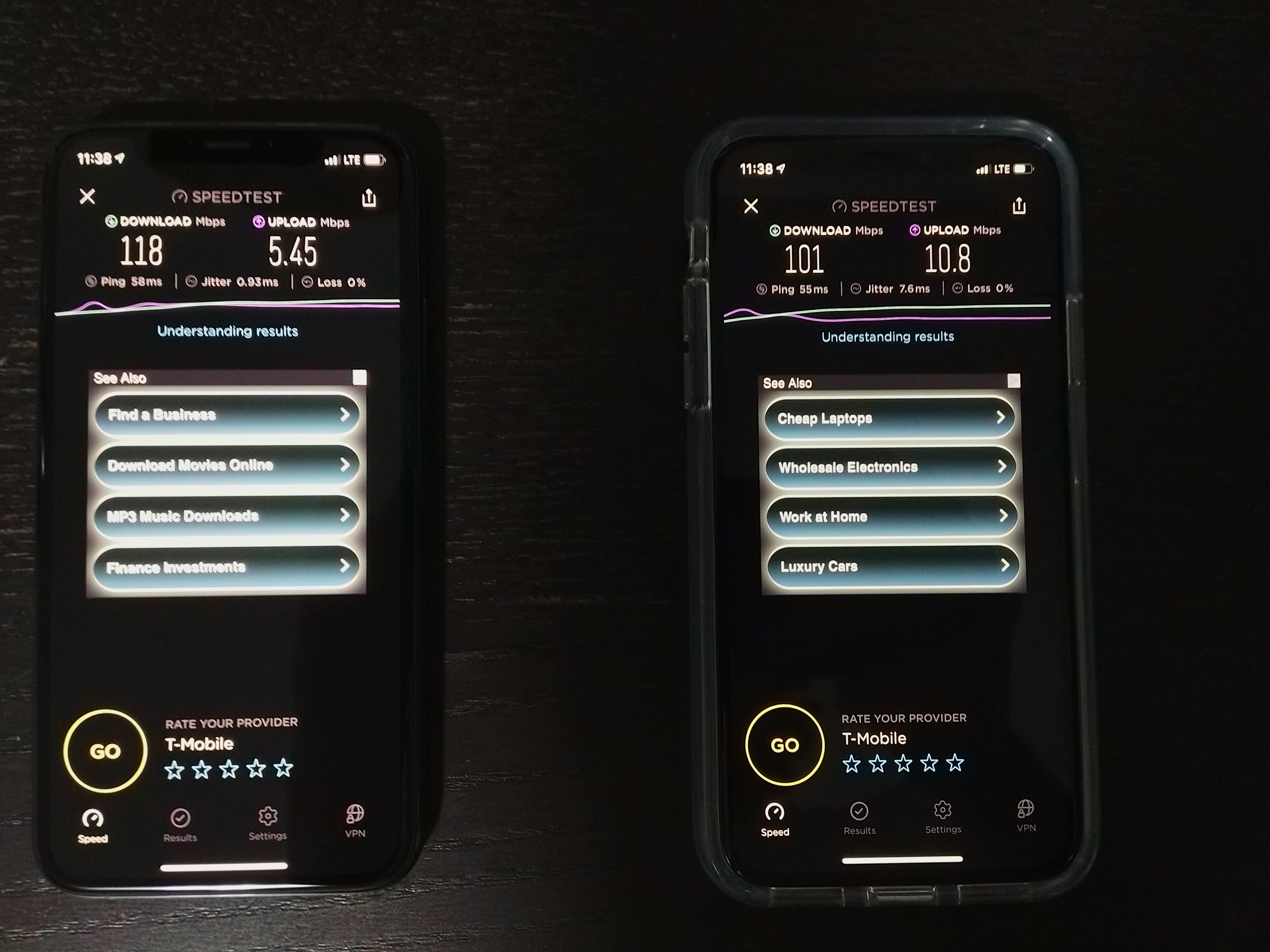

What band is PCI 106 and 273? My guess is 106 is band 12 which has a very limited amount of bandwidth. Per the T-Mobile engineer I spoke with the network will keep your phone off band 12 until signal drops below -115 dBm. What's happening, and you would probably experience that on any phone, is it finds the strongest signal and then is instructed by the tower to switch with a band with more capacity.
IMO if you're at a solid -110 dBM on Band 4/66 you are getting adequate signal and should see good speeds assuming the network is not congested. The issue I am seeing with my Xs is upload performance is terrible, side by side with an Intel iPhone 8 or X the Xs usually shows similar or better download speeds but 1/2 or worse upload. With the Xs I've also had several instances with VoLTE calls where I can hear the other end perfectly and they can't hear me.
Attached you can see side by side speed test results and signal levels. iPhone Xs is on the left and iPhone X (Intel) is on the right.
IMG_20181004_232254.jpg IMG_20181004_232341.jpg IMG_20181005_101752.jpg IMG_20181008_233836.jpg
