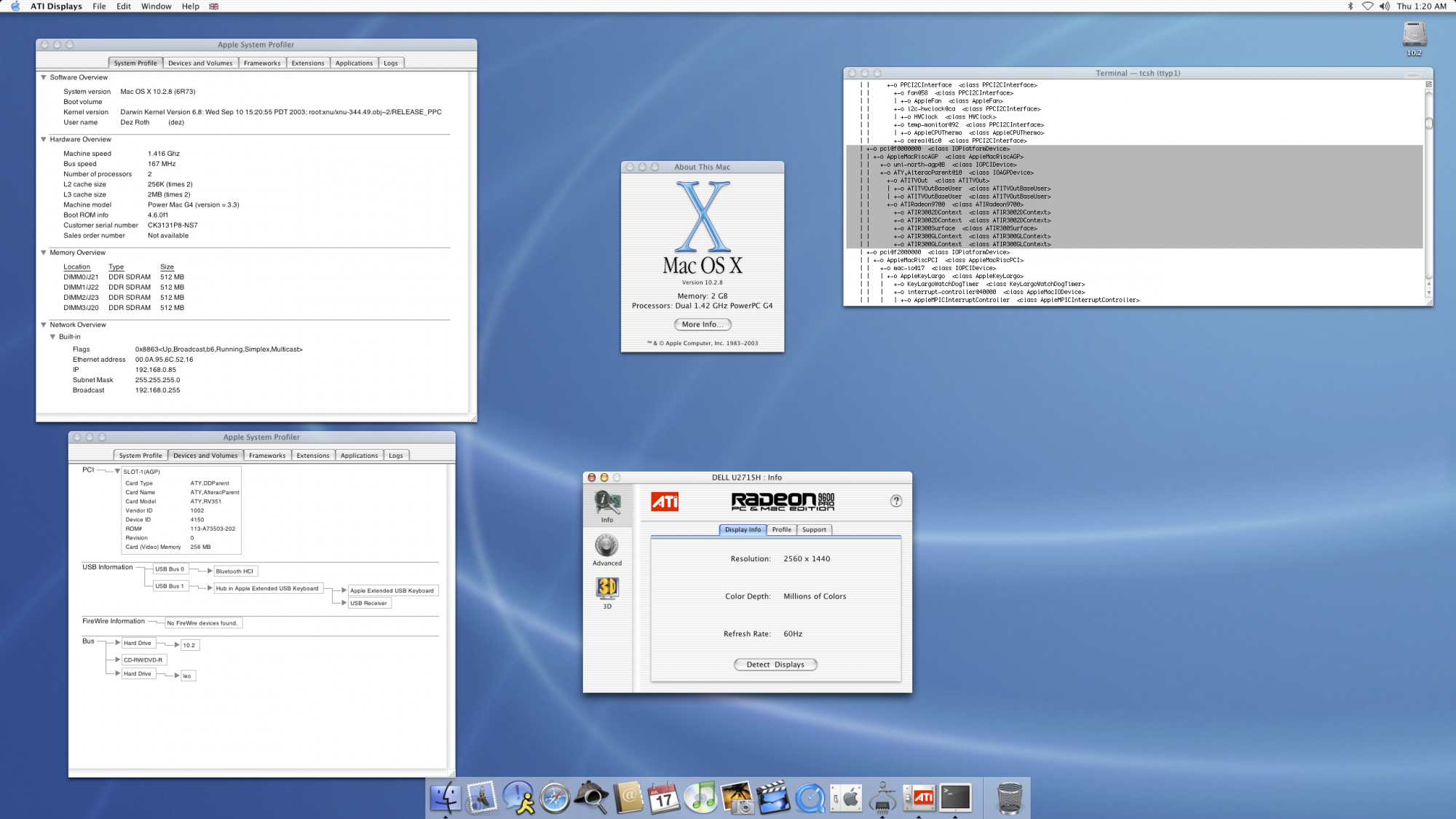

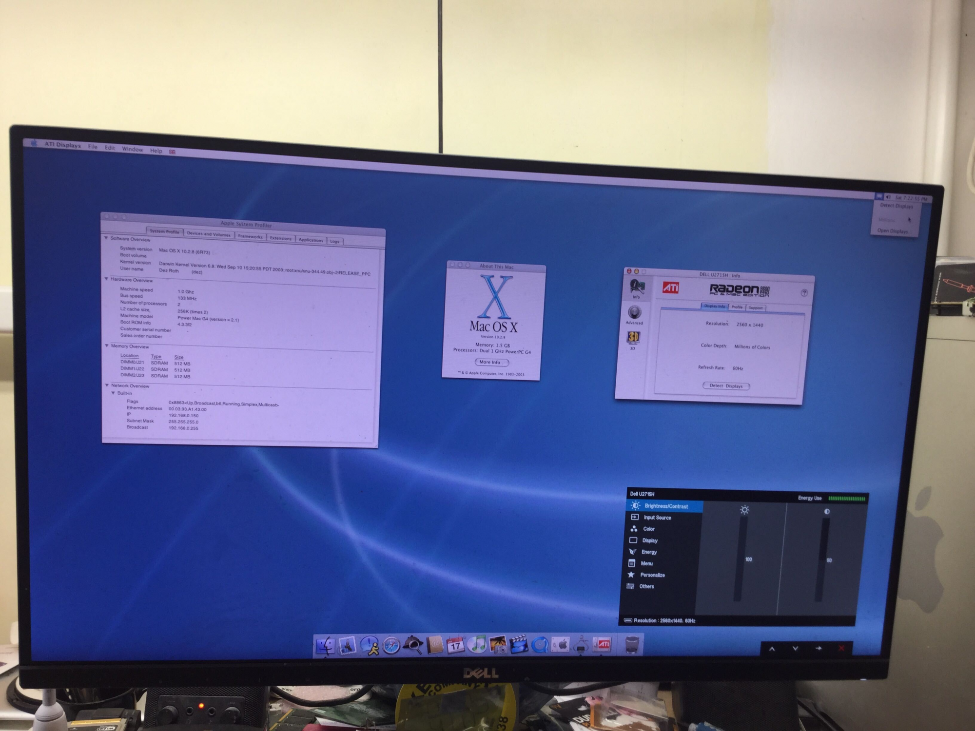

Boom! :)
I realised as I was setting everything up that the PC Mac Edition 9600, is a 9600 Pro, so it has the same Device ID as the original PM7,2's 9600 Pro which is supported by 10.2.8 so I was a bit more confident things would work but the questions still remained, would the kexts play ball thanks to the same Device ID or still Kernel panic because of different hardware/ROM's from that 64MB G5 9600, secondly would the external NDRV the 9600 PC and Mac Edition requires, work in 10.2.8 and thirdly would it work at 2560x1440@60Hz?
well as you can see it does! as you can see the NDRV works I have 2560x1440 at 60Hz and so does GPU acceleration :)
amusing the displays control panel would crash when I tried to open it when connected to my 2560x1440 Dell U2715H monitor (connected up through my atlona AT-DP400 I kindly got from @Amethyst1 a while back exactly for this sort of experimentation :) )
but was fine when connected to my normal single link DVI test monitor, I forgot to enable monitor control in the menu bar so dont know if that would work, I do know that when I hot plugged the 2560x1440 monitor it crashed the system, but thankfully cold booting with the 2560x1440 monitor worked :)
twas pretty wild seeing Jaguar at 2560x1440 on my main monitor LOL (even just seeing the OpenFirmware prompt at that rez is always fun LOL)
Any chance of this working in 10.1.5 even without accelerated graphics? :)

Oh, wow! :) Thanks a lot for trying this out!
What exactly did you have to do? Just install the ATi drivers? I guess you'd have to install Jaguar first with a different graphics card installed, as the install DVD would not work with the 9600 PC & Mac edition at all?
Do you think this is a "stable" configuration?
(If yes, this would probably "force" me to buy a Power Mac and try to find this card after all :D … I guess a G5 PowerMac7,2 would work fine as well?)
you can boot 10.2.8 at least without installing ATI Displays 4.5.7 first, but you boot to a broken greyscale because of no NDRV (and OS X not knowing how to use the OpenFirmware frame buffer properly!)
so I would recommend using another/the machines factory graphics card to install the ATI Displays 4.5.7 stuff first
as for stability, its not something I particularly tested but it did not crash on me randomly, but I have not tried changing rez on the fly and I do know hot plugging it once did crash the system but that was not something I revisited to see if it was a one off a sure fire way to bring the system down LOL
(I just unplugged the secondary 1080p monitor and cold booted with just the 1440p monitor hooked up and all was fine)
and once it was up and running it seemed fine
yeah a PowerMac7,2 should work with the appropriate G5 build of Jaguar (restore disks for which are on the Macintosh garden) but its not a configuration I have personally tested
Reactions: Amethyst1
Ok, I see.
Could you, by any chance, check if you can reproduce the crash through hot-plugging or changing the resolution? Would be awesome!
Do you think it could have something to do with the adapter you're using?
Reactions: LightBulbFun
Ok, I see.
did a little bit more testing and can confirm that hot plugging my Dell monitor will crash the system, but it does it on both ports including the Single link port, so it might just be a bug with my monitor and the system or such etc
as long as you boot the system with the monitor already plugged in its perfectly fine, the little display preferences menu bar applet has no idea what to make of it tho LOL (probably the same reason system preferences crashes when ya click on displays)
