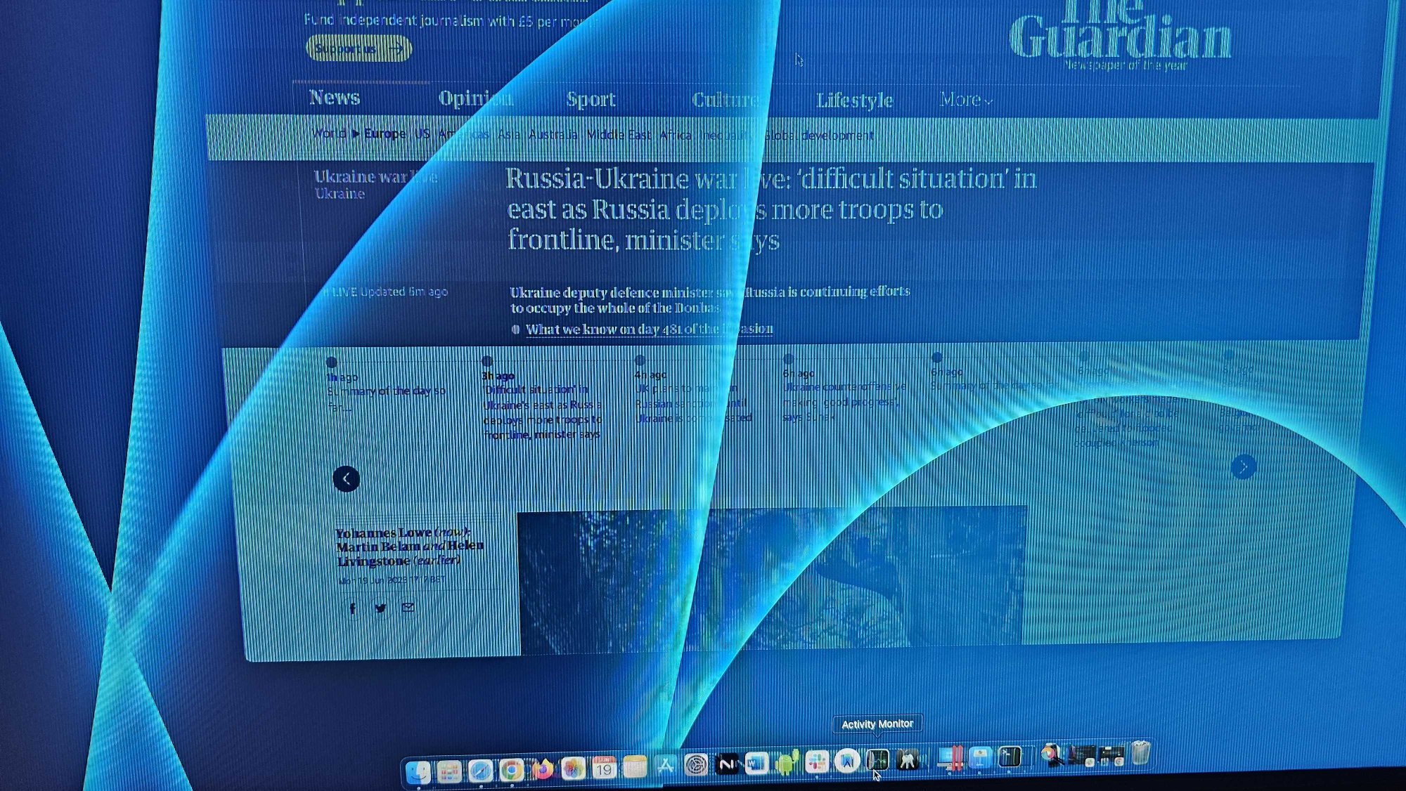

8) Strangest issue is the ghosting effect. I absolutely don't understand how this can be possible. It looks like burnout pixels with some sort of transparency, like if your display has been showing the same image for many months or years and then you changed it. It can't be removed by, say, scrolling the window or displaying a different content, it is there until you reboot. But strangely enough, it is not present on screenshots or via screen sharing.

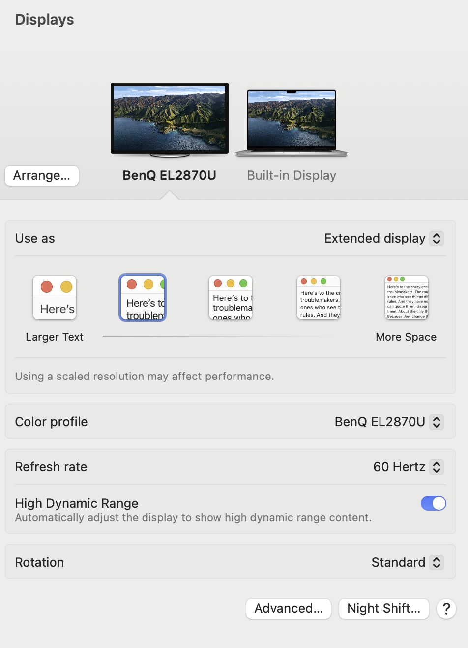

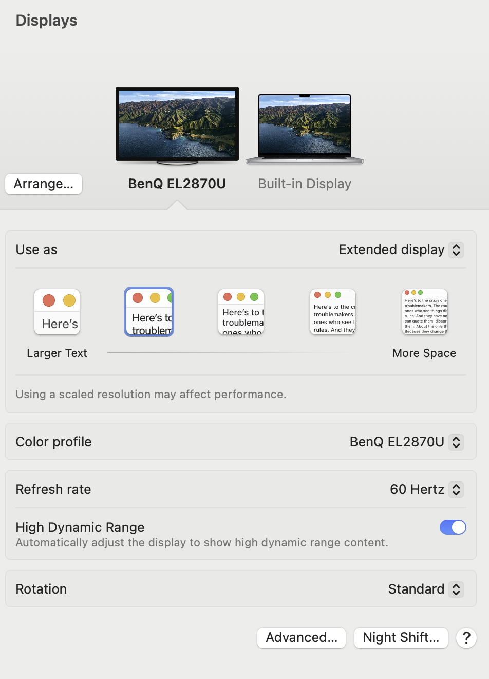

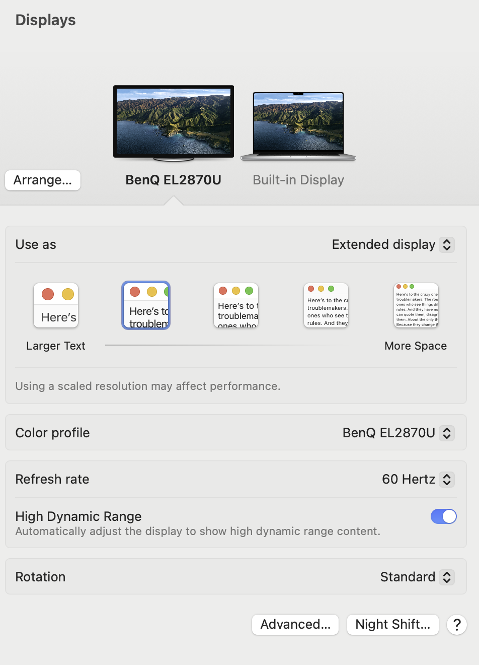

I have a BenQ 4k external monitor connected via HDMI directly to my M1 Pro 16". It flickers sometimes. I need to open up the display settings below and toggle "High Dynamic range" to on. The flicker goes away immediately.
It seems like macOS forgets the HDR setting sometimes, which causes it to flicker.

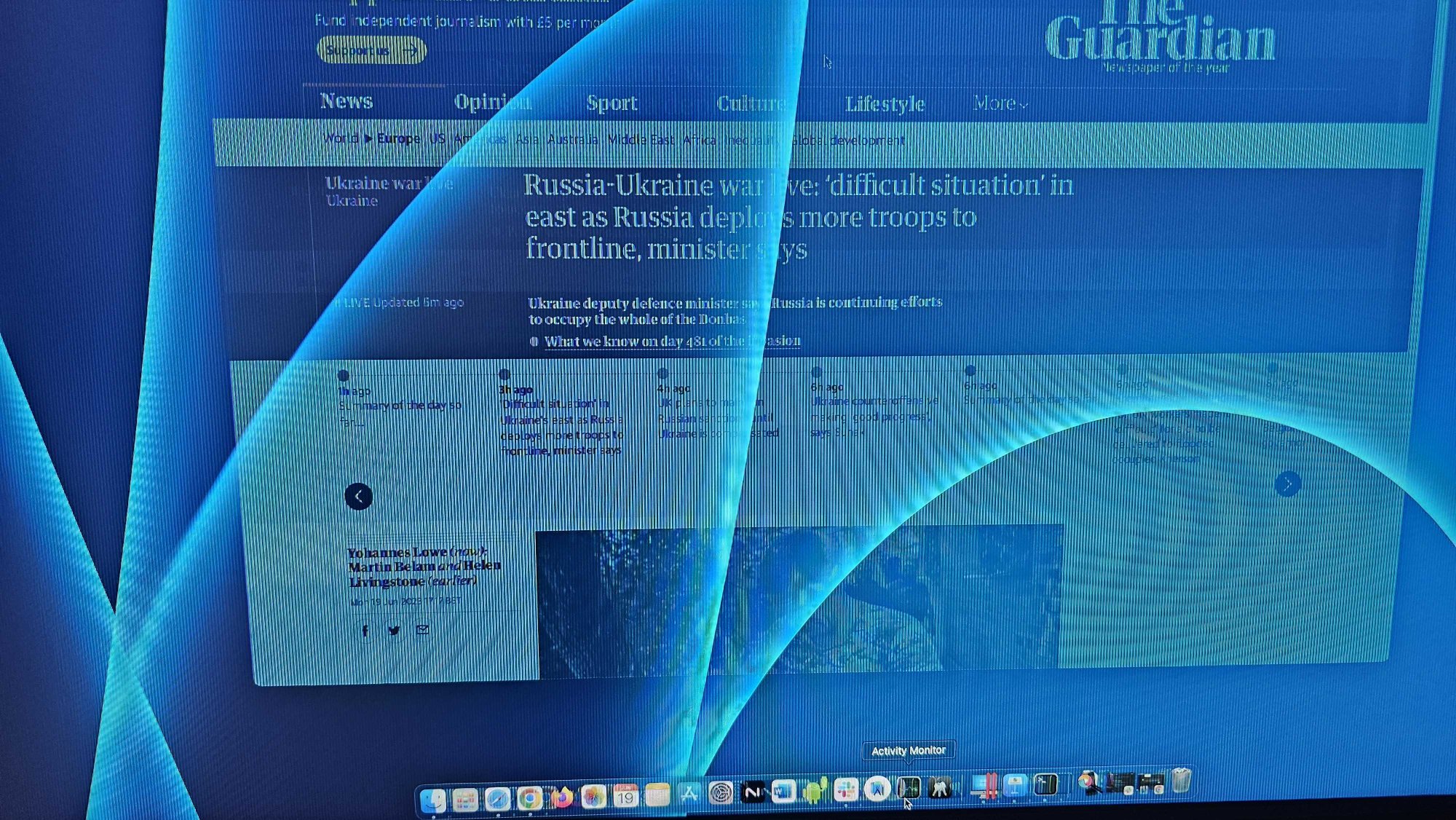

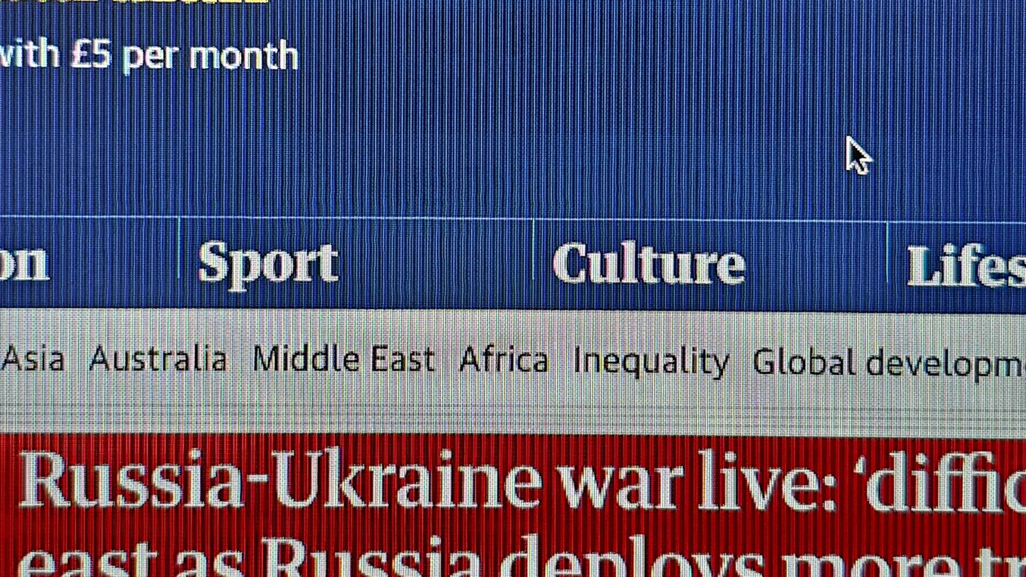

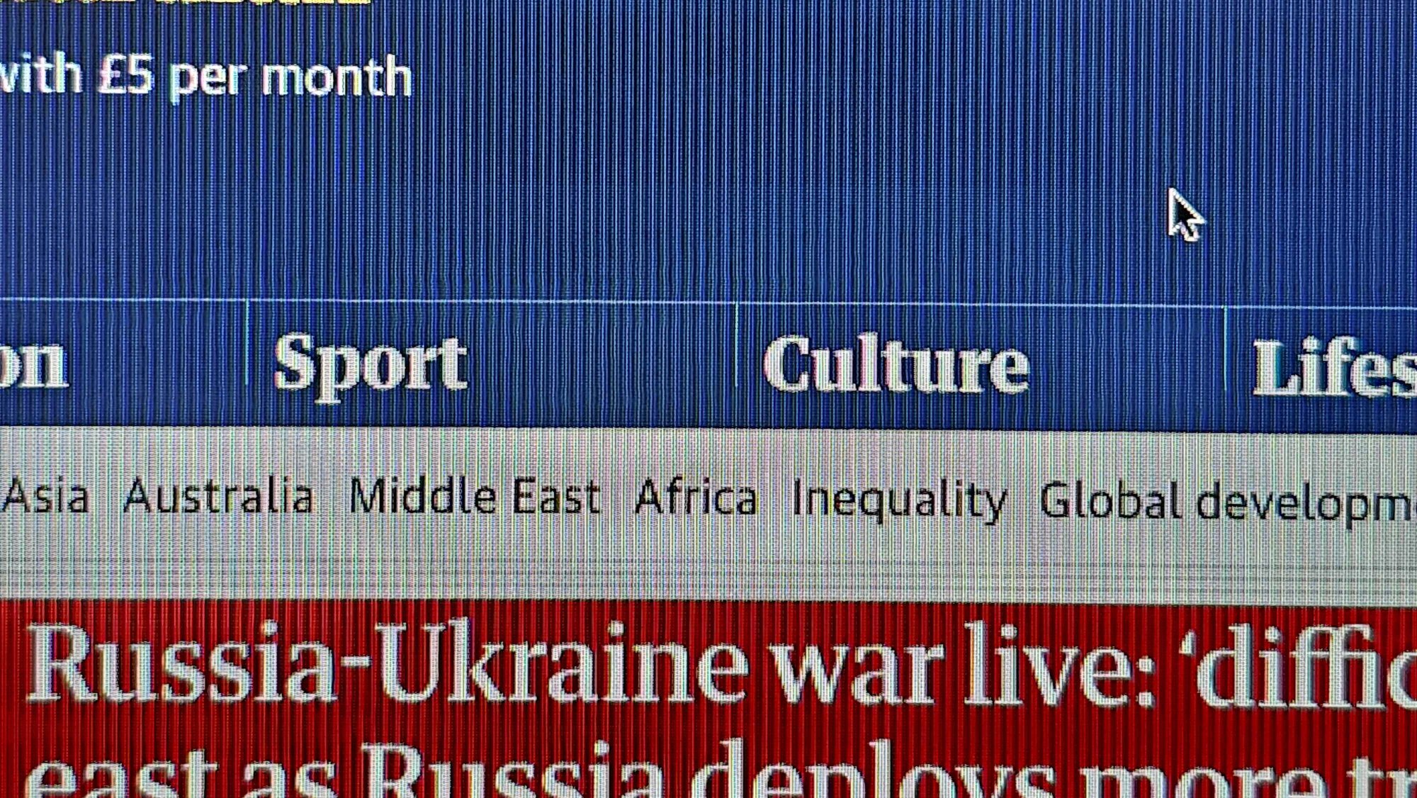

So another user here using an M1 Mac book Air. This issue has existed for me since day dot with this machine. I own an MSI 1440p monitor. I run this monitor in 1440p on a DP connection at 165 hrz. Obviously as we all know its the classic situation of every now and then horrific ghosting, with verticle lines all over the screen.. happens randomly but I do think I have a couple of instances where I see the trigger and its generally when windows are open over apps. Like in Slack, using workflows window in the application. If I have a lot of apps open this can trigger the state. I have a feeling that the more icons I have on my desktop, this can make the issue worse. However one way I can almost always trigger it manually outside of the above, is to open the Guardian news Website, and open the live news feed (ukraine is a good option). I keep feed at the start of the page, do not scroll down and immediately I see the lines, which then progresses to ghosting over the minutes. If anyone who is engaging with Apple wants a way to trigger it every time this works for me, and it may work for you.
I don't get the ghosting, but I do get the rapid flickering, which makes my Mac unusable for up to 30 minutes each time it happens.

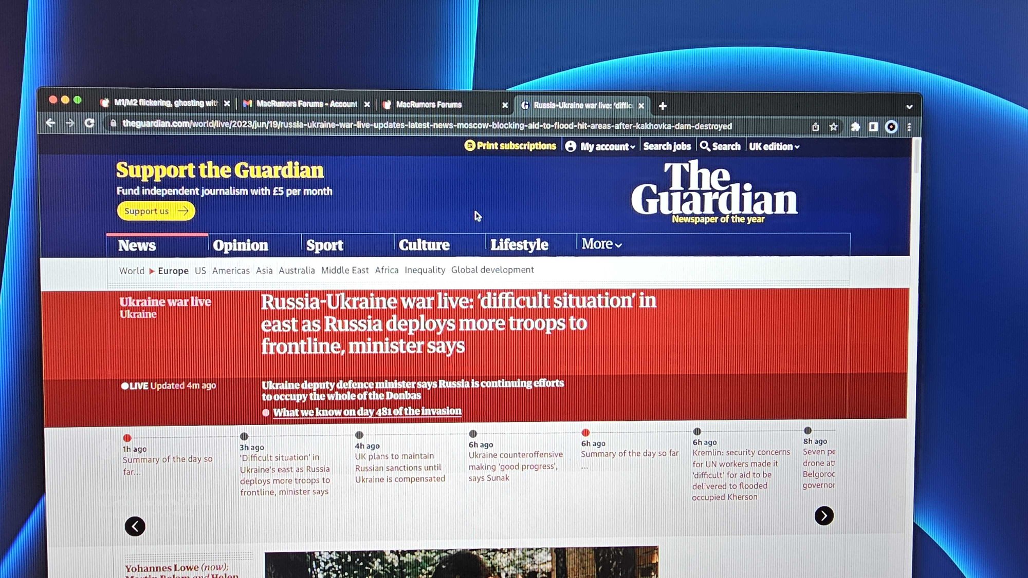

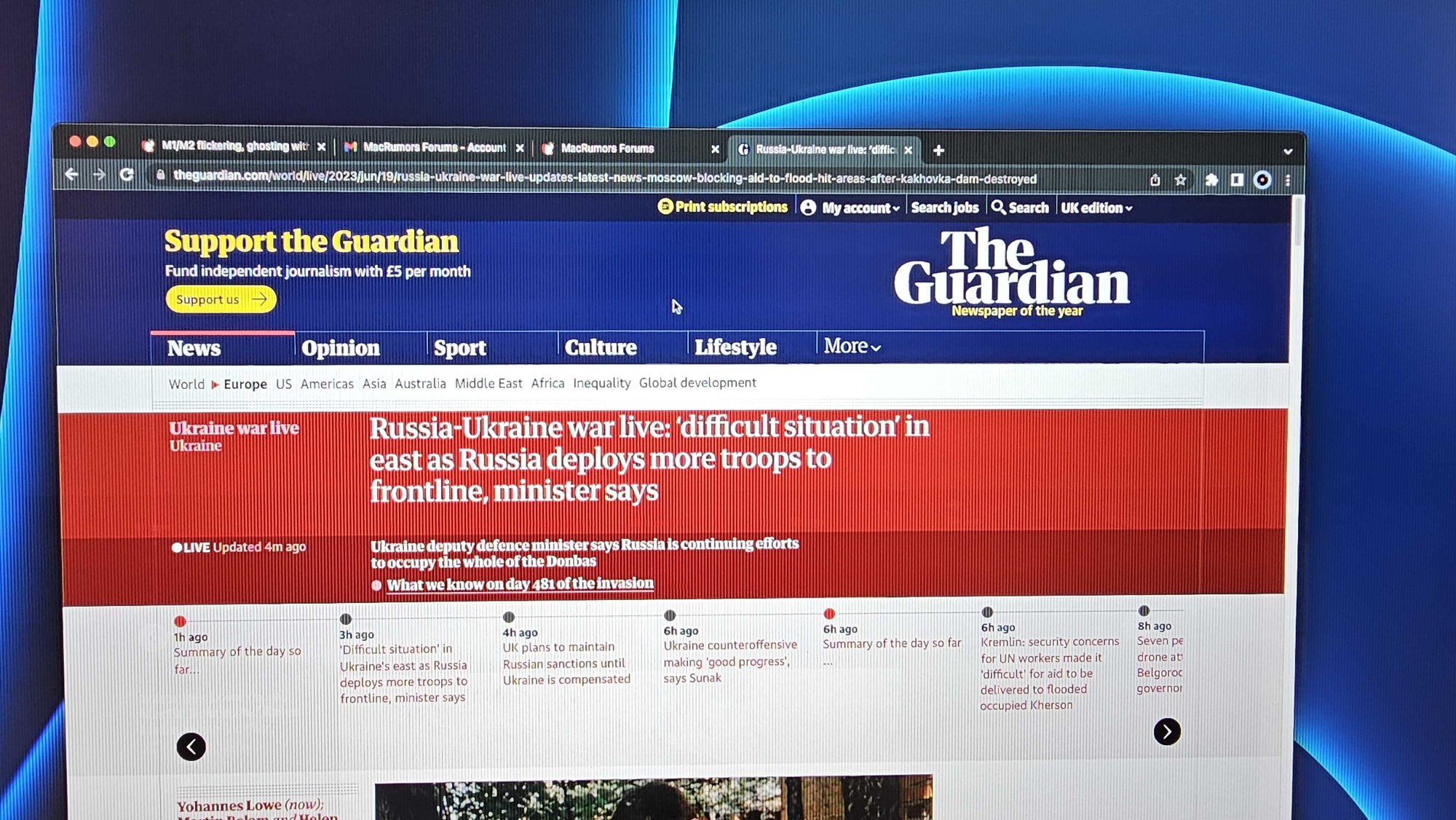

Oddly, it started just now immediately on viewing The Guardian website! This is such a weird (and extremely annoying) problem!
UPDATE: After the flickering died down, I opened the Guardian website again, and the flickering immediately came back. How odd! So far, it's only happening with Safari; if I open the website in Firefox, I don't get any flickering.
This happens to me all the time with my LG display. Seems to happen more often with the iPad Pro M1. But, I’ve seen it with the MacBook too.
So I've tried this multiple times today, and visiting www.guardian.com in Safari consistently triggers the screen flickering for me.
It thens takes around 10-15 minutes for the flickering to stop. I can't find anything to stop it - closing Safari makes no difference, I just have to wait.
