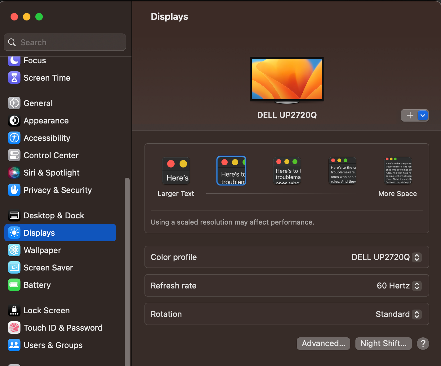

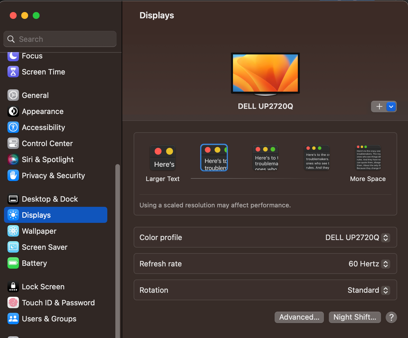

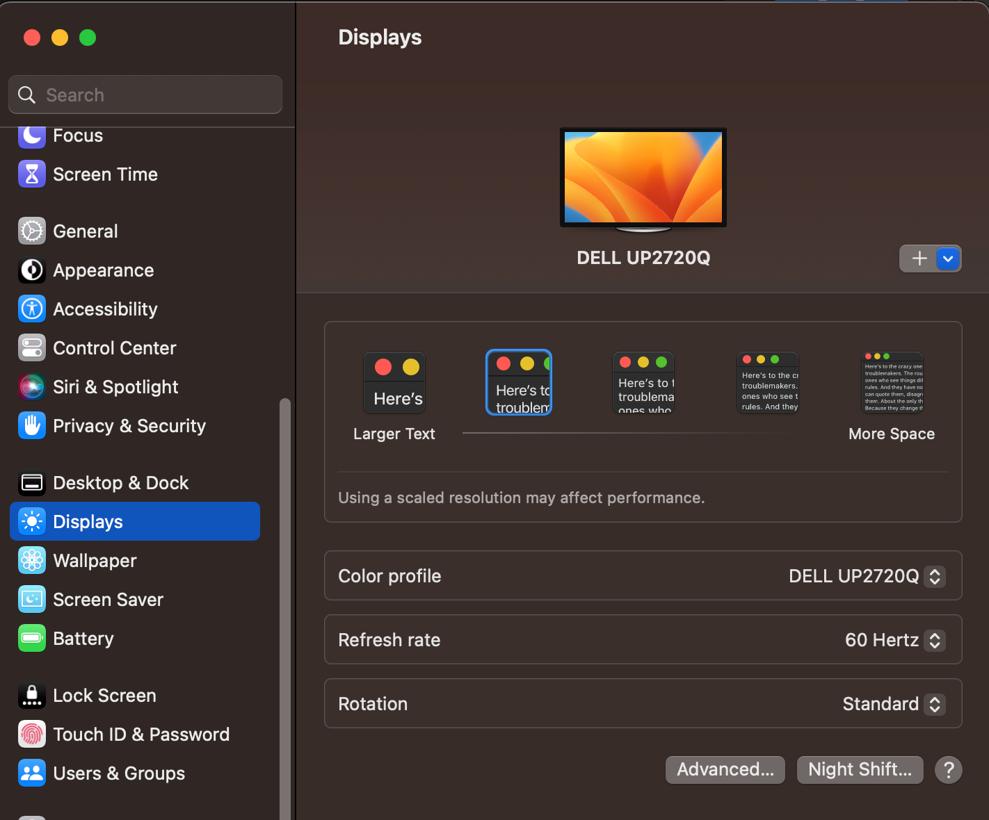

Hello everyone. We have multiple Dell 4k Monitor models in the office, and I wanted to share what I think is a reliable workaround for the issue. This was tested by me since buying my M1 Max MBP in 2022, so this is the experience of over a year.
Monitors tested, all 4k:
- Dell UP2718Q - no problems
- Dell UP2720Q - flickering / ghosting (specially the blue kind people photographed here)
- Dell U2720Q - flickering / ghosting (specially the blue kind people photographed here)
- Dell U2723QE - no problems
The flickering issue seems to manifest itself more easily when displaying large areas of dark greens and reds. Here's how I got to this workaround.
  1. I used f.lux at the time I bought my computer and every time f.lux kicked in the monitor started to flicker. Switched to Night Shift, in which the flickering seemed not to start as soon.
  2. I tested all manners of dongles, cables, docks and so on. No dice. Here were tested multiple Satechi dongles, Elgato Dock and Pro Dock, Razer Dock. Also high quality HDMI, Display Port, USB-C to HDMI, USB-C to DP and so. Nothing worked.
  3. After some time I stopped using Night Shift and True Tone. Seemed to improve.
  4. After some time I disabled DCC/CI on the problem monitors. This, combined with not using Night Shift and True Tone seemed to to the trick.
This is not a happy ending, but I got multiple workstations working. Each has a dock and two monitors, they seem to be chugging along more or less happily, and no one is complaining about flickering.
