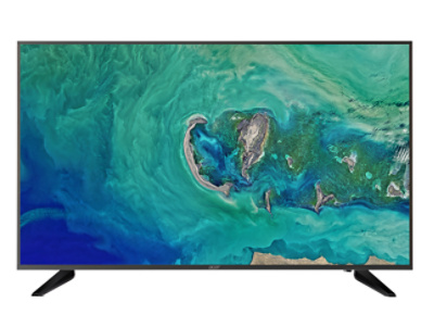

Fixed all my issues moving to an Acer 43” 4K monitor with DisplayPort.
More details...! How are you using it? How far away are you sitting? I've been thinking of something like this for my work PC, but image quality is super important and I fear that TV-sized monitors are essentially TVs (which don't meet the same standards as a photo-editing monitor).
