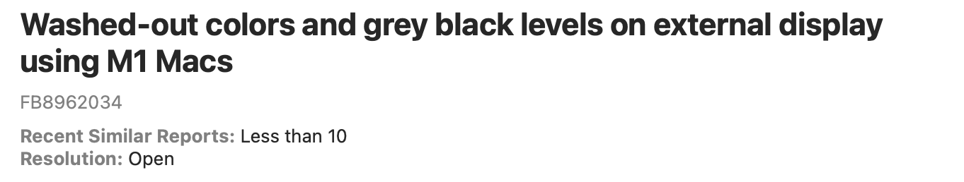

Filed FB8946046 through Feedback Assistant. I encourage anyone affected to also file, referencing this number.
Make sure your problematic display is connected at the time of writing the feedback so that it is present in the system profile sent to Apple.
Friendly reminder to consider this time investment to push Apple for a fix.
