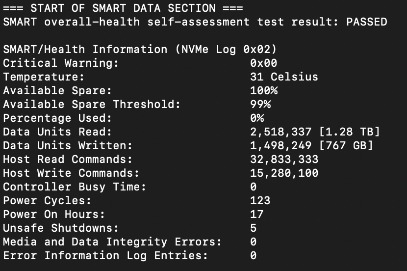

I made an account just to chime in regarding this issue. I just bought a 256 GB 8G Ram M1 MacBook Air a few weeks ago, and I'm concerned about this, as I do see quite a lot of swap being used when I check the activity monitor.
I called apple support to discuss and the agent said he had never heard of this issue at all.
I am sharing my results here, they aren't crazy like what some people have posted - this is after about 3.5 weeks of use since I got it, but I do run some intense applications like Figma (I know.. maybe 8gb wasn't the way to go). I don't quite understand all the readings especially regarding power cycles. My system information has confirmed that I only have about 10 charge cycles completed, which I know this from memory to be true. BUT this shows a much higher number (123?), and so now I am not sure how accurate the rest of these readings are?
Does anyone understand what's going on with the power reading - AND if this is normal wear for the SSD after just under a month or do I also have cause for concern?
Do you have Energy Saver -> Put hard disks to sleep when possible selected? Wondering if that's considered a power cycle.
