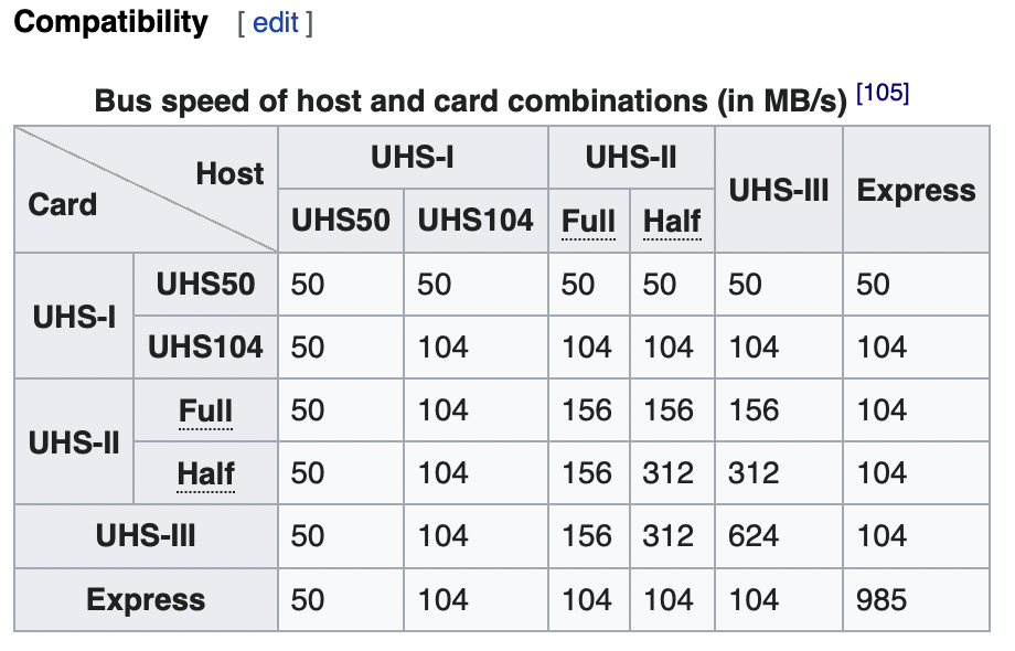

If the spec was USH-iii then it is not backward compatible in speed to USH-ii... it goes back to USH-i speeds so all the expensive USH-ii SD cards that I used with my camera would be faster with a card reader.
UHS-iii won't hit commercial manufacturing and the slots are only backward compatible with UHS-i not UHS-ii cards which are available and used today.

Copying the table from Wikipedia... you are correct that UHS-iii cards do fall back to UHS-ii speeds with a UHS-ii slot.I have corrected my posts.
UHS-iii cards are not likely to be commercially available though.
SD Express cards fall back to UHS-i speeds unless a SD Express slot is implemented. If a SD Express slot is implemented then all UHS-xxx cards are at UHS-i speeds except for SD Express cards.
My point is that UHS-ii slot implementation is still limited even though Sandisk announced their first UHS-ii card in 2014. The USH-iii spec and SD Express spec have been available for years now and are not commercially available. Lexar has announced a SD Express card for 2022 which will be faster than current CFe cards but falls back to UHS-i speeds.

I think they may be getting confused with SD-Express. I have read that using a UHS-II card with an SD-Express reader will revert to UHS-I speeds because the 2nd row of pins on the UHS-II card are not compatible with SD-Express.
UHS-III is just a full-duplex version of UHS-II AFAIK, i.e. up to 312MB/s in both directions simultaneously.
[Edit: looks like I have the first paragraph the wrong-way round. If you inserts an SD-Express card into a UHS-II (& presumably UHS-III) slot, it drops down to UHS-I speeds. I'm not sure what happens if you insert a UHS-II card into an SD-Express reader - hopefully, it still works at UHS-II speeds. ]
[Edit 2: in practice, the fall-back of SD-Express card to UHS-I speeds when used in UHS-II readers may not be as bad as it sounds. You would presumably only buy SD-Express cards for use in SD-Express readers, and would only use the card in a different reader in an emergency (i.e. you lost your SD-Express dongle). I don't have high-hopes for SD-Express as a format though unless it becomes as cheap to make the cards and readers as UHS-II is currently. I think CFe may have an unasailable lead already ]
