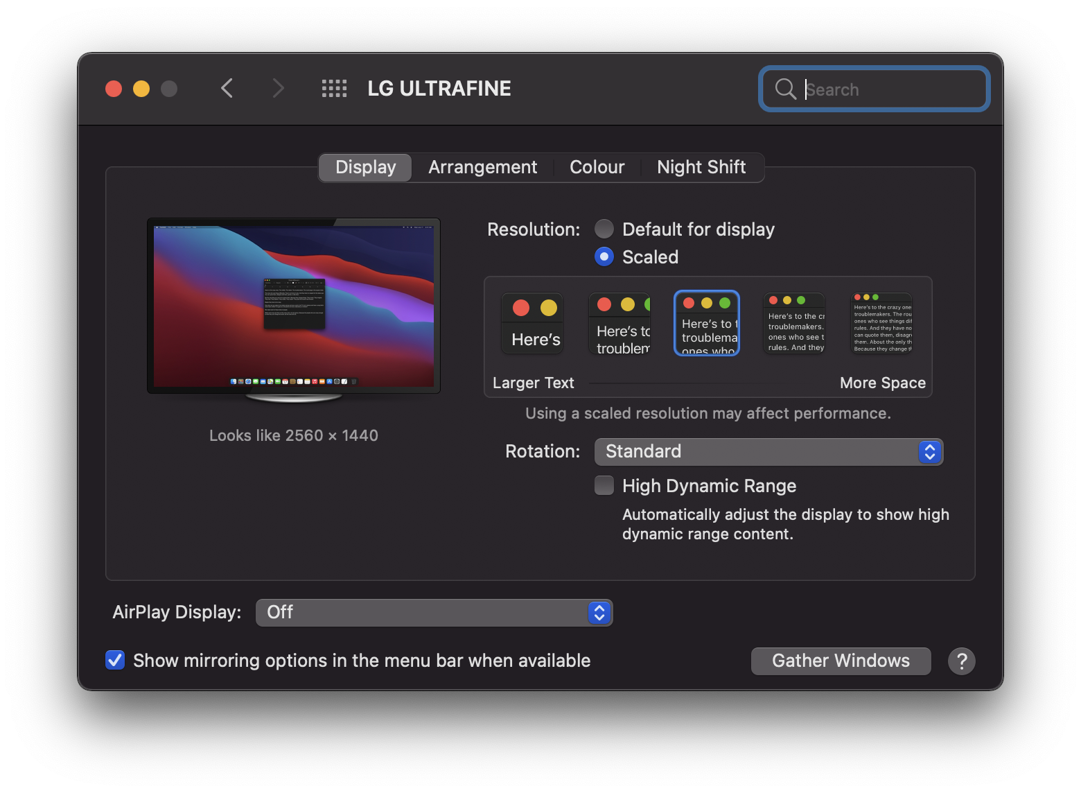

I changed the resolution and now the monitor has gone berserk. It goes totally blank for about 10s and shows the screen for a sec and goes blank again and the cycle repeats. It doesn't give me enough time to change the display settings back to default or something else.
Have to call LG support.
That looks like a nightmare - glad you got it sorted.This was a pain to fix.
First I tried https://support.apple.com/en-au/guide/mac-help/mchlp2660/mac but it did not help.
I had to take a video of the screen, pause it when the convoluted screen was visible, look carefully where the mouse cursor was, move the mouse carefully, take another video, pause the frame and adjust again until I could navigate my way to Displays settings preference pane and click on Default after about 20 cycles.
Once I could fix the screen this way, I installed LG's OnScreen Control and ensured that the monitor has the latest firmware.
Then switched DisplayPort to 1.4 from 1.2 in the monitor settings.
After that, I did not dare to change the resolution to Scaled with the fear that it would make the monitor back to the unsupported resolution.
Used SwitchResX to select 3008x1269 and can finally breath a sigh of relief.
Uploaded one of the videos when the problem was there here:.
