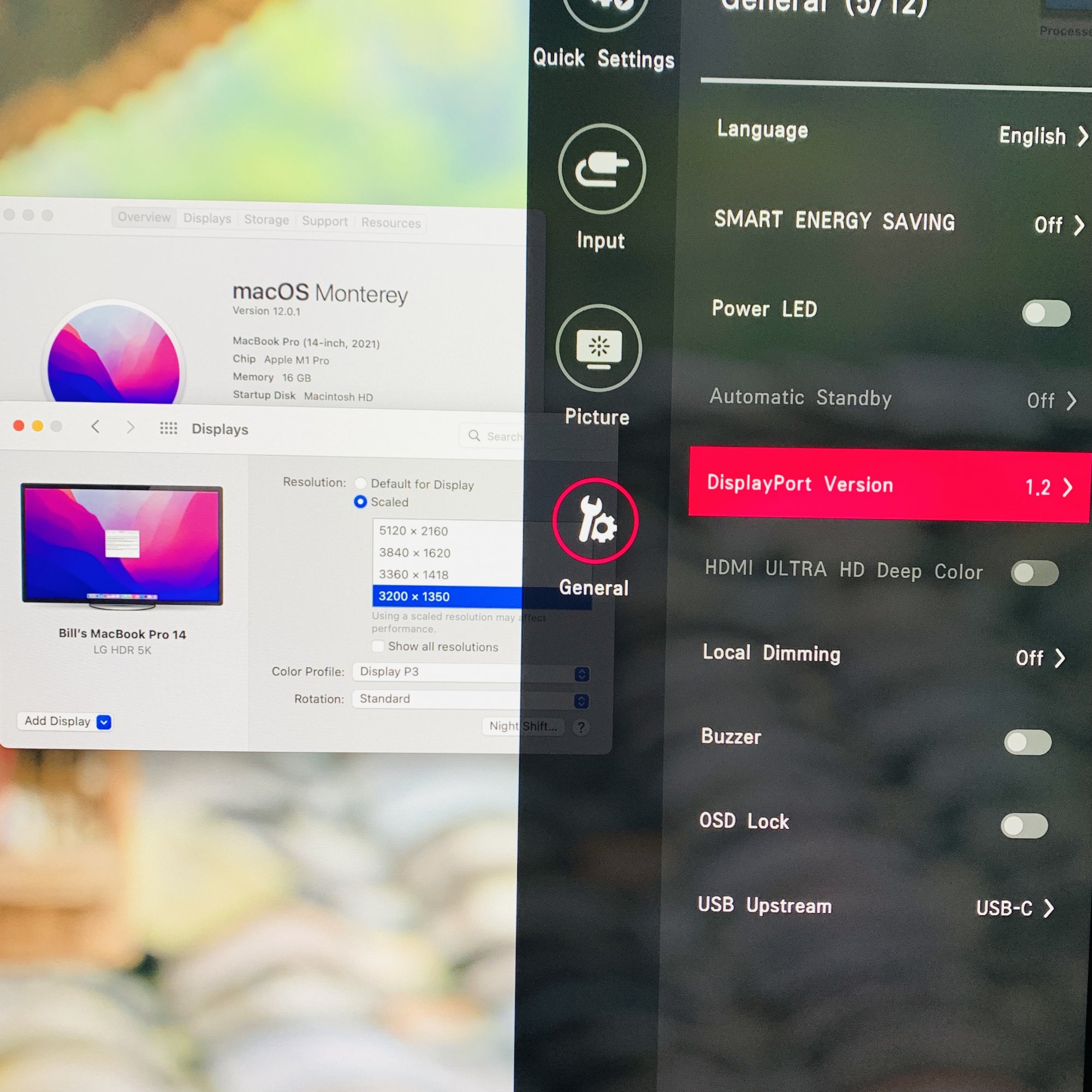

Set the monitor to use DisplayPort 1.2 instead of DisplayPort 1.4.
Tried it, but without any change
Oh, you're on M1 instead of M1 Pro, right? If that's the case, you may have to plug/unplug while in DisplayPort 1.2 occasionally.
If that doesn't work, while having the cable connected, switch to DisplayPort 1.4, then back to 1.2.

I did try this with a 16" with M1 Max as well. It should work.

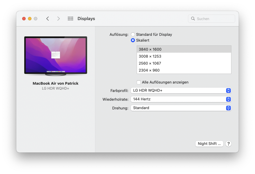

Hey guys!
Yesterday my new McBook Air M1 arrived - today the LG 38WN95C Ultrawide monitor .... I was already afraid that something was not running properly. BUT, I tell you, everything perfect, under macOS Monterey. Out of the box 3840x1600 @ 144 Hz!
I didn't have to adjust anything - I used the cable that came with the monitor. Super nice experience!
The fonts look sharp. Very comparable to my old Mac Thunderbolt display.

Hey Patrick,
that's the wrong thread. You talk about the 38WN95C which has only UWQHD resolution.
