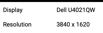

I’m just looking for more USB-C ports since that’s what I’ve switched to after having a Lg Ultrafine 5K with only USB C ports in my previous monitor.
However display use 3840x1620 correctly and is sharp!
Hope it may help you,
cheers!

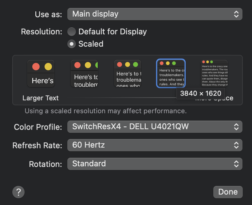

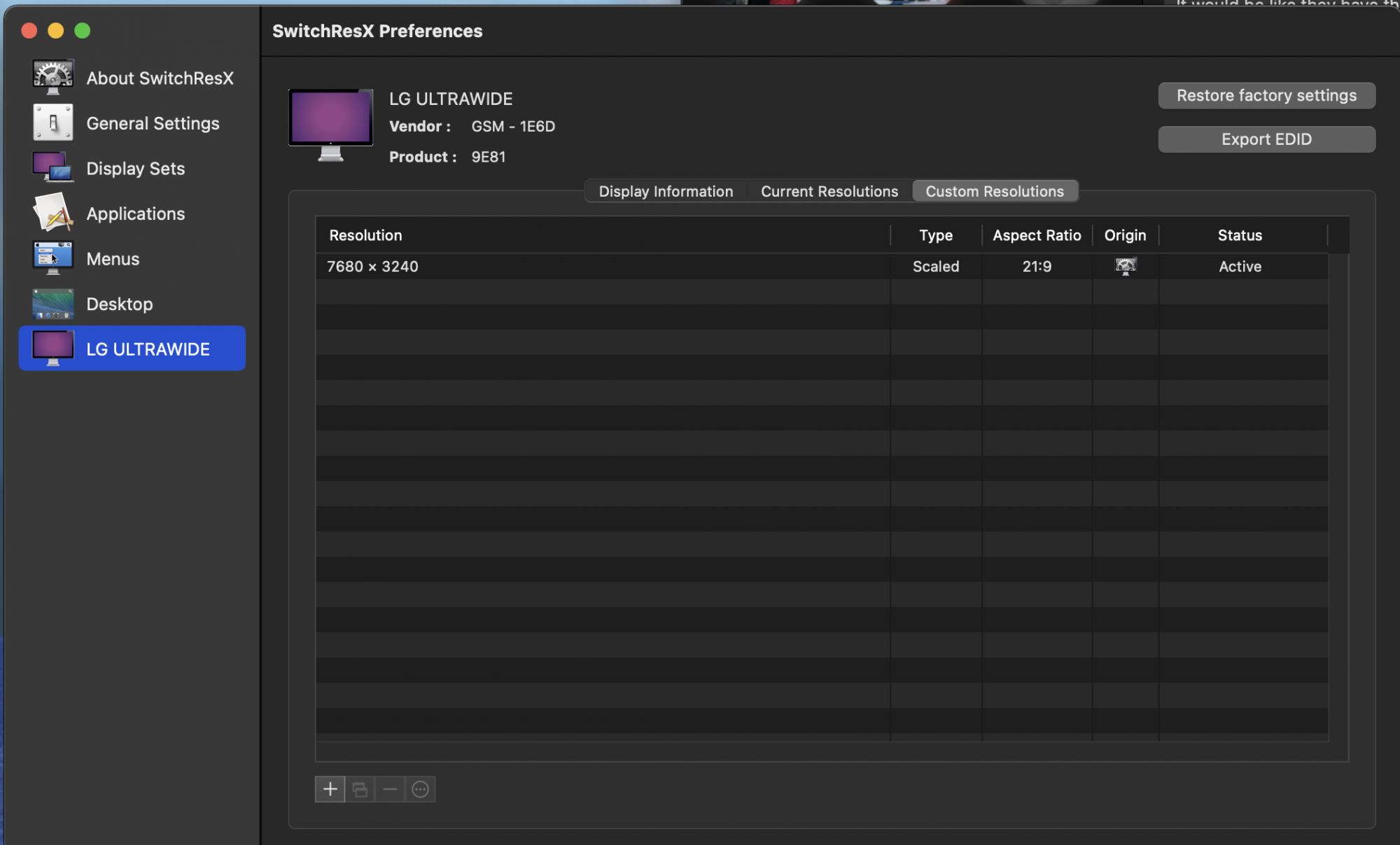

Just to let you know, I've just tried the SwitchResX method outlined on the previous page and IT WORKS on an M1 Max MacBook pro. Not sure why it might not work on a non-max one but deffo working for me. Phew! Thanks @Grimp
Using a Dell U4021QW Display, Monterey 12.2.1
I was able to install SwitchResX and add 7680x3240 to custom resolutions as per instructions in page 25, BUT I didn't need to disable SIP. It just works and the option is back <3
Display: Dell U4021QW

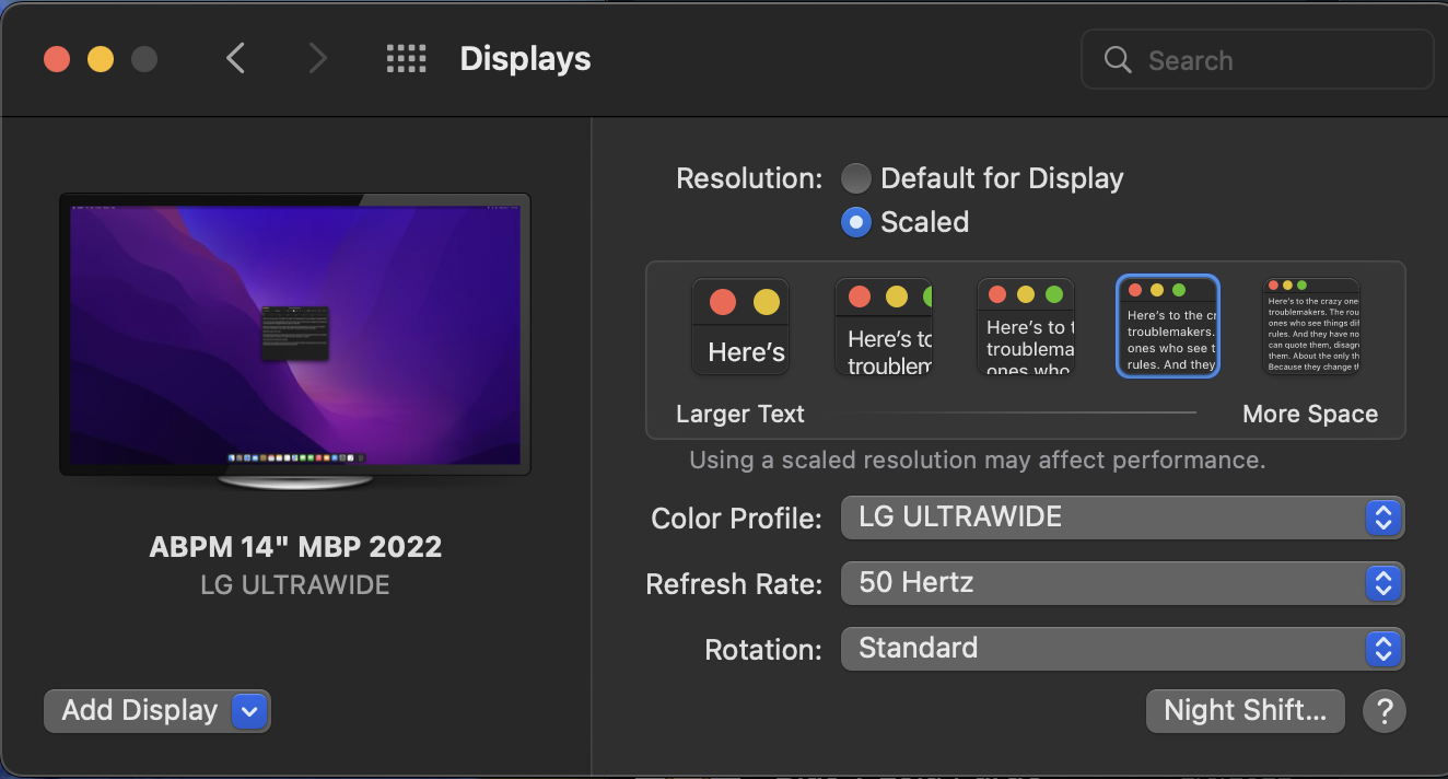

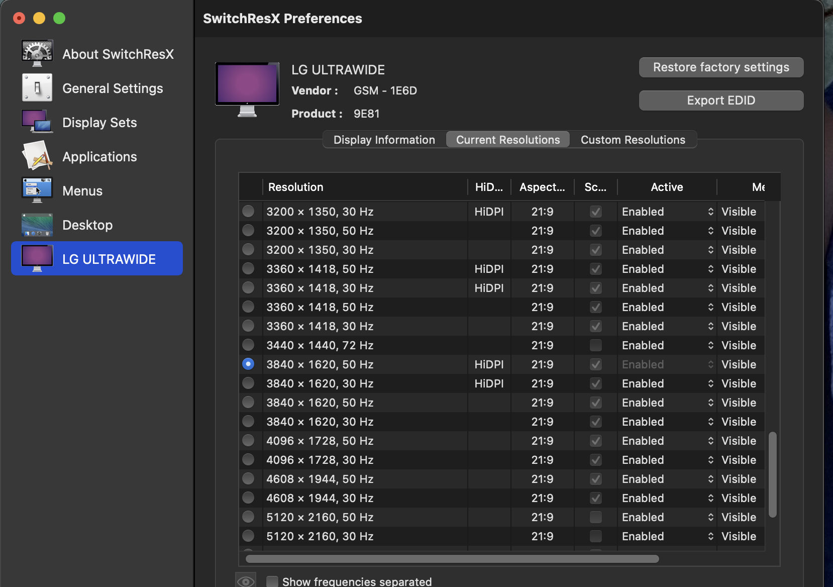

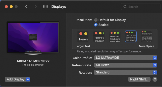

Ok - hoping for some help from you fine folks.
First, I just took delivery of the 40" version of this monitor, the LG 40WP95C-W. Came direct from LG. And it's 5k/2k, same AR, so I would *think* it should be a similar process.
Connected it to my MBP 14", Max(ed), 64GB. Connected directly via TB. In clamshell mode.
Because @rojharris was able to get it to "just work" without disabling SIP, I tried the same, and it worked. More or less.
First, I wanted to ask @Grimp where I can see that detail broken out as you have in the last image in your post I quoted? I can't seem to find that. It'd sure be helpful to confirm this info. ETS: sorry I found it in system report, and it does show Resolution as 7680x3240 and UI Looks like 3840x1620 @50Hz, so it's consistent with my 50Hz problem.
Next, I wanted to ask @sallar about the Colour Profile in your post...is that something custom you did, or did it appear as a choice? I ask because I have no such choice listed for any kind of SwitchResX.
Next, for anyone - in the actual monitor's settings, in Input, Aspect Ration...what do you use? I have it on Original but can't seem to tell if that's correct vs say Full Wide or Just Scan?
Finally, and most importantly, please see the images below. It appears I got it to work more or less, but the "more or less" part is that I only have 50Hz as the max option. No 60, no 72 (which this monitor is supposedly capable of. Is there a way to force that? The 50 isn't the end of the world, but I'd definitely appreciate higher. Anything else jump out at you based on what you see?

WHOOPS. Somehow the monitor itself had been set to DP1.2. Once I changed it to 1.4 the same resolutions but at 72Hz appeared for me in SwitchResX. Voila!
Edited to give some impressions of the 40"er.
Coming from a 5k iMac (the OG, late 2014 model) the text is definitely not as razor sharp, but I'd describe it as "very good" and definitely good enough for me to keep. The 3840x1620 72Hz HiDPI resolution (thanks SwitchResX) works really well and strikes a good balance between screen real estate and readability. Sound isn't as good as that on the 14" MBP funny enough, but fine. Laptop charges via the TB connection.
Not sure if I'll ever be able to go back to "normal" sized screen(s) after this. Even if Apple comes out with something like a 6 or 8k 32" consumer screen...not sure I'd trade the LG for such an animal at this point. The only thing I'd appreciate and trade for would be even greater pixel density but at this size...

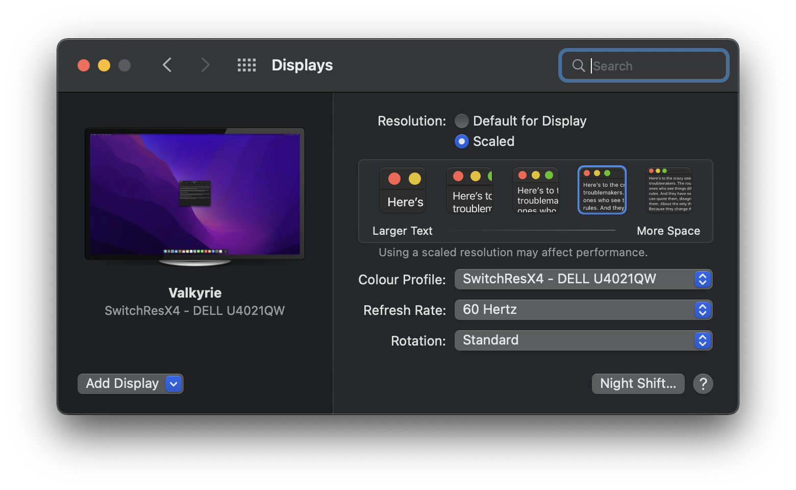

I am on a M1 Pro MBP, and I can confirm that the solution on page 25 worked for me. Thank you so much! It took a lot of searching online to even find this thread, but I just couldn't handle the situation anymore. I'm also using a Dell U4021QW, and the only options available were either ridiculously small or embarrassingly huge. 3840 x 1620 is just great!
Also, the 3840 x 1620 is actually showing up in my display preferences now. For those who have asked, I'm still on the trial version of SwitchResX. I'm assuming it will ask me to upgrade to a paid version in 10 days, but I'm going to run out the full 10 day trial to test that out and see what happens. At the end of the day, I'll be happy to pay for the app just to have this problem solved!

So I tried SwitchResX (paid version), below is a process:
1) ##Disabling System Integrity Protection (SIP)
If you are running OSX 10.11 or higher, SIP must be disabled. To disable SIP do the following:
  • Boot into the recovery partition by pressing CMD + R when starting up your Mac.
  • Once in recovery mode, open a terminal window.
  • Type the command csrutil disable
  • Reboot
2) Open SwitchResX, go to "Custom Resolutions", click "+" at bottom. Select "scaled resolution" from menu. All fields shall be empty, appart the last line where you put scale to : 7680 x 3240.
3) Hit OK, and close SwitchResX, it will prompt to save config, answer yes.
4) Reboot mac one again.
5) after reboot, open SwitchResX and check custom resolution tab for your screen, this shall look like:
6) Then navigate to SwitchResX, you shall finally see 3840x1620 as HiDPI available, select it.
7) Do not forget to check "Launch SwitchResX Daemon automatically after login" in SwitchResX's General Settings.
8) Reboot again into recovery partition to disable SIP (csrutil enable).
9) After reboot, external screen shall keep 3840x1620 HiDPI resolution.
10) Looking in OSX menu, I still cannot see 3840x1620 listed:
cheers!

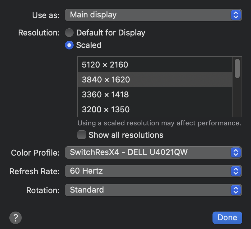

I used the SwitchResX trick on Page 25 (adding a custom resolution of "7680x3240", then rebooting, then macOS offers 3840x1620 as a HiDPI scaling mode).
This works great on my MacBook Pro 16" M1 Max with Dell U4021QW.
