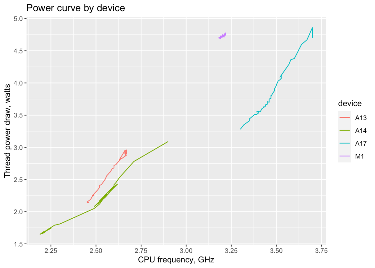

I picked up my iPhone pro today and ran a simple power and frequency test of my own making. The detailed data and description of methodology is here:
https://techboards.net/threads/thread-iphone-15-apple-watch-9-event.4299/post-146389
What might be most relevant for this thread is the following graph.
My experiments confirm Geekerwan report of A17 Pro using substantially more power for demanding workloads. But I think that people have been focusing to much on this instead of considering what this means for the Mac.
Apples 3N chip is not an efficiency powerhouse like some of us have hoped. At peak performance, its efficiency is comparable to A14/A15. But I think what we see here is Apple moving away from super efficient CPUs to super fast efficient ones. This is the first desktop-oriented design from Apple. A Mac based in this chip will probably consume around 8-10 watts per core at peak clock, but its performance will be state of the art enthusiast desktop. And while it might seem suboptimal for a phone, it can still outperform an A16 at lower power consumption, which is more than sufficient and faster than the closest competition.
And speaking of efficiency, A17 is not that bad either. It uses 30% power than M1 at the same performance level and is around 20% faster at the same power level. I think that’s fairly respectable.

Can you elaborate on this? Reading that was a bit of a surprise to me.
If you look at it closely, M1 is a slightly overclocked and horizontally scaled mobile phone chip. M2 doesn’t change much about it. Neither of these CPUs are able to take advantage of the thermal headroom of a modern desktop. I mean, Firestorm tops out at 5 watts. Even for a 14” laptop this is very low. Apple is just leaving performance on the table. It works reasonably well for their laptops thanks to their insane perf/watt, but they have no chance to compete on the desktop.
A17 instead appears to target a different segment in the power curve. I am quite certain it can go above 5 watts (in fact, it wouldn’t make any sense otherwise, because a Mac CPU will surely be faster than a phone, right)? So Apple seems to be going after that unused desktop thermal headroom. They use the new process not to slightly improve the performance at the same segment of the power curve but instead push beyond it, while retaining very good efficiency. It doesn’t make any sense for a phone. It makes all the sense in the world for a desktop computer.
As to performance estimates, well, that one is fairly straightforward I think. Geekerwan shows some SPaeC scores for A17, it is trading blows with Intels 5.8Ghz 12900K (that needs around 25-30 watts to get to this level of performance btw, so 7-8x more). I think M3 will reach around 4.2Ghz, some versions maybe slightly higher.

I get the same numbers for single score stress test using my own code, plus the testing framework produces the same results as powermetrics on the Mac, so I’m inclined to believe the results. Still don’t understand their MC results (will try to do a similar test this weekend).
So let’s assume that their numbers are correct. What conclusion do you draw from that? You already know mine.

I already said, multiple times. Apple is no longer eeking out every last bit of what physical design is giving them, and have to resort to increasing clock frequencies, while also increasing power draw.
A17 uses 30% less power for the same frequency as A14 in my tests. What kind of improvement did you expect from 3N? Halving the power?

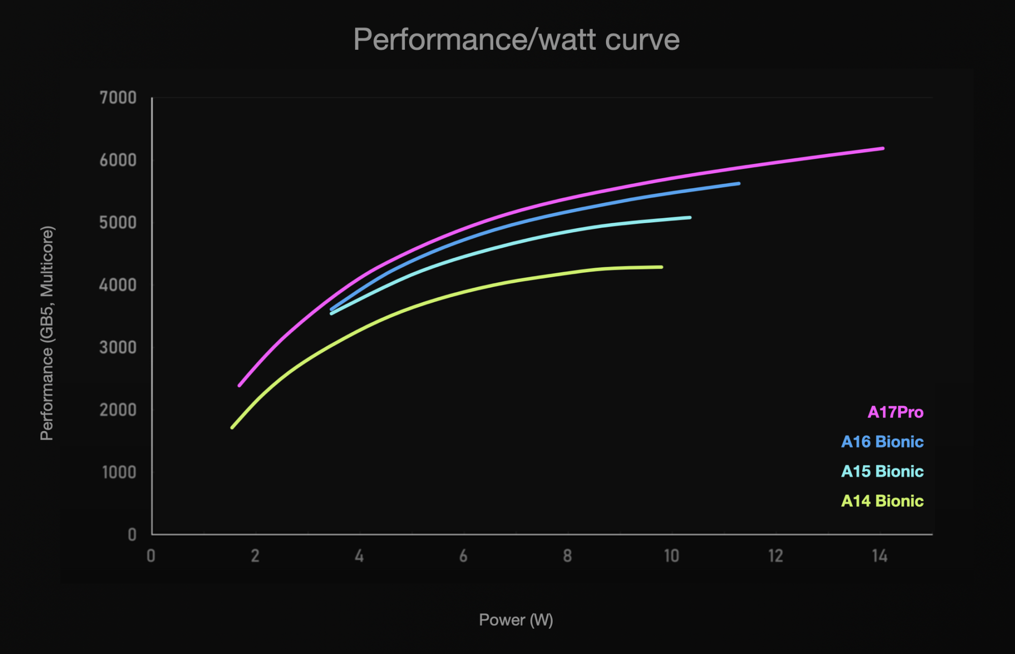

While we debate endlessly about the future chips that may or may not bring three digit IPC increases, I took the liberty to interpolate the actual data from actual chips Geekerwan measured. Mind you: the interpolated curve goes through all the experimental points Geekerwan measured, it's not a loose fit. So while obviously the values in between are not accurate to the mW the qualitative shape of the actual performance curves can't look too different from this because this is how all performance curves look.
So for A14 Bionic, A15 Bionic, A16 Bionic and A17 Pro:

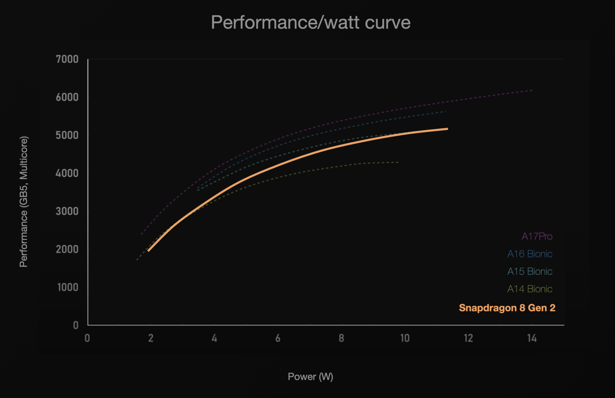

And if we add the Snapdragon 8 Gen 2, the only other chip on Geekerwan's measurements:
So the multicore performance curve of the Snapdragon 8 Gen 2 (2022, N4P) fits squarely between the A14 (2020, N5) and the A15 (2021, N5P).

I don’t see it as prioritizing the Mac over the iPhone, but rather as making Apple Silicon better suitable to the needs of the Apple ecosystem.
Making a more performant CPU - even if it draws more power - does not harm the iPhone in the slightest. One just doesn’t run a phone at peak performance all the time, and there are many ways to compensate the higher peak power usage. Again, the A17 uses less energy for the same performance as its predecessors. But having more performance will definitely help in addressing some of the performance criticisms of Apple Silicon on the desktop.
How do you come to this conclusion? For me it just means that the A17 consumes more energy to achieve the yearly performance delta (not ratio) that Apple has been targeting since the A11 or so. The curves shown by @Andropov make it very clear.
This doesn't bode well for the Mac. There is less headroom to increase clock speed.
