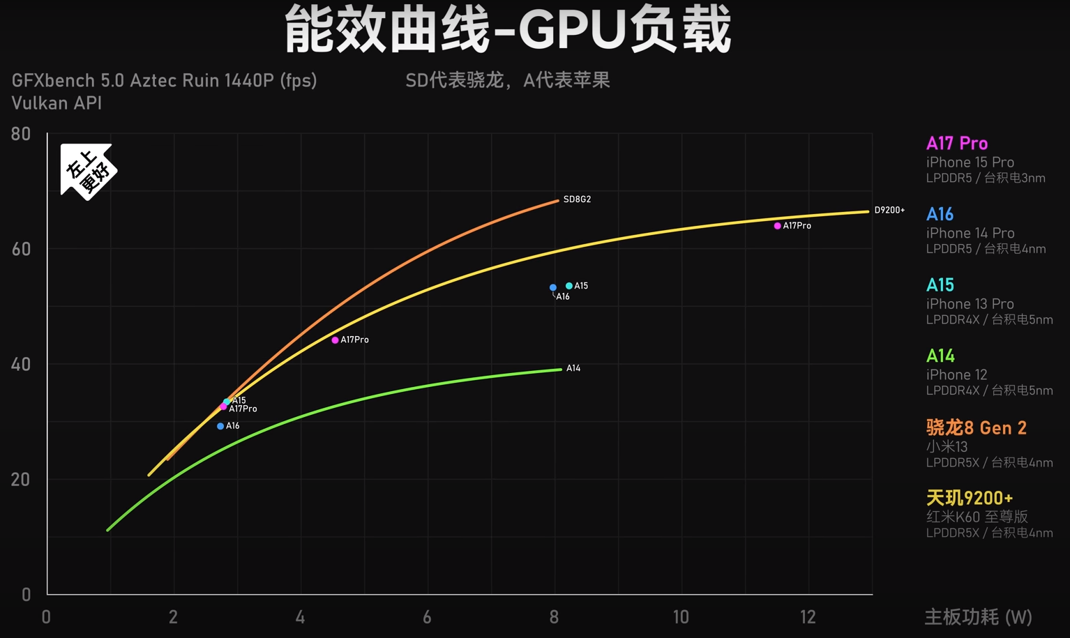

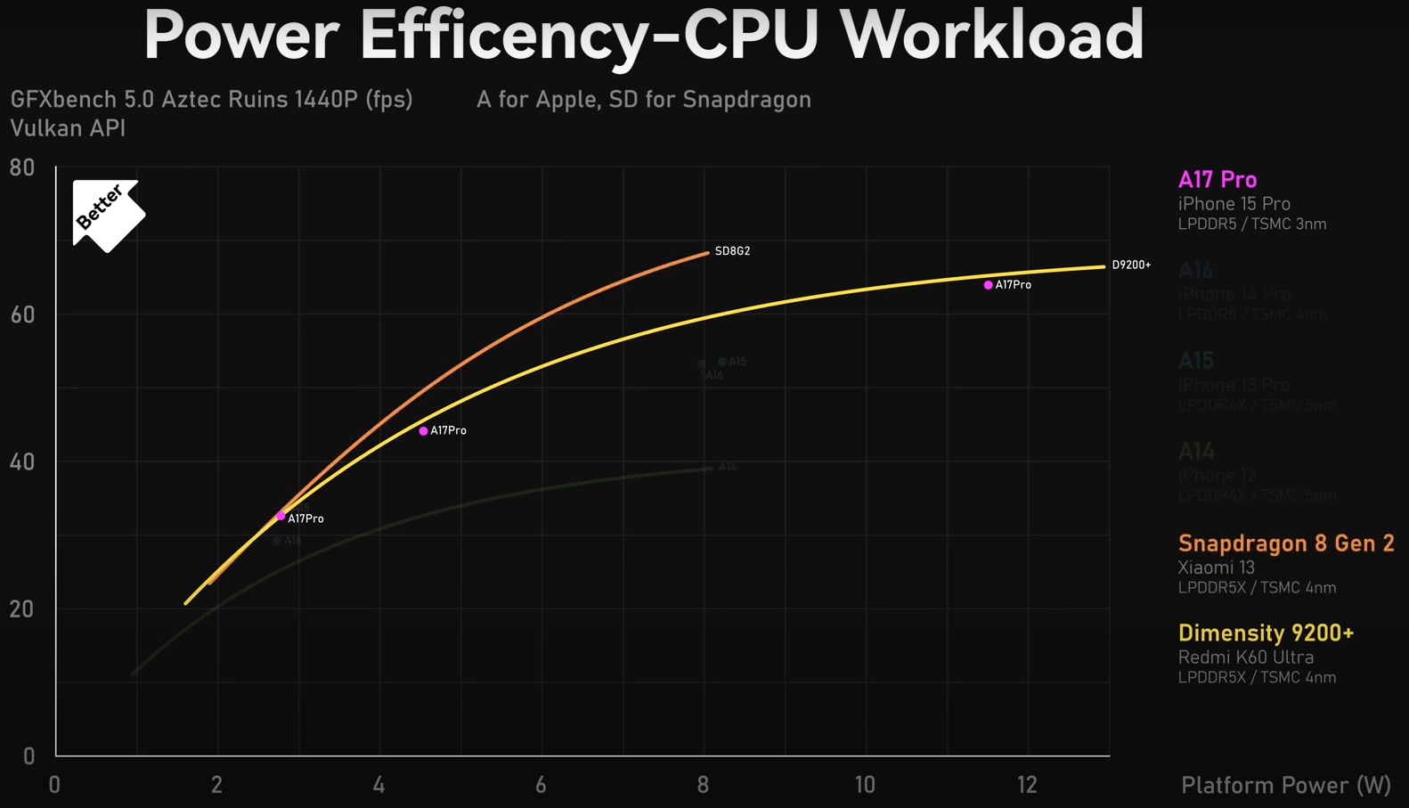

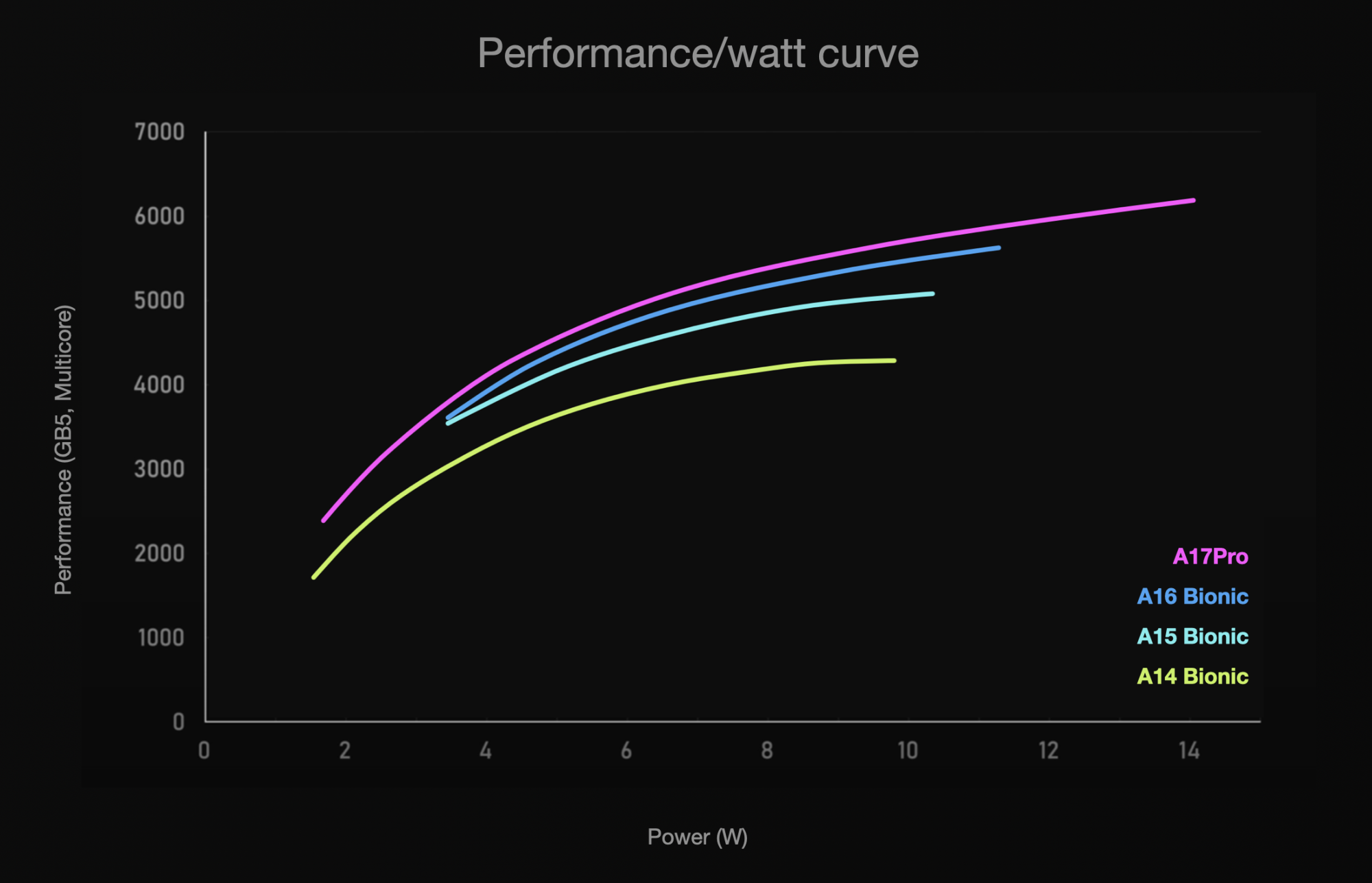

While we debate endlessly about the future chips that may or may not bring three digit IPC increases, I took the liberty to interpolate the actual data from actual chips Geekerwan measured. Mind you: the interpolated curve goes through all the experimental points Geekerwan measured, it's not a loose fit. So while obviously the values in between are not accurate to the mW the qualitative shape of the actual performance curves can't look too different from this because this is how all performance curves look.
So for A14 Bionic, A15 Bionic, A16 Bionic and A17 Pro:
And if we add the Snapdragon 8 Gen 2, the only other chip on Geekerwan's measurements:
Impressive range of the A17 Pro. Very useful in mobile devices with limited battery size. I wonder what will sit in the next iPad Pro: A17 Pro or a A17 Max with more GPU or an M3?

How do you come to this conclusion? For me it just means that the A17 consumes more energy to achieve the yearly performance delta (not ratio) that Apple has been targeting since the A11 or so.
Well, there are two interpretations I think. First one is that Apple was simply unable to improve the efficiency further and was forced to increase the power consumption to meet the performance goals. The other one is that Apple decided to abandon the 5W per core limit in order to push the performance further, but this meant giving up some of the efficiency potential. Both interpretations have their merit and I don't think the data prefers one over the other.
The big question is what segment of the power curve are we observing on the A17, and what are this curve's overall characteristics? For example, if you look at the graph I have posted, there is a big jump in power consumption between A14 and M1 (which use the same CPU core) for a modest frequency increase. This suggests that the A14 is clocked just below the segment where curve acceleration increases dramatically. Is this also the case for A17? We simply don't know. A17 power curve slope is steeper, which kind of suggests that we are already in that "exponential" range (A17 has the same dynamic power range but half the frequency range as A14). But at the same time it still looks rather linear all the way through (observe that with A14 the acceleration starts at around 2.5Ghz, while with A17 it's pretty much constant). And this observation leaves room for speculation that the A17 curve will extend some more to the right without hitting severe diminishing effects (speculation that I am eagerly jumping on). But of course, we don't know where the curve ends or where the acceleration really kicks in. I think it's not unreasonable to expect around 4.1 Ghz at ~ 8 watts or 4.3Ghz at ~ 10-12 watts, but that depends on whether A17 design has wider power range than the power-constricted A14.
The curves shown by @Andropov make it very clear.
I am reluctant to interpret multicore performance curves, because there are a lot of confounding factors (e.g. P/E core interaction). I think single-core makes for a simpler discussion.
This doesn't bode well for the Mac. There is less headroom to increase clock speed.
Macs have more thermal headroom, which is the entire basis for my argument. I'd rather have a 4.2 Ghz chip at 10 watt per core in my Mac than a 3.7 Ghz chip at 5 watts.

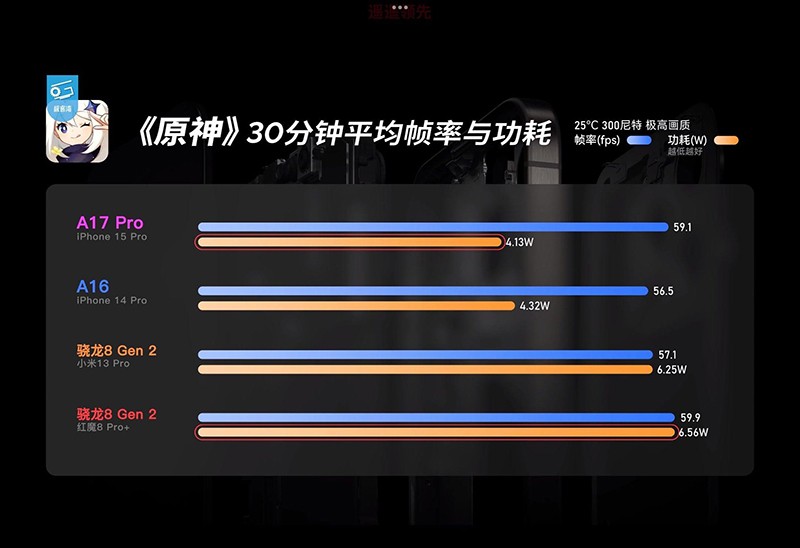

Apple's CPU is in another league, but its GPU is worse than the competition.

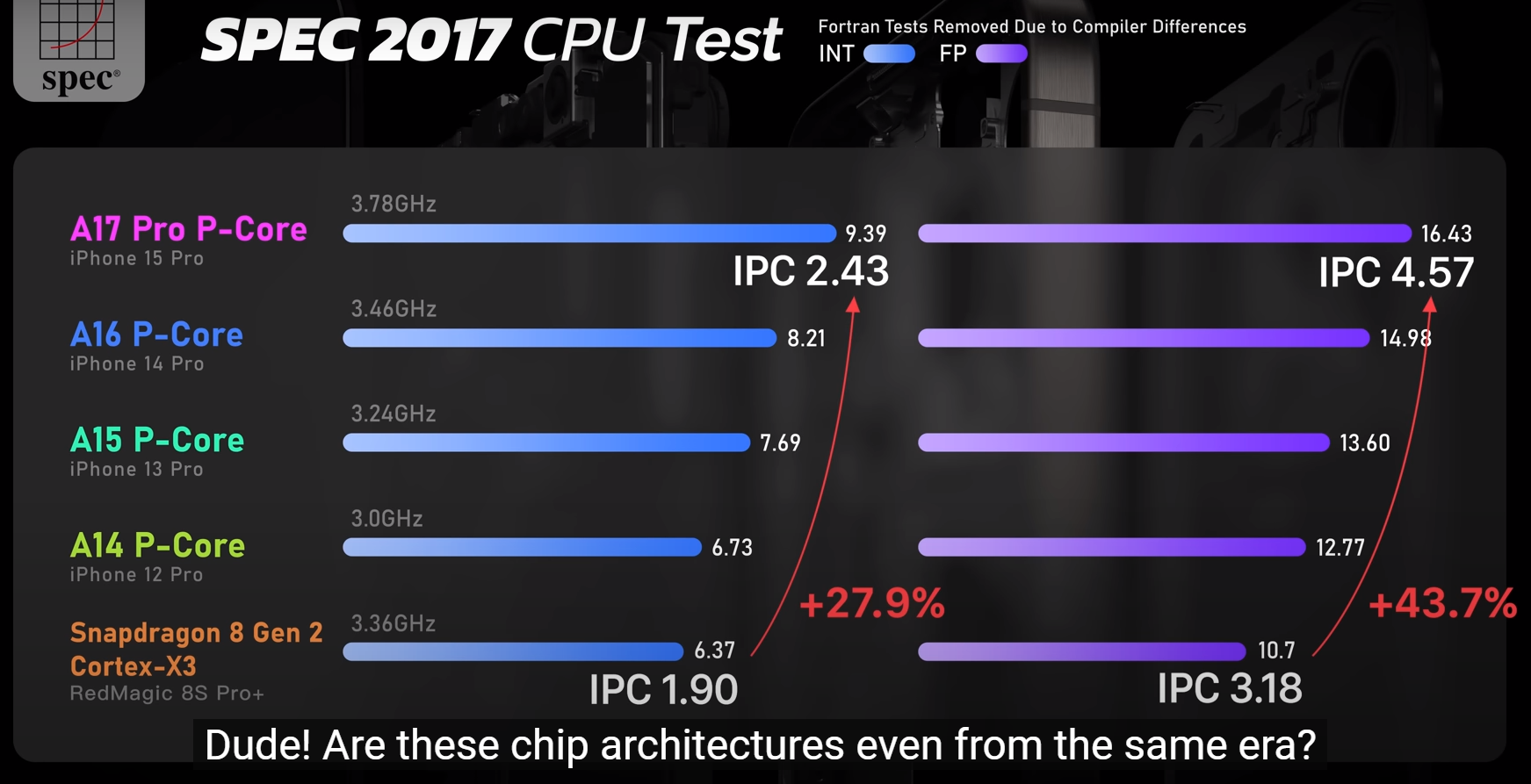

What impresses me most is the floating point performance advantage that Apple's CPU has over the competition. I wonder if the compiler can have a big influence on the results.
SPEC CPU 2017 focuses on compute intensive performance, which means these benchmarks emphasize the performance of:
  • Processor - The CPU chip(s).
  • Memory - The memory hierarchy, including caches and main memory.
  • Compilers - C, C++, and Fortran compilers, including optimizers.
SPEC CPU 2017 intentionally depends on all three of the above - not just the processor.
How can we test this in a non-benchmark app to see if the gpu is worse ? I know people like to do a comparison in a demanding app and a lot of users are using games as a reference. I wonder if we can test this A17 with and top gpu android phone on the same game to see the different fps or something
Can we do that, or ask for that?

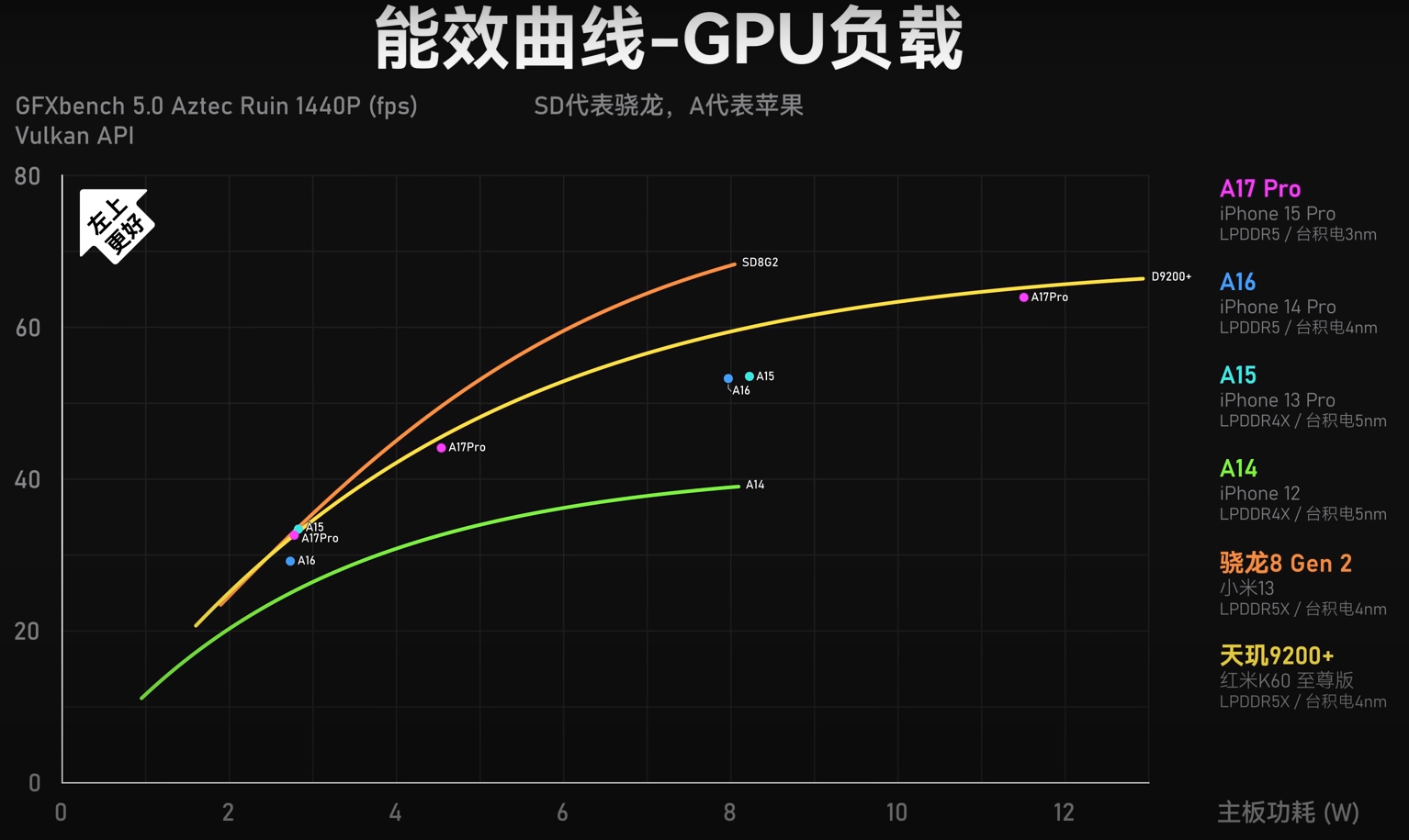

Adreno GPU totally sucks at GPGPU. Like 3X slower than the A7 or something. It may be faster in GFXBench, but not in general
Why does a phone GPU have to be good for GPGPU? It seems that Apple trying to make an SoC that will work for both a phone and a laptop may prevent them from getting the best performance in both situations. I expect Apple will end up splitting the development of the cores, one for phones and one for laptops.
I suspect the A16 Bionic and A15 Bionic curves can extend further to the left too, but we don't have those data points.

graphic @Xiao_Xi cited clearly says “Vulcan API” on the “CPU Workload” benchmark
They made a mistake with the title. The graphic in Chinese clearly says GPU.

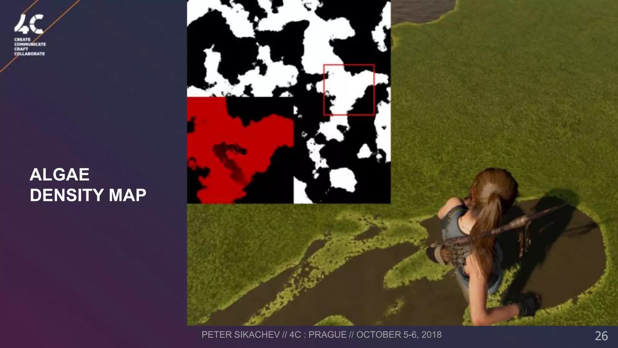

Another example I just remembered. In Shadow of the Tomb Raider, there's a fluid dynamics simulation running when there's water visible on the game, to model the character's interaction with floating substances (algae, oil...) on top of the water (the developers have a full video on this topic):
This is run as a series of compute shaders, and the developers said that the effect adds ~0.5ms of a frame on an Xbox One (for reference, to reach 60fps, the total frame time must be under 16.6ms).
As far as I know, the way it usually works when developing a game (at least for consoles) is that certain visual effects are given a frame time budget. In order to cram that effect into the game, it must add less than X milliseconds to the total frame time. For PC games, which must support a wide range of GPUs, I believe non-essential visual effects can be toggled off based on settings.
On mobile phones, the game is likely to be tested in several different phones of different price ranges. If the GPU's compute sucks in all of them, it's not unreasonable to think that non-essential VFXs that are heavily dependent on compute are likely to be dropped altogether.
For AAA games, where there are R&D departments trying to maximize every bit of power of the GPU, you're way more likely to find exotic algorithms and implementations that depend in the GPU supporting specific characteristics. So it could be that, in order to support AAA games (and Apple just announced a bunch on the iPhone 15 keynote), the GPU needs to have extensive feature support *on top of* being fast.
Reactions: souko and Xiao_Xi

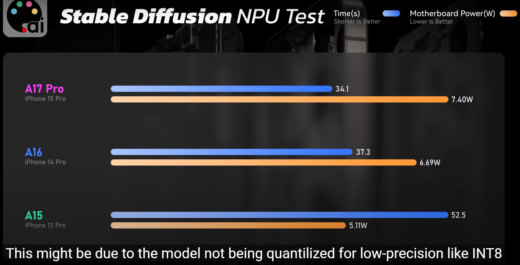

I hope they can get help next time and make a better benchmark for the NPU.

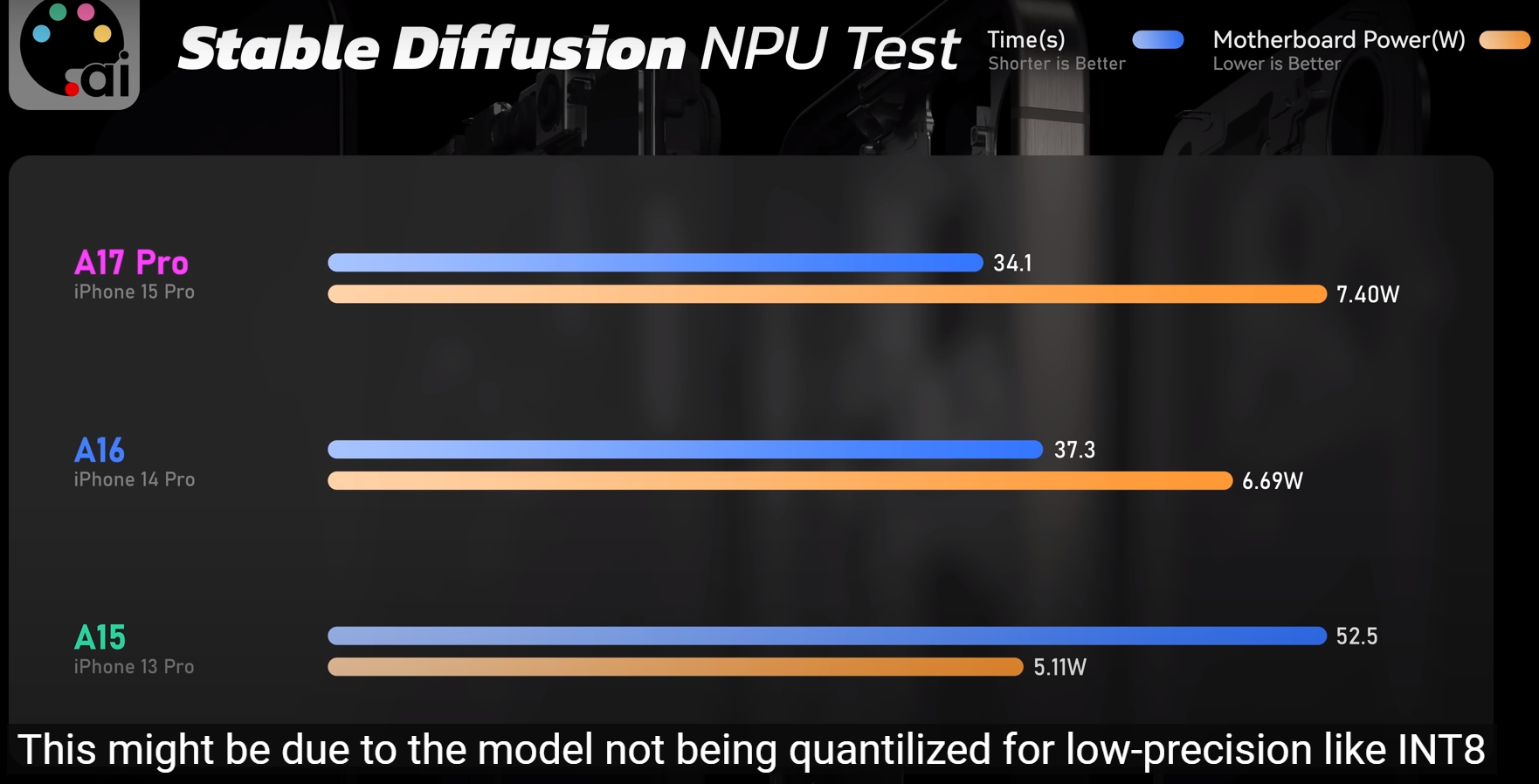

NPU is as useful as apple allows it, working with ANE for past 2 years I found that its only useful in the cases that you are limiting yourself to only small inputs and smallish model sizes (in which case weight compression can lose ton of accuracy) or heavy compressed weights on bigger models (which also lose quality).
I hope they do some bigger update in this generation cause TFLOPS even on M1 series are extremely hard to utilise (limiting factor is memory transfer speed and "cache") so if they just double the FLOPS without proper memory speed increase it shouldn't change much for 99% use cases.
Even Apple blog-post about NPU they are barely able to utilise hardware with fixed smaller size inputs with heavy optimisation and weight compression (with ofc. loss of quality) and possible with some low-level internal framework level optimisation.
Also I'm not sure how much NPU utilisation is even in this Stable Diffusion test as wattage for A15 seems to be bigger than NPU wattage I ever hit in my Mac ultra (tops about 3.0-3.2W on Apple provided stable diffusion), its most likely just higher GPU/CPU clocks or on chip memory that change the time slightly [maybe allowing for faster data fetching and using extra few W from NPU? would love to get my hands on this test after M3 comes out].
