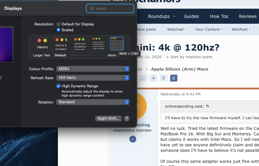

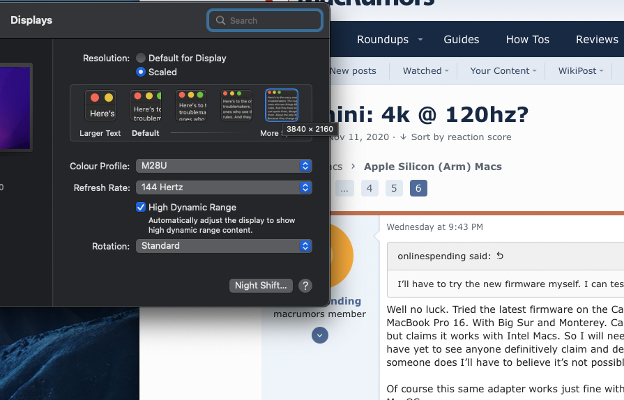

dumb question, but...
currently using USB-C -> USB-C to connect M1 mini to a 4K 144Hz Gigabyte M28U monitor.
If i use HDMI (monitor supports HDMI 2.1), can i run 4K @ 120Hz without issues?
I'm willing to "sacrifice" 24Hz for freeing up a USB-C slot at the back of Mini...
I actually have the same monitor! What cable are you using? Any problems with running 4K@144HZ with HDR?

Remember the HDMI out on the M1 Mini is only HDMI 2.0, so maximum is 4K/60fps using HDMI.

no problems, i use usb-c to usb-c
i can use "default for display 1080 hidpi" with 144hz and HDR. Actually i crank it up a little notch to 2048x1152 looks as good as retina, can't see a difference to 1080 hidpi
Got it. 4K 144Hz HDR scaling it down to 1080p? Sounds good. Would you mind sharing what cable you are using? Many thanks.

some generic 10gbps / 100W cable, no name.
let me know if your mini has troubles waking the monitor as well sometimes :)
make that 4K, HDR & 144Hz :p
