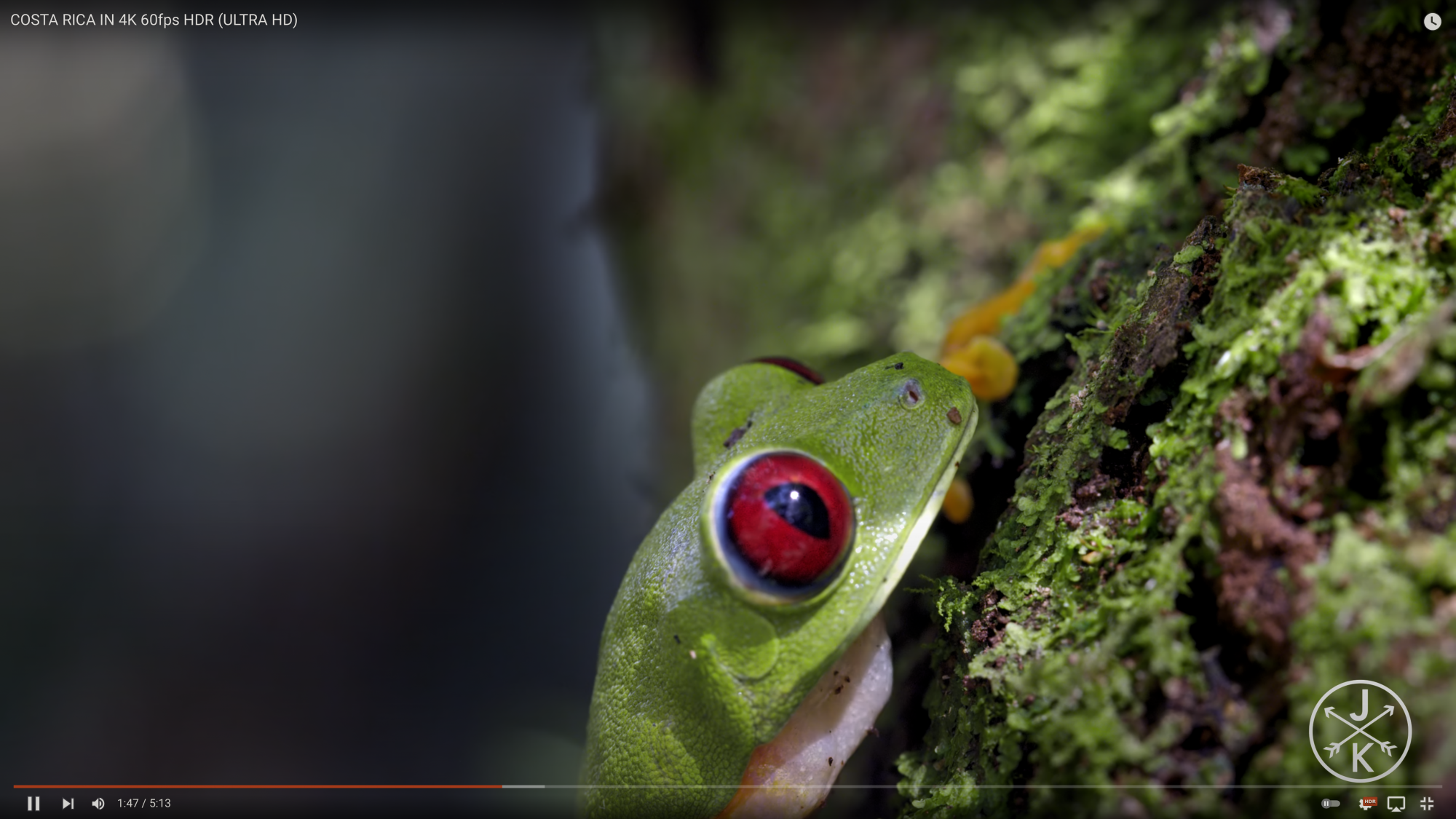

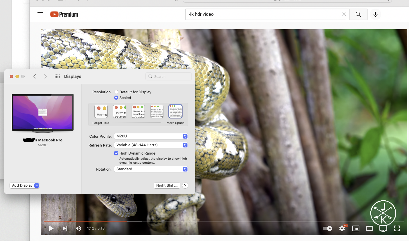

Hi guys, so after receiving my new MBP, I can do VRR @ 4K and HDR video seems to work on YouTube in Safari!

what the hell, i just received a new option in refresh rates that previously wasn't there: "variable refresh 48-144Hz" ?!
Before i had only fixed values. (Mini M1)
What's up with that?
M1 Macs get variable refresh rate (Adaptive Sync, AMD FreeSync, not sure about GSync displays). I haven't seen it work on Intel Macs yet. I think I have a display that supports VRR (Acer XV273K) but my Mac mini 2018 with Radeon Pro W5700 doesn't show a VRR option. Maybe I need a different GPU or VRR isn't support on Intel Macs.
