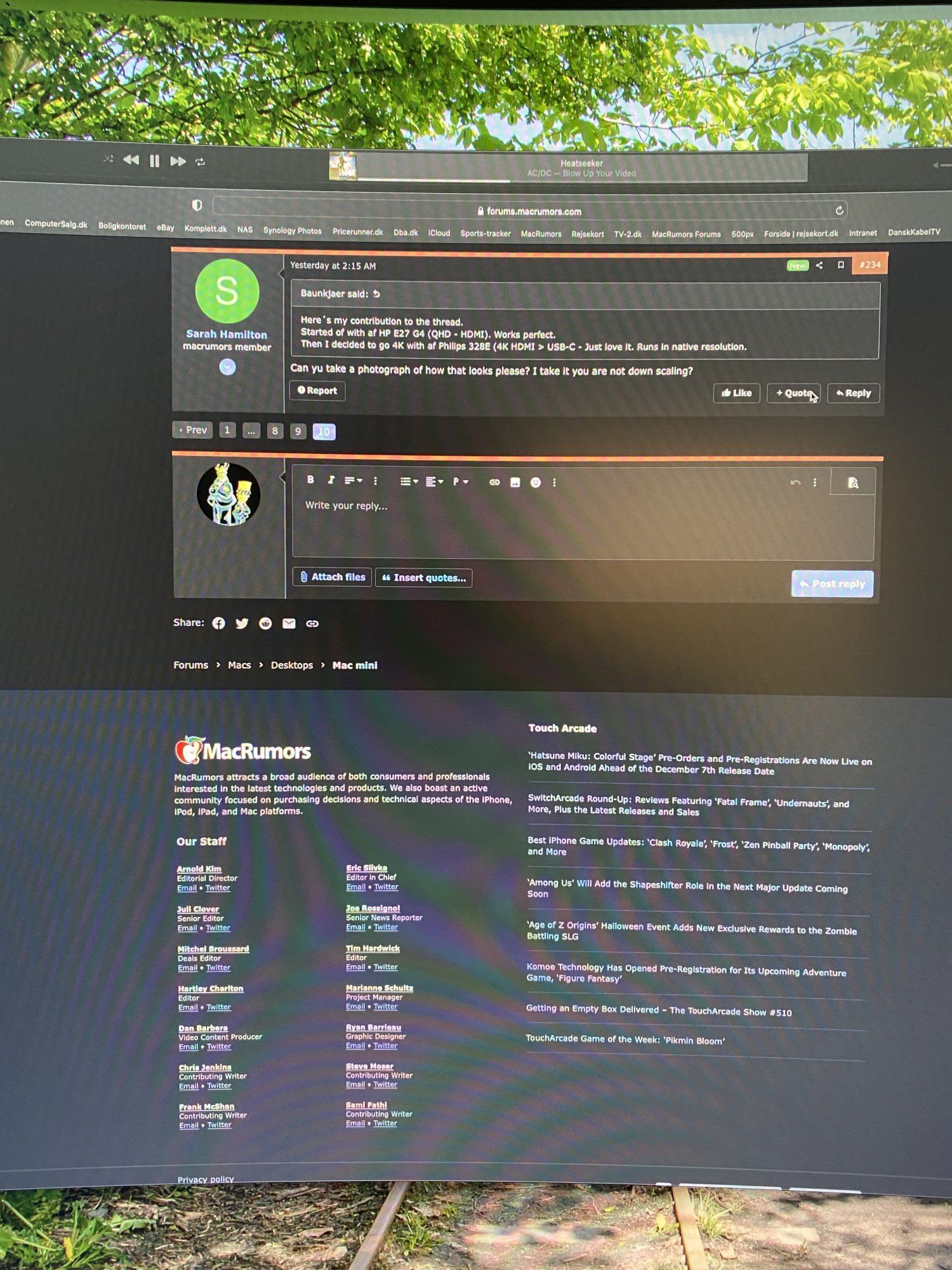

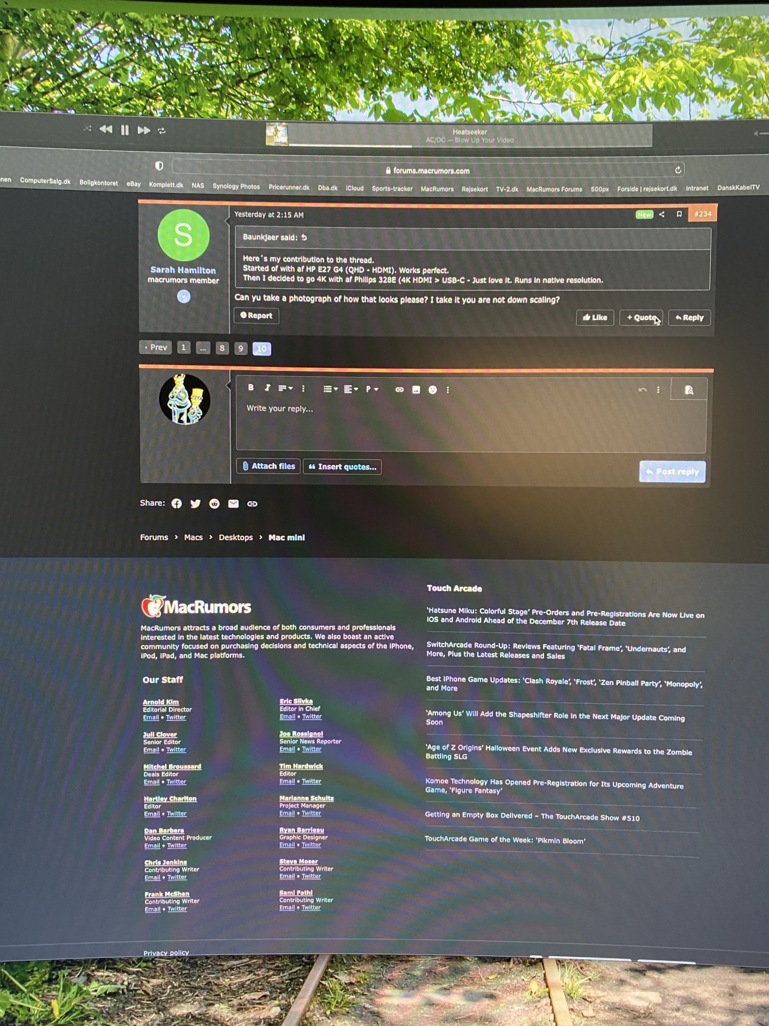

Here´s my contribution to the thread.
Started of with af HP E27 G4 (QHD - HDMI). Works perfect.
Then I decided to go 4K with af Philips 328E (4K HDMI > USB-C - Just love it. Runs in native resolution.
Can yu take a photograph of how that looks please? I take it you are not down scaling?
As you wish...

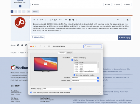

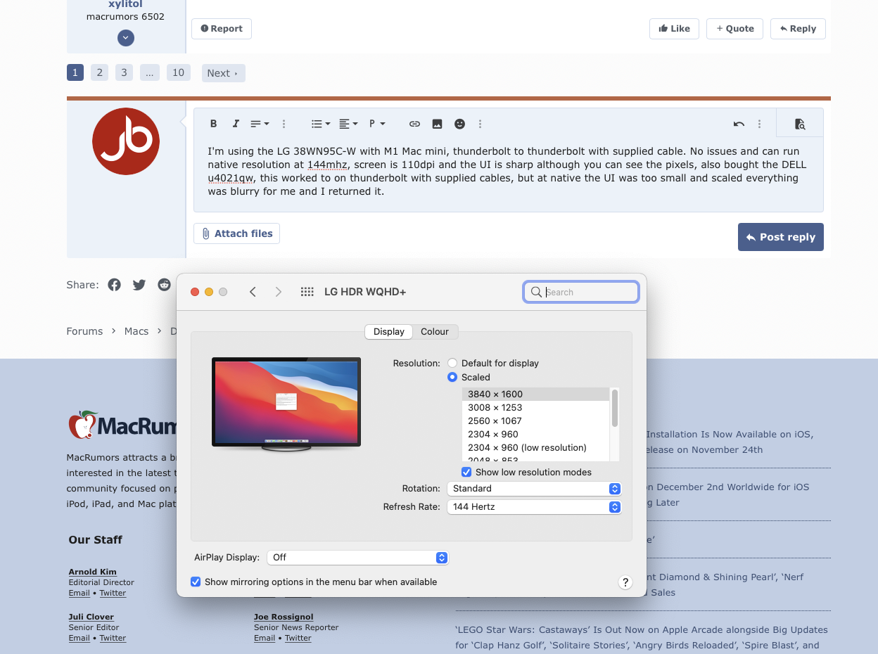

I'm using the LG 38WN95C-W with M1 Mac mini, thunderbolt to thunderbolt with supplied cable. No issues and can run native resolution at 144mhz, screen is 110dpi and the UI is sharp although you can see the pixels, also bought the DELL u4021qw, this worked to on thunderbolt with supplied cables, but at native the UI was too small and scaled everything was blurry for me and I returned it.
