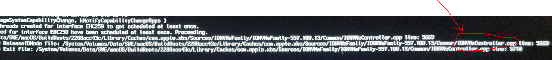

Something with Nvram was bugging out so can’t be too sure but the IOnvmefamily was updated again.
11.4 works after a few reboots, everything is still supported

11.4 does boot, try booting a few times in a row. Sometimes doesn't panic just hangs after NVME failed and sometimes boots to desktop.
What you are describing is the same behavior as before. Very few times it boots (1 out of 5-10 attempts), more often it hangs, sometimes it panics.

There is an issue in OCLP about this:
It is not related to OC. I have also tried directly without OC and trough RP only.
Just tested 11.4 beta1. Same kernel panic at the same spot as here:
Reactions: VitaminK and cdf
Forgot that. I suppose that eliminates the OCLP angle.
So, any ideas why the issue seems to be largely 4,1/5,1 specific?
Strange that all sorts of laptops and the cMP3,1 seem to be ok. Suppose the laptops not having PCIe slots is a factor.

Delay does not help. Trim timeout was set to -1 (maximum). I can't even install 11.4. The panic occurs much later than exbs event.
