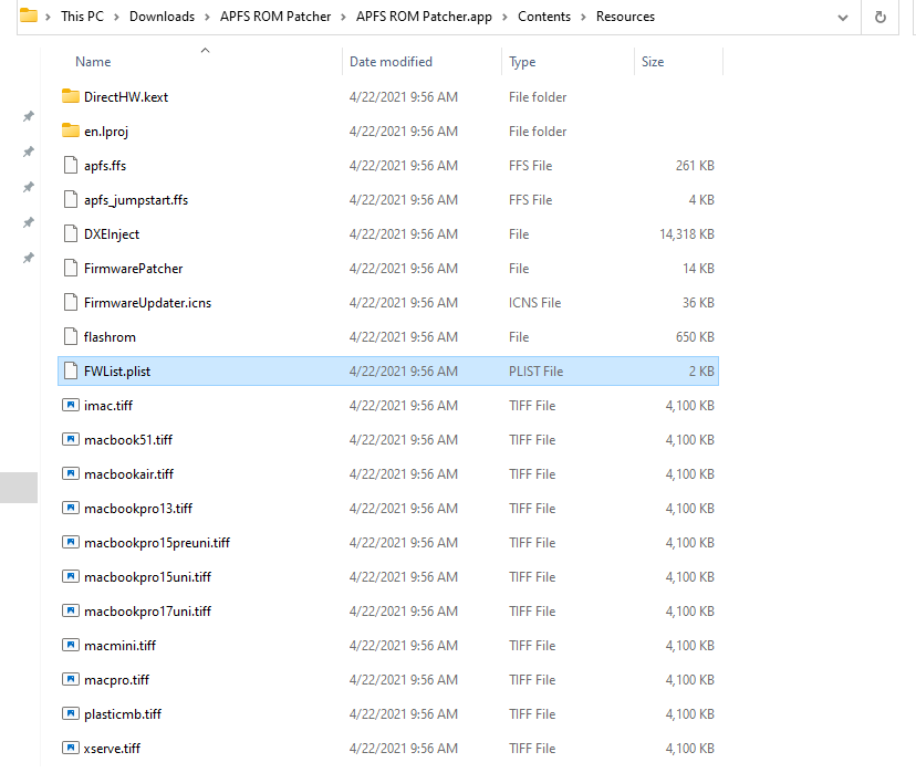

I see in the patcher 2 APFS modules:
What's in there? Actually never tried the Catalina patcher. Assumed it was the same as the Mojave one in this respect.
EDIT: I see we mean the APFS Firmware Patcher which is not just a shell script. Need to see what the Plist file contains (Seems to just be mapping files to models ...looks like something for the tool to know which file to use for which model)
You said you ran it:
