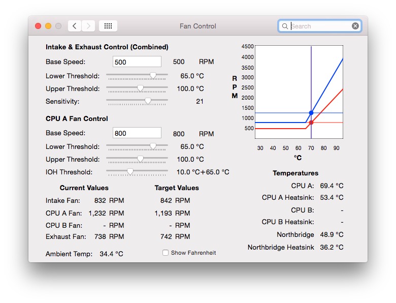

This new version works very well.
And I found that the CPU fan speed is still base on the CPU temperature, but the intake / exhaust fan speed is now base on the heatsink temperature.
Anyway, is there anyone can make another version that both fan speed base on the heatsink temperature? I prefer this is because it will allow me to run the CPU at a little bit higher temperature but little bit lower fan speed (and quieter).

I updated the Fan Control a little because I'm a big fan of it myself.
changes:
1. 64bit
2. Refactored some deprecated code.
3. Added Ambient Temperature
4. Updated the project to use the modern stuff (LLVM)
Denis, million thanks for this update and allow me to use your source code. I can now tailor made the fan profile to exactly what I want. Make my Mac Pro now even quieter than stock fan setting (rely on the booster more in order to allow for reducing the noisy intake fan RPM), but also few degrees cooler than stock under max loading (78C vs 85C) :D

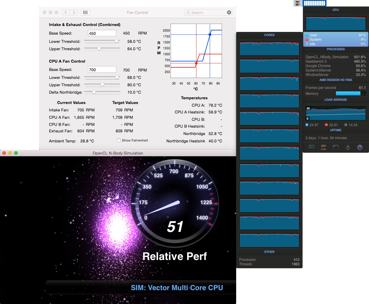

Just in case anyone interested in it. This is the V2.0b8.
View attachment FanControl64bit_V2.0b8.zip
changes:
1. The minimum fan speed is now for the Exhaust fan, and the Intake fan is always 100RPM more than Exhaust fan to avoid possible beat frequency.
2. Introduced "Delta Northbridge" to allow the booster auto spin up also base on Northbridge temperature (Lower Threshold + Delta Northbridge"). e.g. In my setting, the booster will spin up either CPU core reach 68C or Northbridge reach 78C (68+10).
3. Intake Fan speed limited to 1100, Exhaust Fan speed limited to 1000, and Booster speed limited to 2000 to reduce noise.
4. Slider scale was modified.
5. Fans spin up 3 times faster than V2.0b7 to compensate for the relatively low target RPM and possible high Lower Threshold.
P.S. This build is not intended to replace the V2.0b7, but basically another version for those who prefer the CPU run just few degrees cooler and less noise.

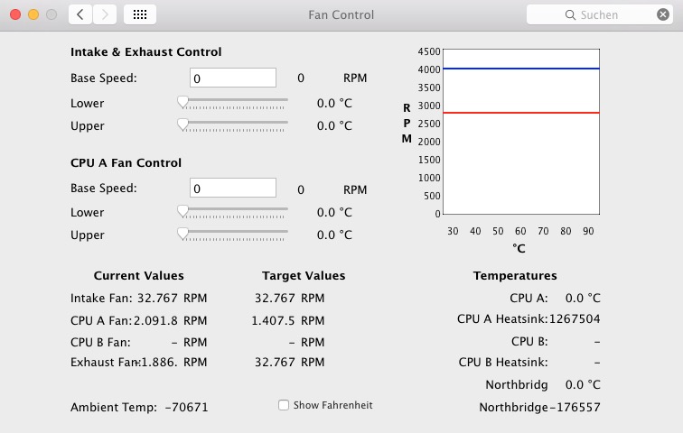

Hi. I am always getting completely weird numbers which make no sense (negative temperatures or 4-5 digit rpm numbers). What have I done wrong?
I have a Mac Pro Quad 4.1, flashed to 5.1...
Thanks, Ron

Works, thanks so much!! Finally the humming noise disappeared :) :)
Just a final question: The PCIe and PSU fans are not affected by this software, right? They are still (automatically) controlled by the OS?
Ron
Correct, PCIe and PSU fan is fully automatically controlled by the system.
