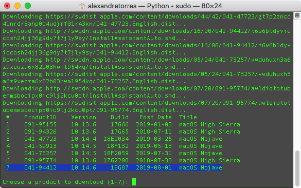

Use installinstallmacos.py, it's this one:
041-94412 10.14.6 18G87 2019-08-01 macOS Mojave

Today's reissued 10.14.6 has build number 18G103 and a new full MAS installer, worth checking the new build for anyone having KPs.
All these updates released today:
061-21530 - Sierra Security Update 2019-005 - 937.2GB
061-21534 - High Sierra Security Update 2019-005 - 1.88GB
061-21545 - macOS Mojave 10.14.6 Supplemental Update 2 - 1.47GB
061-21549 - macOS 10.14.6 Update (combo) - 3.93GB
061-21551 - macOS Mojave (MAS full installer) - 6.52GB
061-21552 - BridgeOSUpdateCustomer - 366.8GB
061-21553 - macOS 10.14.6 Update (delta) - 2.61GB
