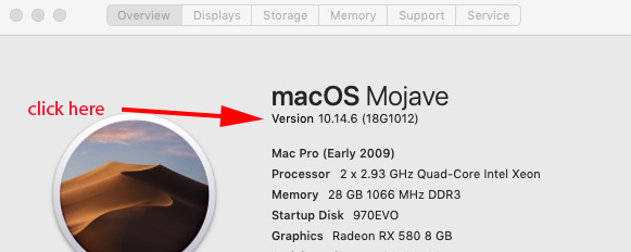

Which Mojave Build No. do you have installed ?
You probably are aware of how to find the build No. but just in case . . .
There were so many builds released shortly after the first 10.14.6 release.
Before the last Security update my Build No. was 18G103.
