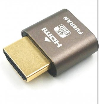

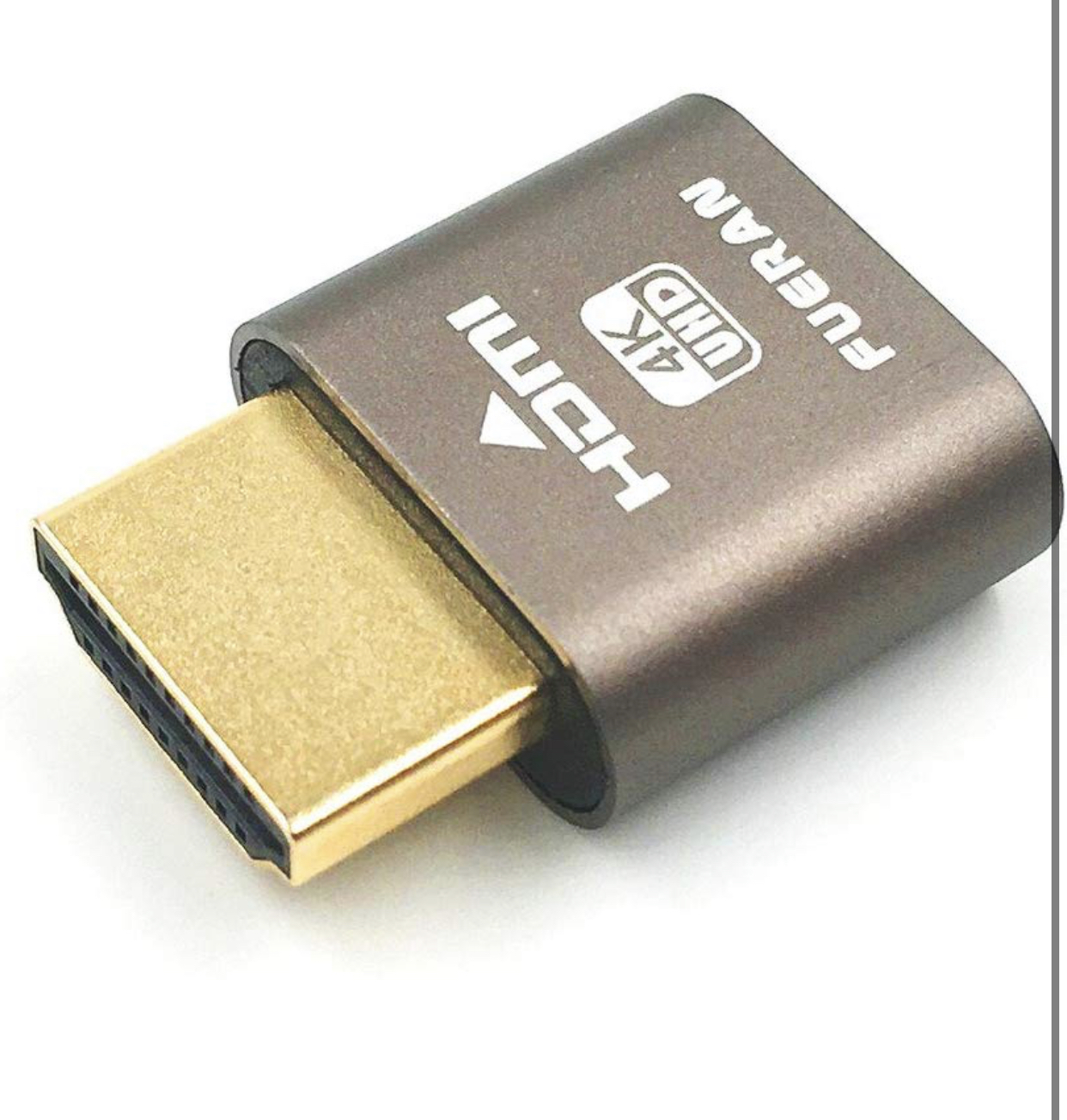

my LG 5k only has one input ...I am thinking is there any method to fake a second display in macOS?
I have found there is a HDMI signal dummy from amazon. Maybe can use to fake a second display.
haven't tried yet
Can you share amazon link so in the case I can eliminate the hdmi cable from macpro to monitor?
EDIT: https://www.amazon.it/EasyDiy-Emula...signal+dummy&qid=1579602058&sr=8-1-fkmr1&th=1
Maybe I can give it a try to see if I can remove my hdmi cable.
EDIT: https://www.amazon.it/EasyDiy-Emulatore-display-Displayport-4096x2160/dp/B07B9X8G7Z/ref=sr_1_fkmr1_1?__mk_it_IT=ÅMÅŽÕÑ&keywords=HDMI+signal+dummy&qid=1579602058&sr=8-1-fkmr1&th=1
Yes , it is the HDMI signal dummy
Look forward to your test

Will try if I can have the hdmi dummy in short time and in case get it back to amazon if it doesn't work.
EDIT: ok the hdmi dummy will be here tomorrow, I will let you know.

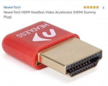

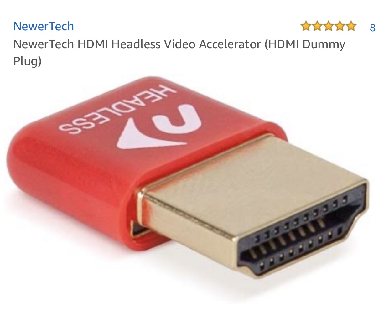

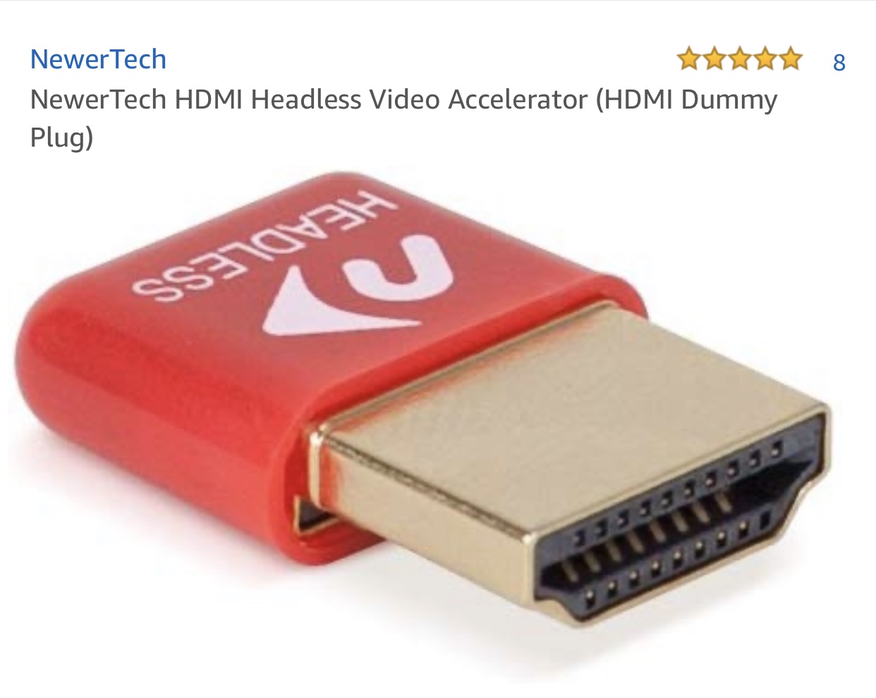

next is to try HDMI dummy dongle
The original one is Newertech HDMI headless.
There is also cheaper dongle made by China.

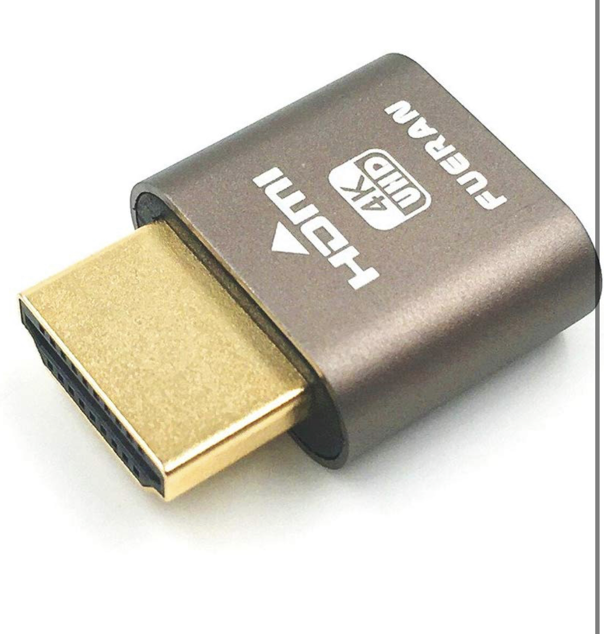

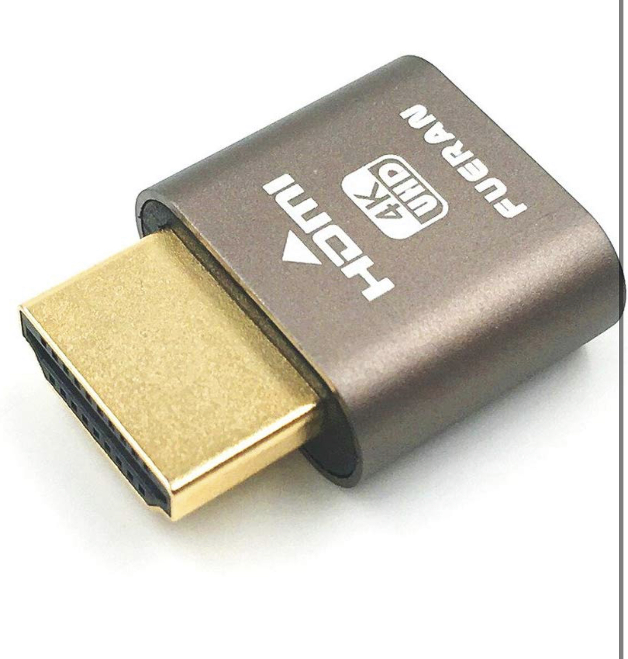

this one seeems to be better built and support macOS

I have tried your solution with success
One thunderbolt output to LG 5k
and one HDMI output to old monitor
no flicker at 60hz then
the old monitor does not need to be power on. even if HDMI connected to old monitor switched off, Macos still recognises the second display
i think HDMI dummy should be a success too
