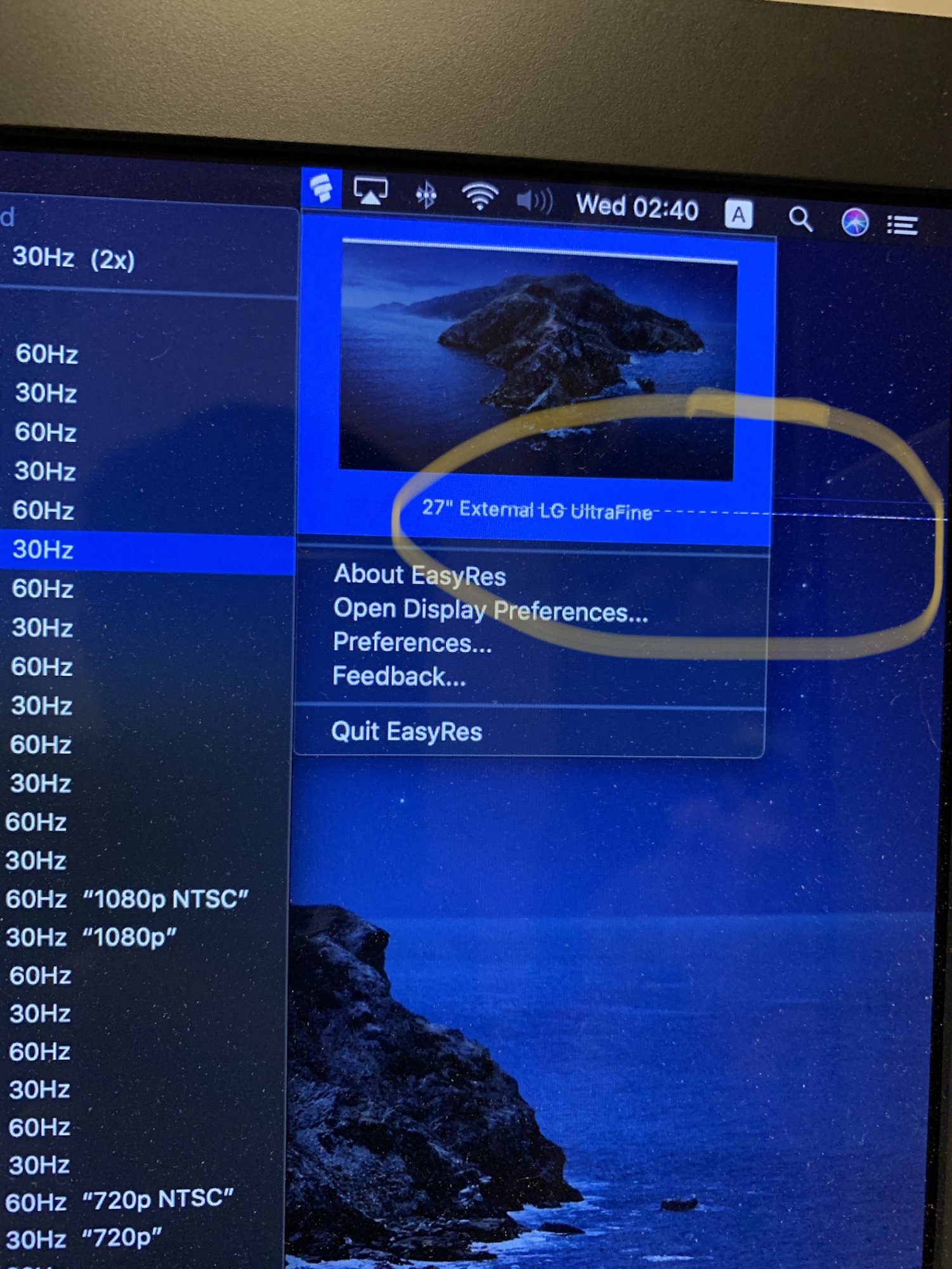

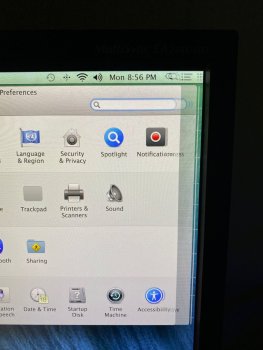

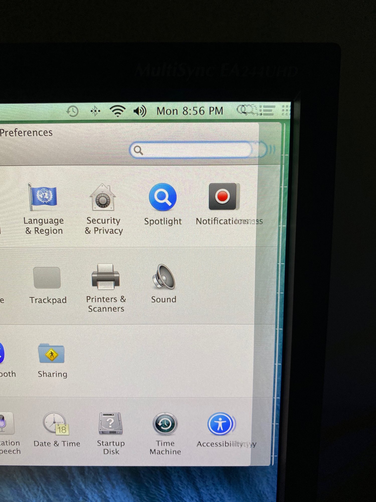

hi, it is not the flickering we are discussing
it happens in Mojave or above, at 4K @ 60hz
the right edge has some brief white flickering
I try to attached a photo for your reference

here is the flickering

This isn’t the same as the flicker I had. This looks like your graphics card is buggered.
I think the graphics card is not defected. We will get the same if we run Maverick OS X.
I have your "ghost" flickering when I boot into Maverick recovery mode by shift-option-command-R.
it is not a cable problem

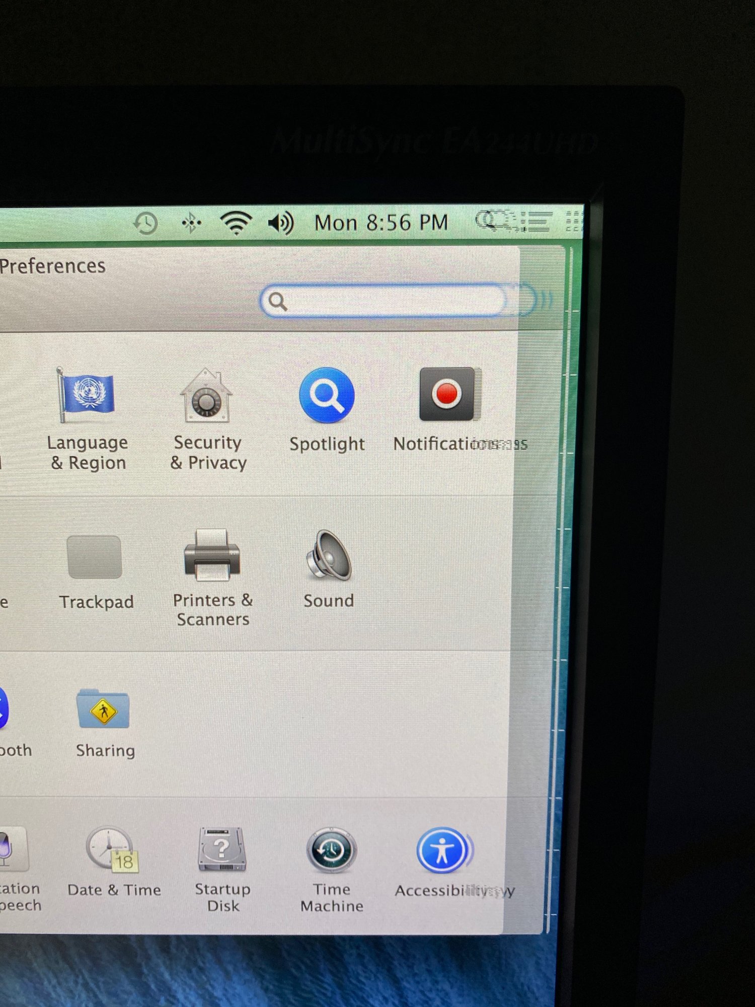

[automerge]1580841965[/automerge]

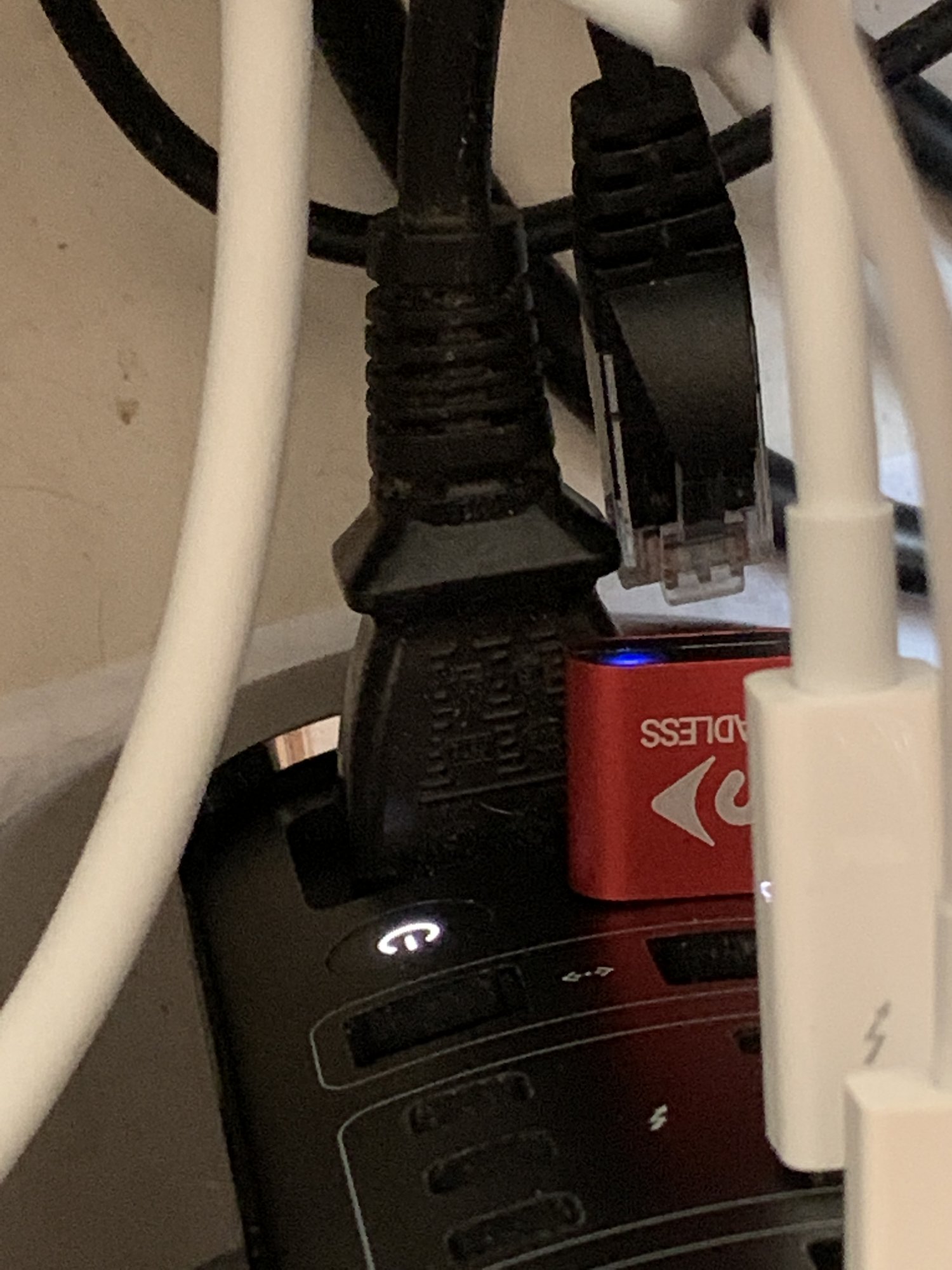

hey @chkwong thanks for reporting back and glad it works. Weirdest problem ever. Thanks for your original insight too. I literally just saw mine flickering right now and turned on my second monitor and its now gone. I'm going to grab one of these headless dummies too..
Weird problem
Hope next macos could solve the problem
Look forward to your solution solved by HDMI dummy

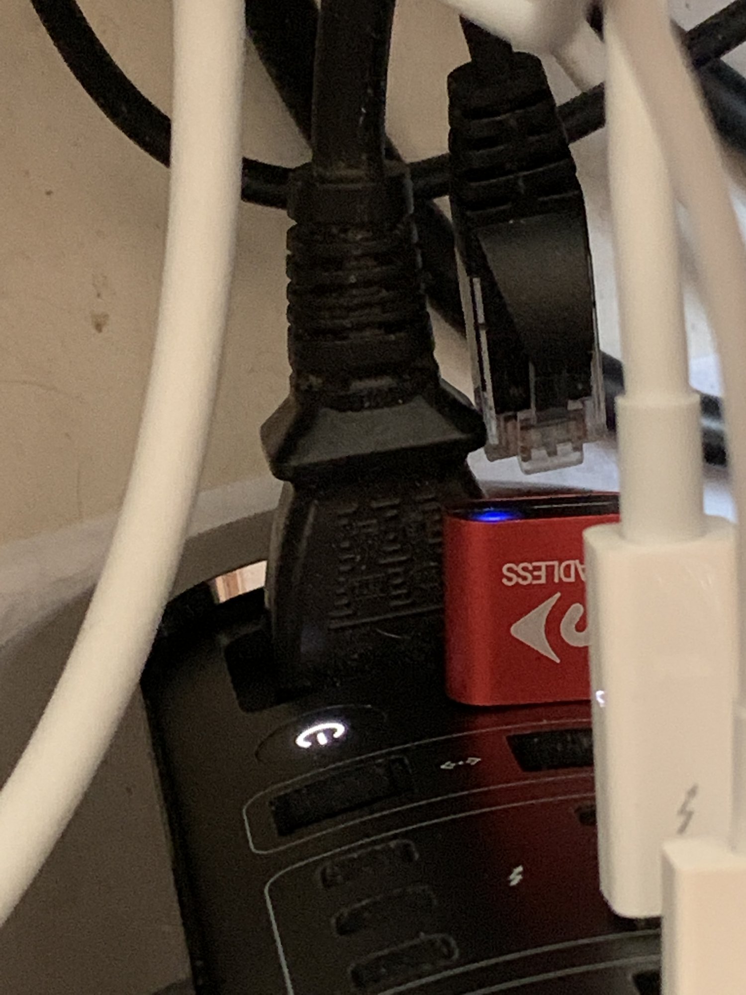

I added a HDMI dongle to solve the problem
Now can use 4K at 60hz

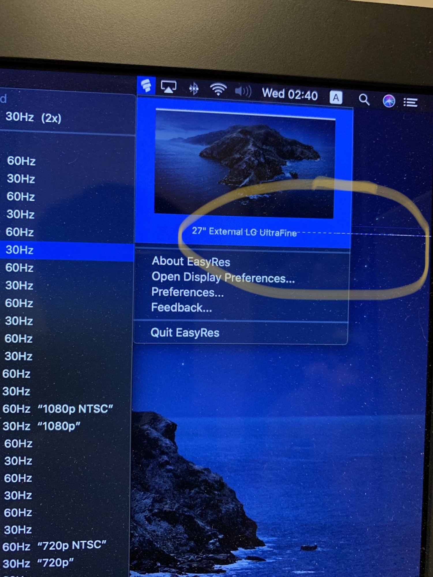

lower the refresh rate to 4k 30hz could also hide the problem
@chkwong thanks for your updates, i think you are correct and its related to the Driver. Has anyone reached out to AMD?
30Hz is not workable for me, makes me feel ill!
