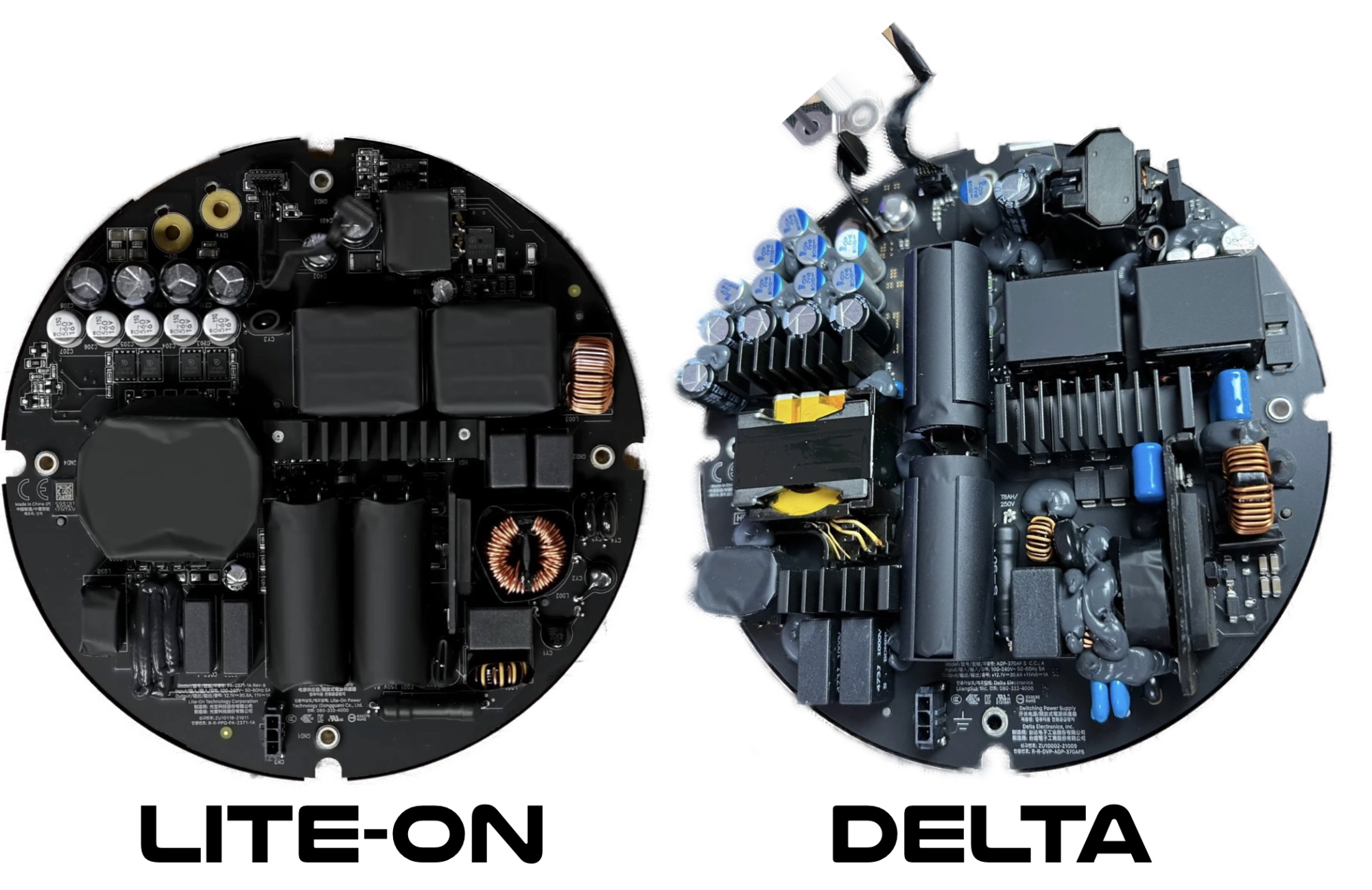

If this is a power supply issue, which design do you think is suspect of making the noise? Checking into teardowns to see if one variant is used more often in Ultra's vs Max may help answer that question.
I don't think anyone here is sure one way or the other. Just a lot of guessing going on.

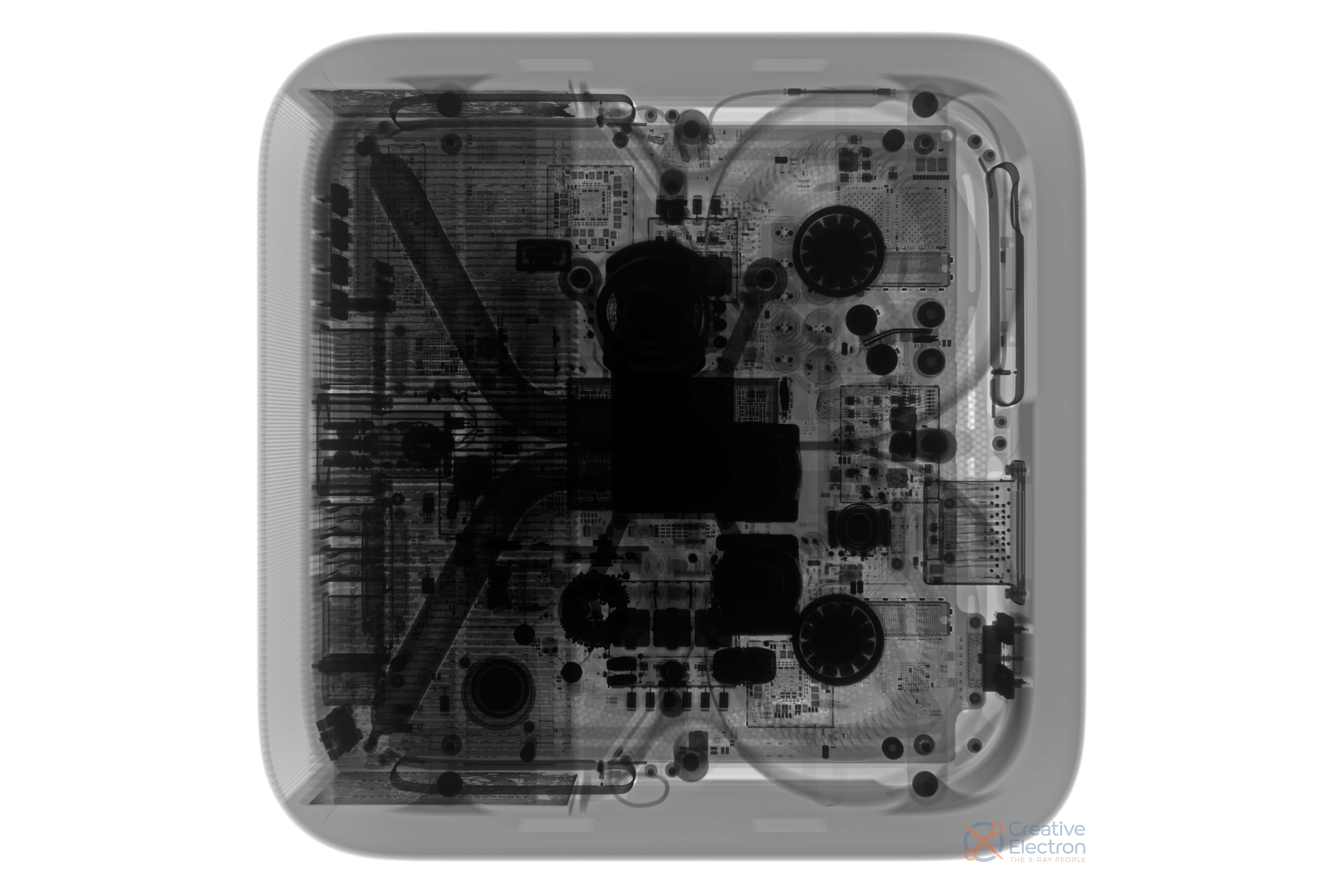

If someone can check an X-ray or other image of a teardown and count the exact number of blades on one of the fans (assuming they're identical), when I have time, I can pretty quickly derive some numbers that probably could provide evidence of the whine's potential association with the fan itself.
Reactions: Argoduck
There's actually an xray in google images, but it's not clear enough to count the blades. It's a centrifugal fan with a LOT of blades.
From the iFixit Teardown: I count 67
Thanks. If that blade count is correct, then I'm not sure what to make of it...yet. Just a quick rough calc says that would mean a 2.2 KHz. sound from a fan with 67 blades = 1970 RPM, which sounds too high. However, there is at least one video that shows the whine freq. increases with fan speed. Maybe I'll see what a rewatch of that yields.

If they are in sync, or nearly so, then no, not really, but that can cause another type of noise (a wow-wow warble), but not this "whine." If one is running measurably (significantly) different from the other, it would be seen as two peaks i/o one. With the right software, expertise, and techniques, unless the sync is perfect, even small differences can usually be discerned, as can just one of the fans failing completely, or almost anything in between.
After watching a few more videos, I am thinking that, aside from the "numbers" not matching those expected, the nature of the noise may not be the blades directly. For lack of a better term, it sounds more "electronic" in nature, or, it possibly could be a sort of "whistle" (that covering half the back trick is also intriguing). Not even close to sure yet, and I hope I don't find out when I finally unbox the new Studio in the next few days (again, hopefully).
