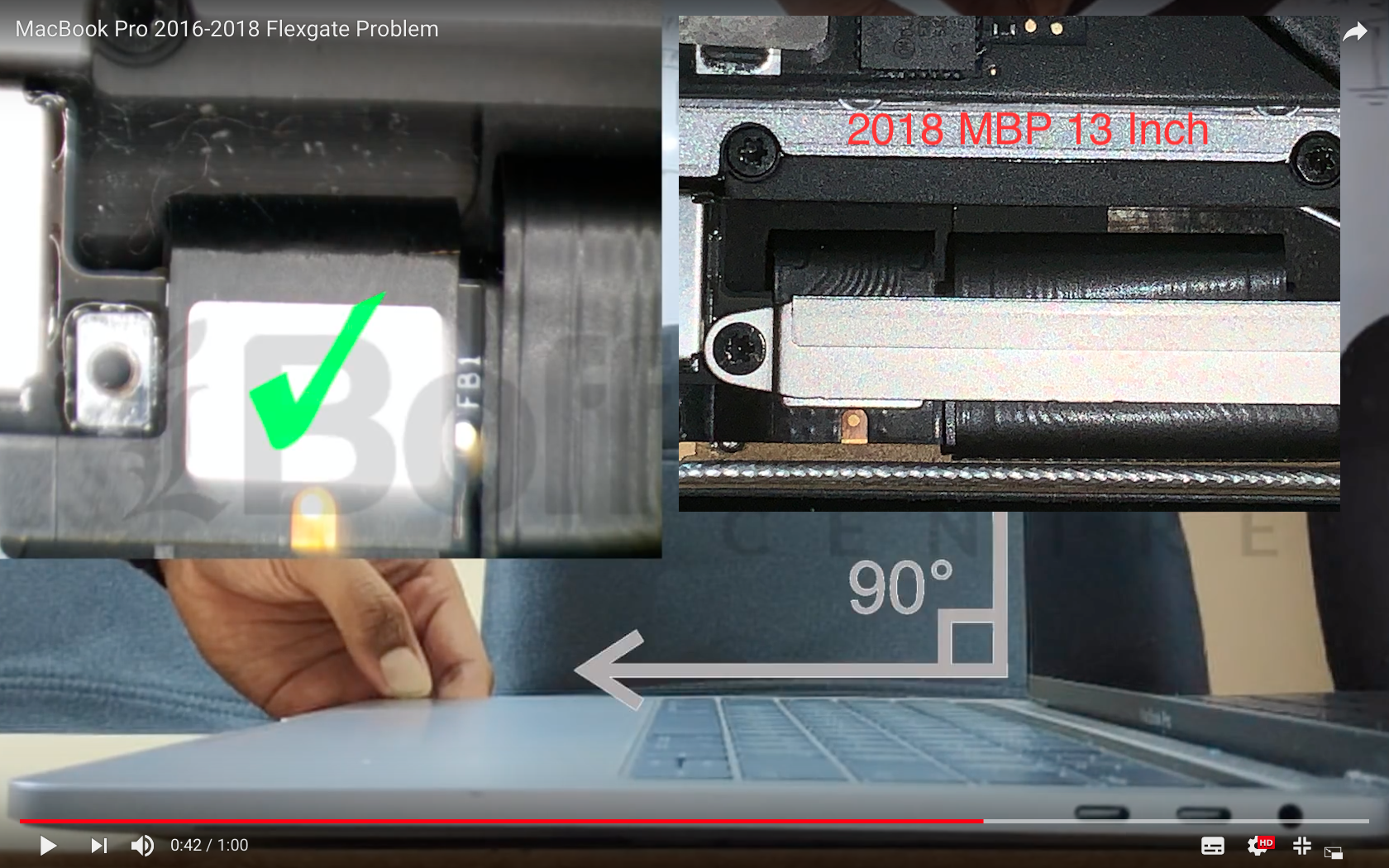

So I managed to spill a drop of tea on my 2018 MBP's trackpad today.
I'm pretty sure nothing got inside, but I didn't want to risk anything so I took the cover off and am going to let it be open a day or two.

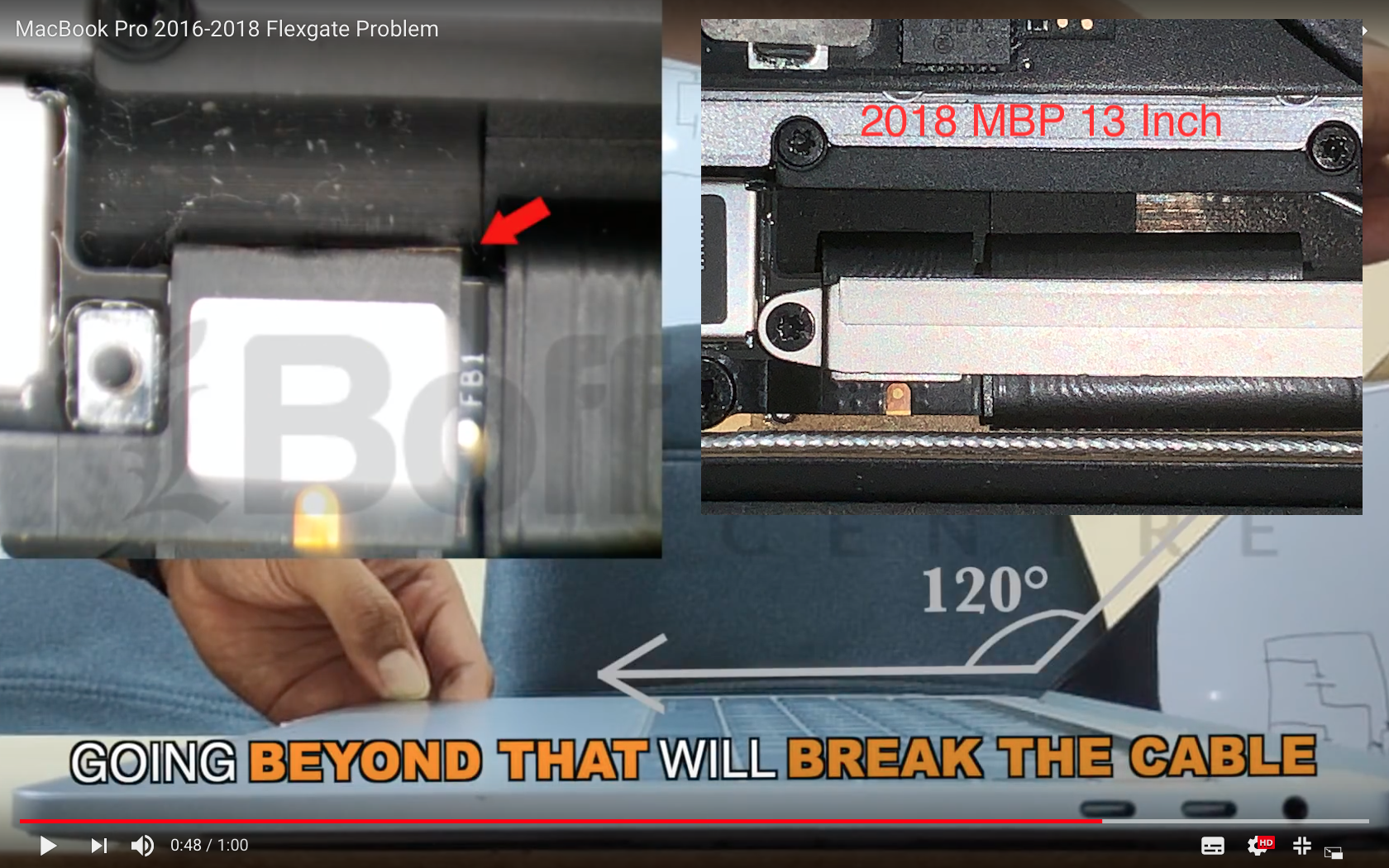

While it was opened, I thought I'd take two pictures of the flex cable and compare it to the video on page 2
Opened 90 Degrees:
Opened Max:
YO. Am I the only person seeing this that thinks the cable on the 2018 looks more robust than the 2016 cable? Not just longer but possibly thicker with better quality traces in the cable? Maybe slightly different material?
iFixit or whoever - WE NEED A 2018 TEARDOWN AND CABLE LENGTH COMPARISON TO THE 2016/2017 models (and 2018 MacBook Air while you're at it). We need a thickness of cable examination, a side by side comparison of the cables visually, and even as far as determining composition of material.
If Apple added a longer, more robust cable, that's Apple's admission that the original design is faulty and will allow for more pressure publicly against them - and extra support for a class action suit.
BONUS ROUND - is it possible that launch 2018s may not have had this fix and its something they've revisited during manufacturing (a later 2018 may have the improved cable like Olivia88 posted). If that's the case it makes things even more evident against Apple and would add relevancy to the Flexgate timeline.
If iFixit or another group does a full teardown, with comparisons and measurements showing a significant revision to correct the problem - Id say this post or one like it would benefit from a sticky to increase exposure, warn users with affected machines on how to properly open their laptops, upcoming class action suit, and even through Apples admittance and extended warranty.

I wish someone would do a video tear down of all 3 machines and compare then for ya to ensure the cables have been fixed.
[doublepost=1551797139][/doublepost]And it’s been fixed according to ifixit! Credit goes out to Olivia88 for finding this!
