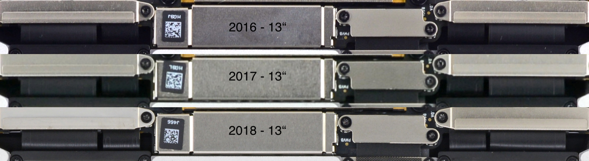

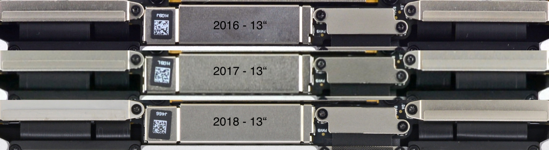

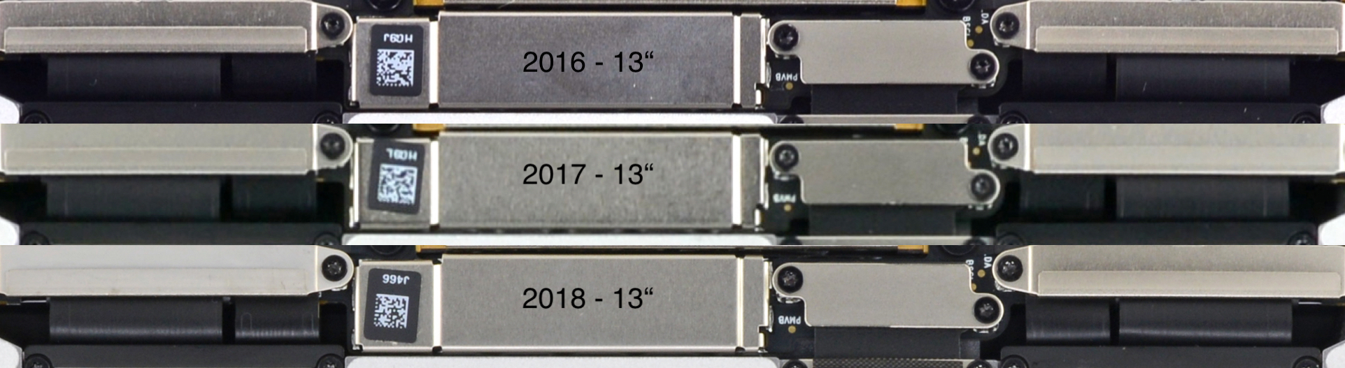

Hey Guys,
so i just created this account to share my findings.
I gathered the High Res photos of iFixit's Teardowns of the 2016, 17 and 18 MBP 13" and compared their flex cables.
As you can see in the attached images there is actually quite a difference in the way the flex cable bends in the 2018 model year. This could mean that Apple changed the length of the cable already with the start of production and not, as some speculated, while the whole flexgate scandal took place.
@Olivia88 it would be interesting to know when you bought your MBP to see if this would confirm my assumptions
Greetz

Hey Guys,
oh, this is very bad... this means apple knew that the cable was way too tight but they were still selling the 2017 model when designing the 2018 model with longer cables.
quite interesting to see what happens...
Well you have to remember too though that parts are made in bulk. This is speculation, but my guess is by the time Apple realized there was an issue with the cable, they had already taken delivery of the majority of the cables and monitors for their 2017 mode year machines, and as such they probably decided it’d be less expensive to try to ride out the storm of some computers have the issue than reordering a whole set of new monitors with longer cables.
In the end it’s about the bottom dollar for the company, and using the already supplied parts with a potential later “repair program” was probably cheaper than reordering a new set of parts. Not to mention the cost of delaying or having backorders for their flagship laptop could prove costly.
[doublepost=1551976532][/doublepost]Nobody has asked it yet (at least from what I can see), but has anyone who has had this issue repaired by Apple opened their machine to see if the monitors are being replaced by the seemingly longer cables on the 2018 models? I don’t know the exact details of the internals, but I would imagine the 2016/17 MBP monitors are interchangeable with the monitors on 2018 MBPs.
If so this could be promising that if Apple does fix your computer with a 2018 monitor, you shouldn’t see the issue again. It’s wishful thinking, but entirely possible.

My MBP 13 inch was manufactured in august 2018, and I bought it in November 2018 🙂
