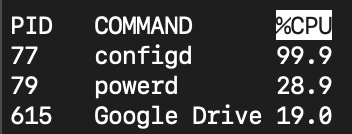

MacBook Pro mid-2014. when on battery, configd jumps to 100% CPU when charge reaches ~60%. Chrome, Evernote and MS Teams become unresponsive. Evernote and Teams are both Electron apps, i.e. are web apps running on Chromium. Google Drive also becomes unresponsive; I'm unsure if that uses a Chromium webview.
I just replaced the original battery. The problem remains unchanged. Disabling WiFi doesn't seem to help. Plugging into power is the only solution I've found in this case.
