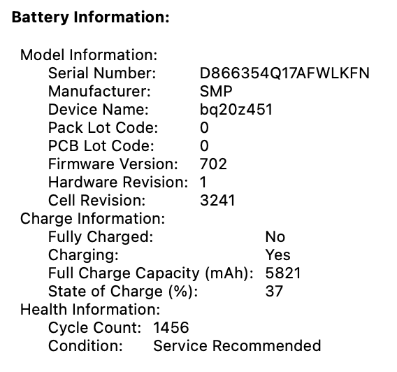

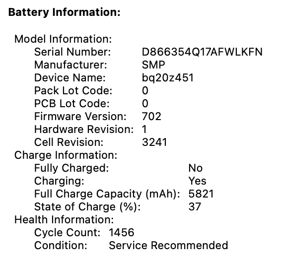

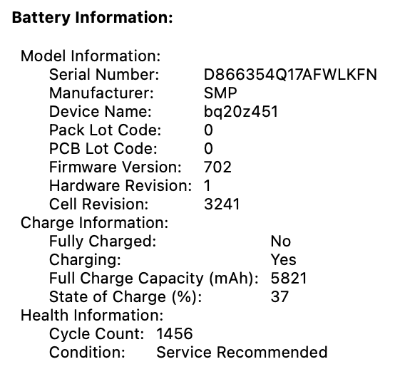

SOLVED.
As people mentioned above, my problem started after the unofficial battery replacement. I was promised that it was genuine, but turns out it wasn't.
I fixed my problem by finding a repair shop which had old original batteries (with Firmware version 702). They gladly installed one of their old batteries (they were going to discard them anyways) and the problem went away.
Because the battery is old, it's showing "Service recommended". However because of this exact message, I can now go to Apple and have the battery officially replaced to a brand new one for $290 (without this message it would be $600+).
So to sum this topic up - if your newly unofficially replaced battery is showing
Pack Lot Code: 3230
PCB Lot Code: 3230
Firmware Version: 2d31
Hardware Revision: 322d
(or similar) then you have a fake battery and will be getting high configd cpu usage as a result (due to some weird battery firmware incompatibility).
This is how a proper battery should look like:
Reactions: mobiletuner

SOLVED.
