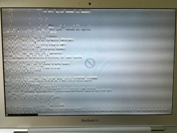

Doesn't seem to work :( It first boots fine for a bit but then displays the 'broken' icon.
Mine does the same unfortunately. This is what it looks like in verbose mode:

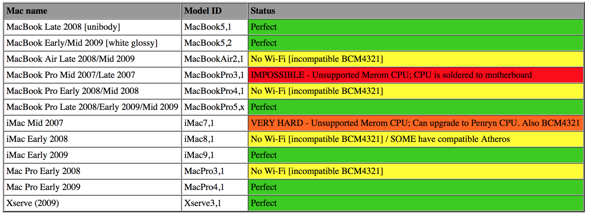

The newest compatibility chart
I'll be testing for the iMac7,1 in the coming days and will report my results. I have a SLAYX Penryn on order, just waiting for it to come in.
