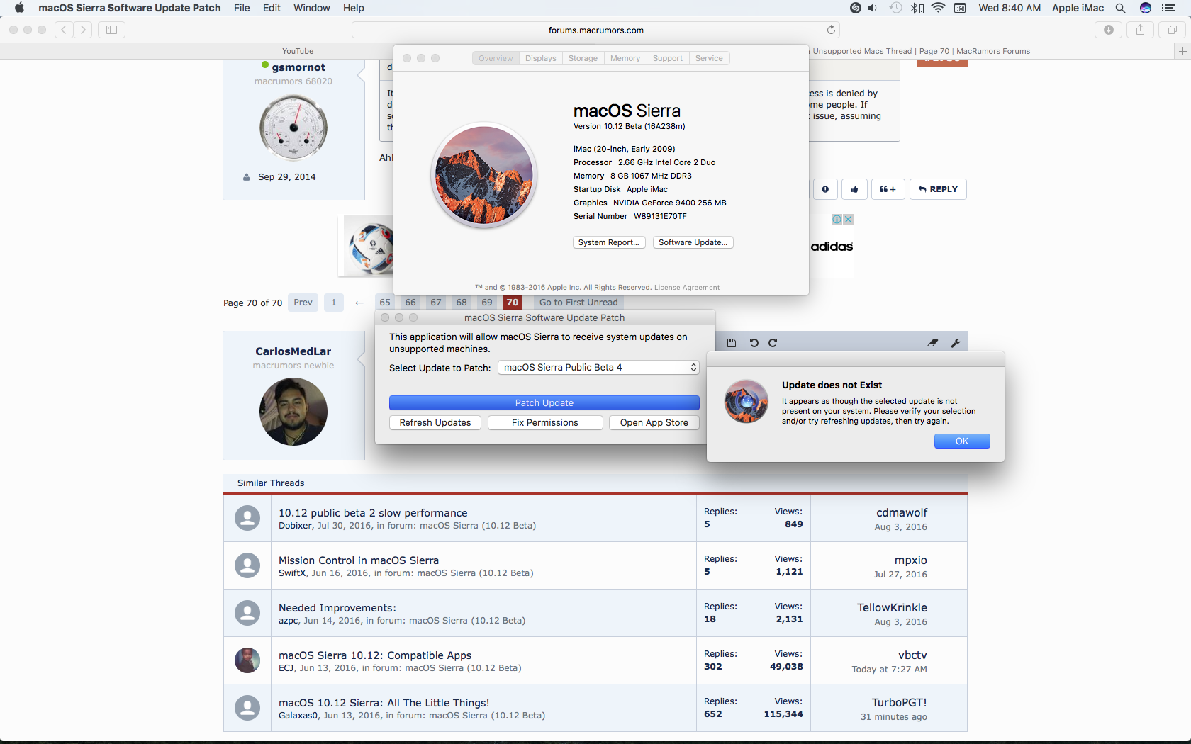

I can't, really... I can't!! I have MacOS Sierra Public Beta 1 in my iMac (Early 2009 with upgrade to 8GB RAM) and the tool not works for me. Yup, I already update the tool to the last version ("Fix Permissions" update), I try with PB2, PB3, PB4, DP3, DP4 and DP5 and NOTHING! I Already restart the machine, restart PRAM, "Fix Permissions", "Refresh Updates" a lot of times and NOTHING, at this point I really need someone that help me...
