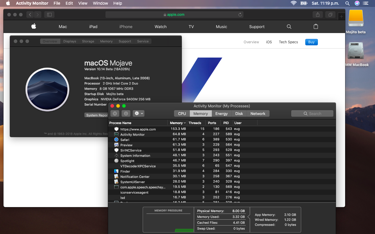

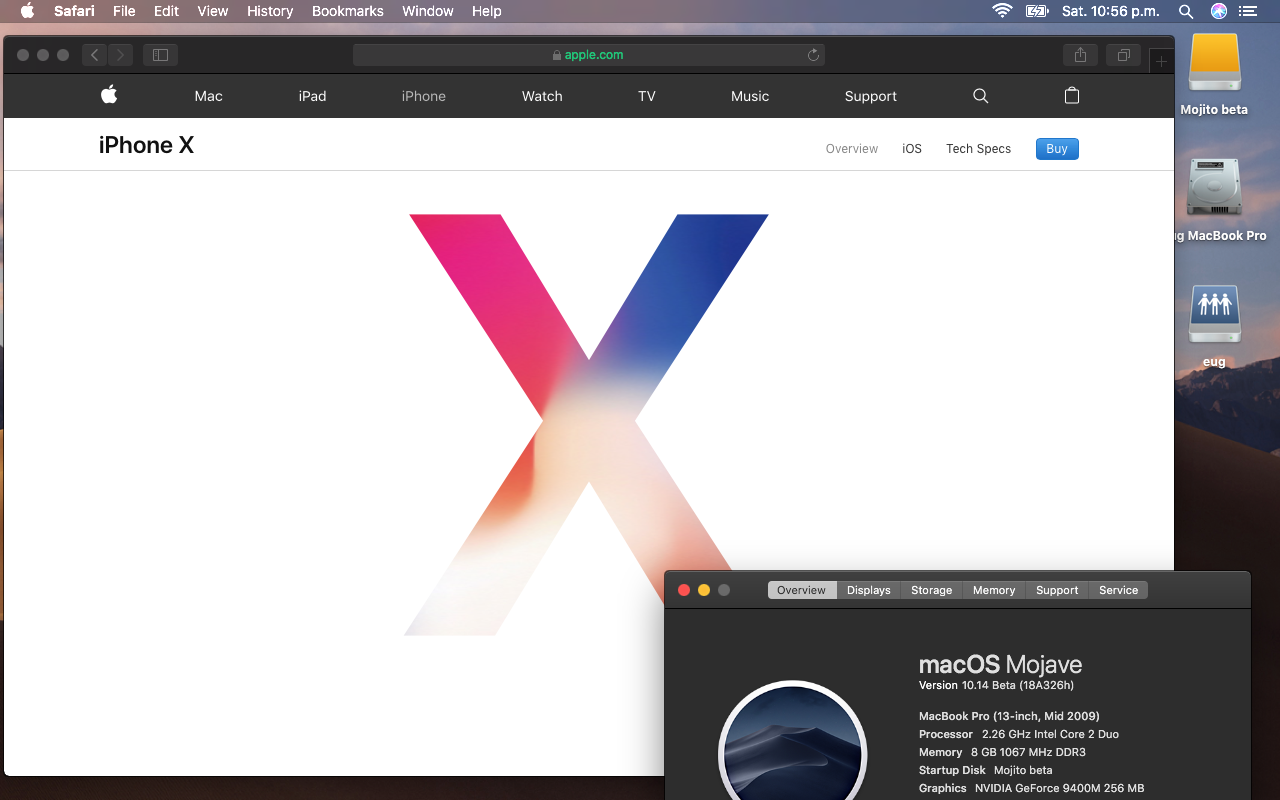

Installed and tested on two pre-2010 machines, MacBookPro5,5 and MacBook5,1. Works but there was an error during setup. On the welcome page I got a UIKitSystem quite unexpectedly error. Strange.
Nonetheless, the system seems to work on my nVidia 9400M. I just ran the patcher with the default settings for my Macs. I don't recall checking off a legacy video box, but maybe it was already checked with the b10 patcher. I can't remember.
Interestingly, VeganMacGuy in the MacBook6,1 High Sierra video glitch thread mentioned the 9400M h.264 playback glitch disappeared in Mojave. I can confirm the that the iPhone X webpage video glitch is gone with nVidia 9400M in Mojave. Is this because the patched OS uses 10.12 Sierra kexts?
2009 MacBookPro5,5:
2008 aluminum MacBook5,1:
iSight doesn't work on either machine, but I didn't do any kext swapping. The green light comes on, but nothing displays. Hopefully that will be included in a later version of the patcher.
Thanks guys! This is looking good.

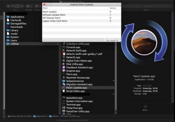

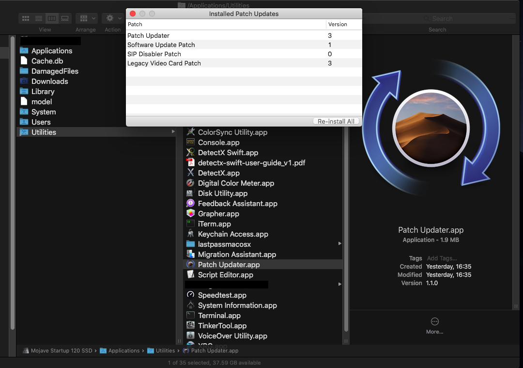

if you can't remember what patches you ran, run Patch Updater & will provide info & updates.

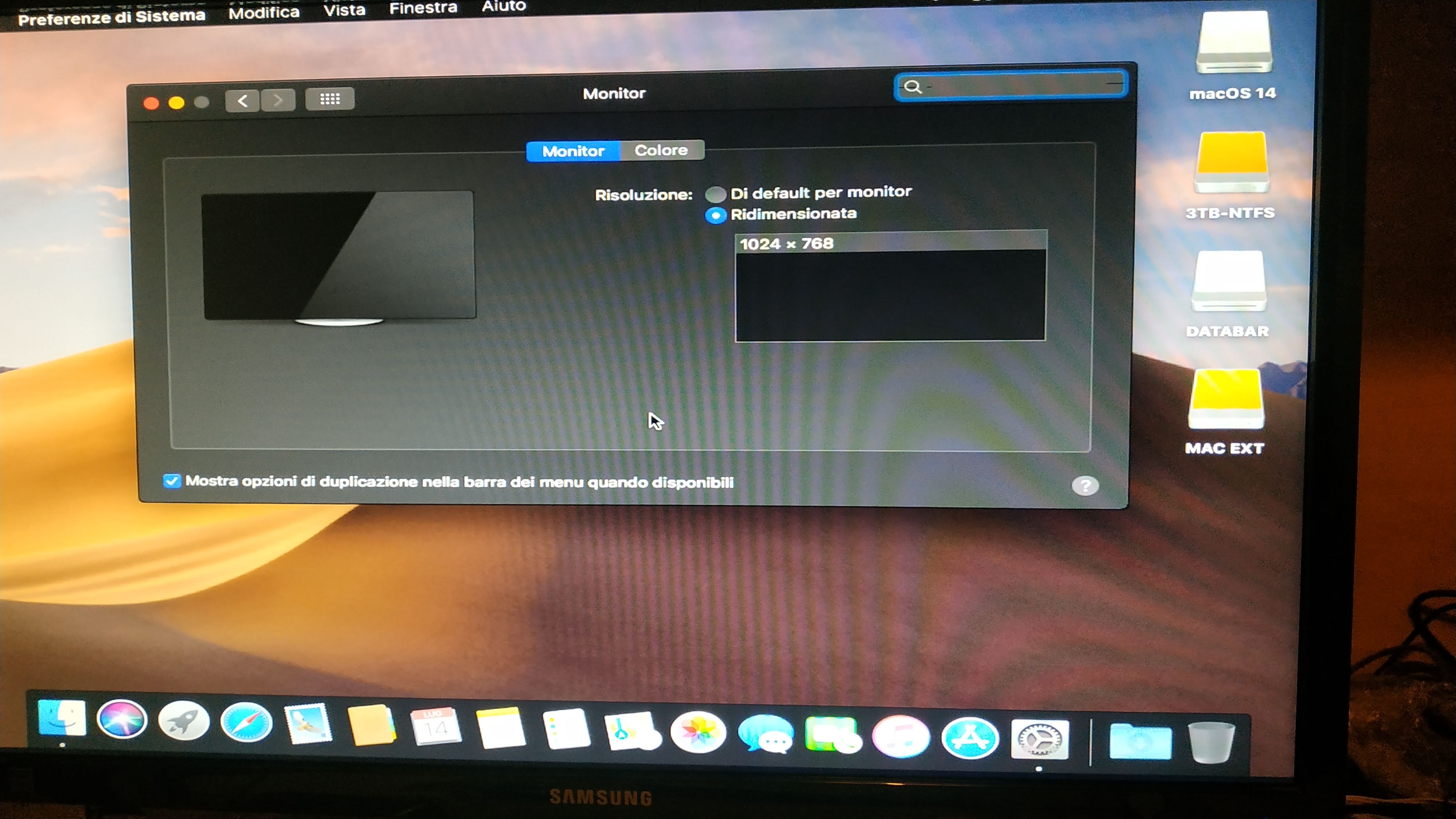

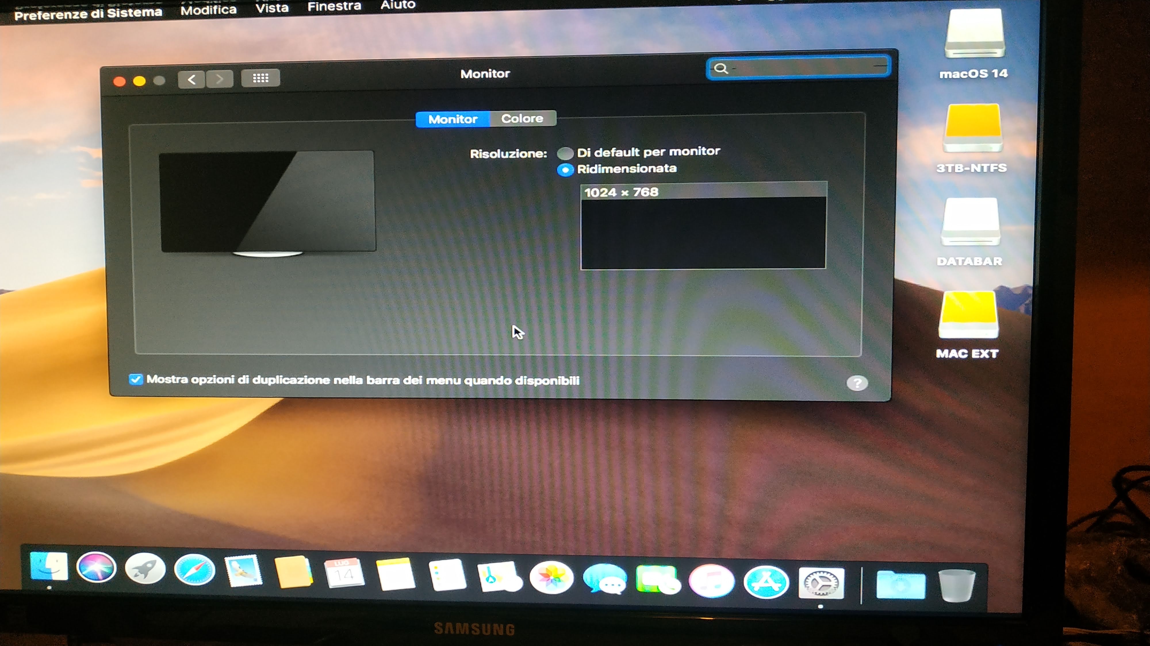

Hi! @dosdude1
I have downloaded and applied b10 patch, but still not video acceleration and only 1024x768 resolution on my Macmini mid 2010 (Macmini4,1) 8 GB RAM Nvidia Geforce 320M DDR3 Core 2 Duo Penryn 2400 Mhz. Same result with or without legacy video patch.
@ASentientBot have you reports of others Macmini 2010 working with Mojave? My monitor is a Samsung S24D300 perfecty working and immediately synching full HD with High Sierra, with Mojave it is unknown.
Thank you!
