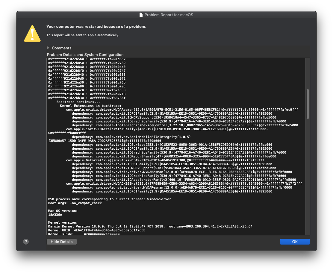

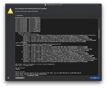

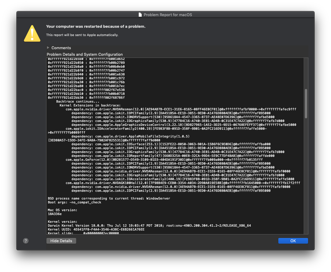

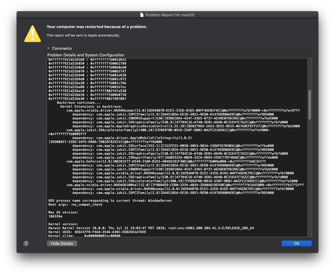

I'm still having the kernel panic waking from sleep on my 2011 iMac with the 780m installed. This problem was occurring on the last beta as well. Its most likely related to Nvidia Graphics, I do not have this issue in High Sierra. (dual booted) There are no Video patches installed.

Mine only happens waking from sleep. The 780m is still a supported Nvidia card, I don't understand what could be causing this I tried fixing graphics power management in the last beta.

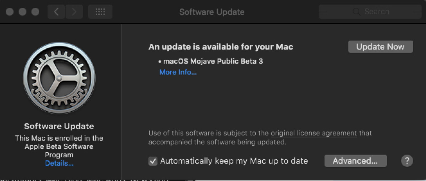

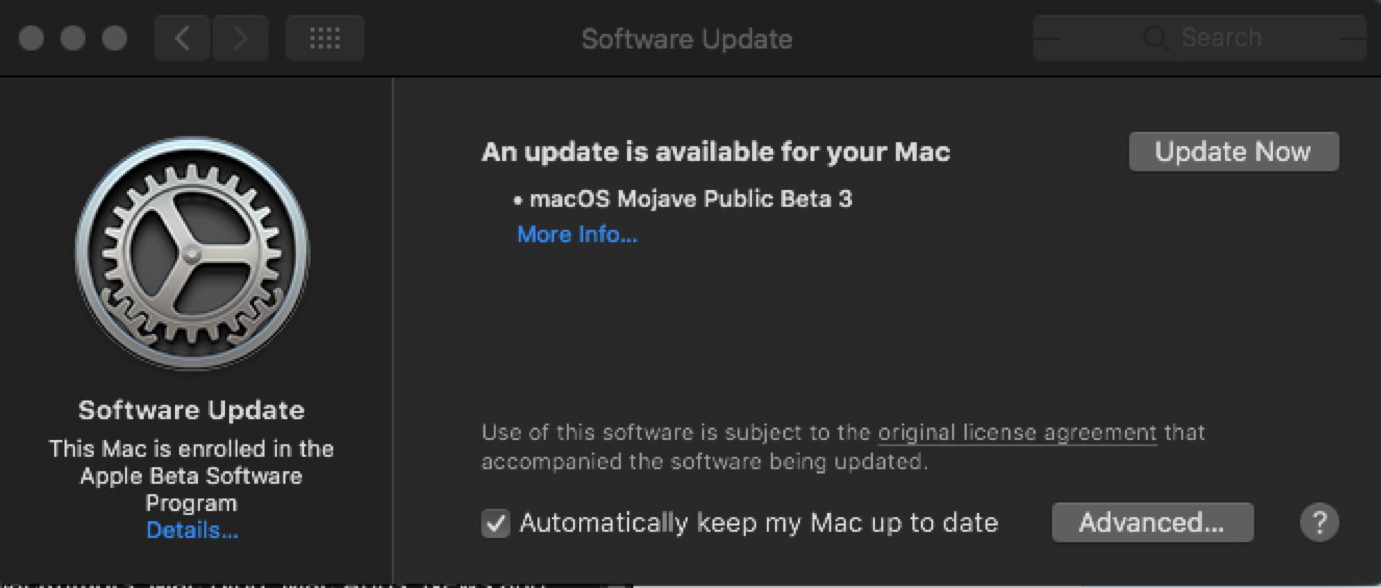

I got prompted to update via software, new version Mojave beta, I believe in an earlier post it's not recommended to update via sys software, so anyone have a final verdict, I know I'll have to run the patch afterward.

Just trying Mojave beta 4 from a supported Mac here are the news I notice:
- Not only Dashboard's Weather but every Dashboard Widget have black/white borders instead of transparency
- Font smoothing in dark mode are optimized
- Dynamic Desert Wallpaper seems to work and there is a new dynamic wallpaper "Solar Gradients" very nice
- Maps support dark mode
If I notice other things will report editing this post.
edit:
There is a new Corebrightness framework unix binary sized 718 KB
I will clone this partition to test Mojave beta 4 on unsupported Macbook7,1 and see if the old patches still work. At first sight seems some new patches could be required.
Ok, after manually replace patched GeforceTesla*, AppleHDA*, IOUSB*, telemetry.plugin trying booting new Mojave beta 4 from MB7,1
I got an instantly panic, I've checked it seems due to the only High Sierra IOUSBHostFamily.kext, so this time to avoid a quick KP all the IOUSB*** from HS are needed replacing for Mojave beta 4.
Ok after replaced them rebuilding prelinkedkernel then booted again but get a KP later before the stage2 apple logo, it seems from the panic that last kext loaded was NVAStartup, I'm continue to test.
Ok after deep investigation, applying all known patches I got this KP just before the stage2 apple logo (don't know why but seems linked to the IOUSB*** replaced kexts):

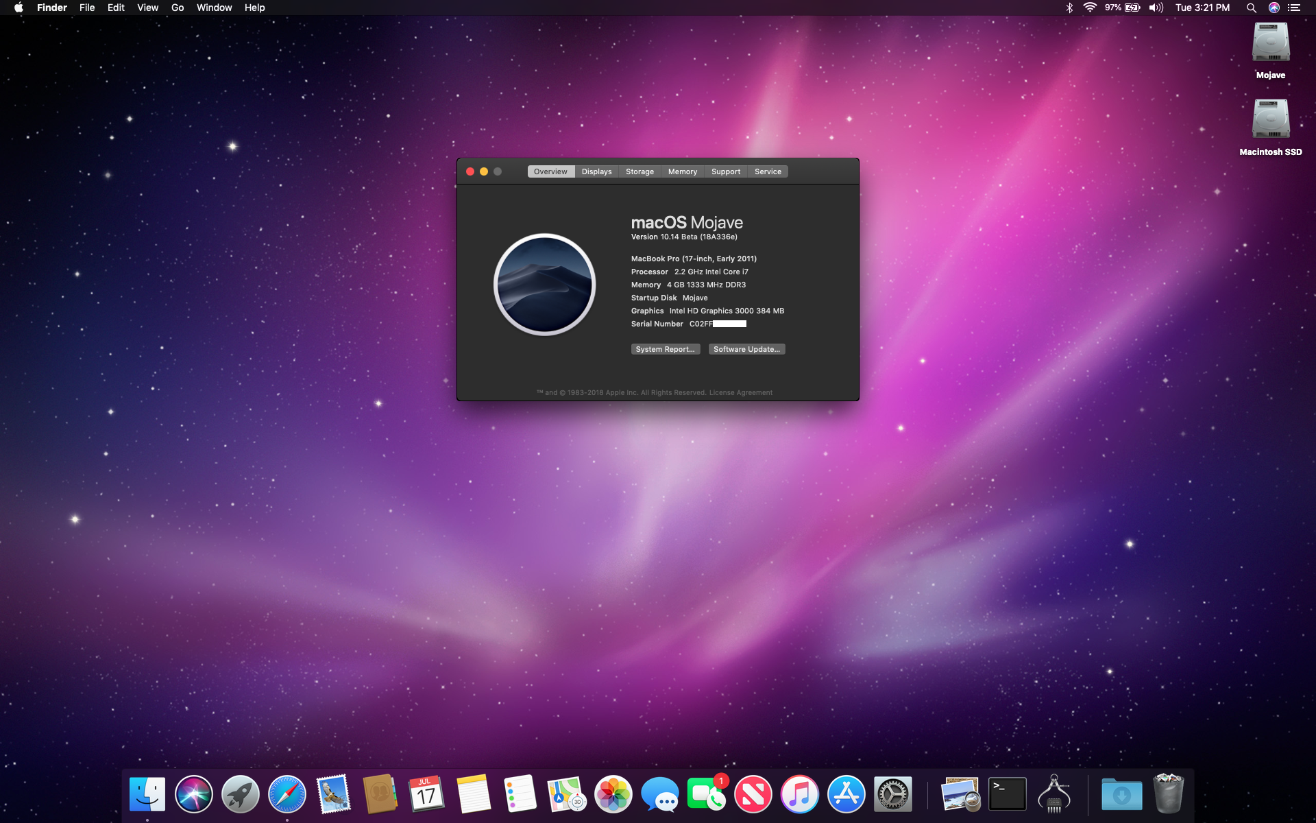

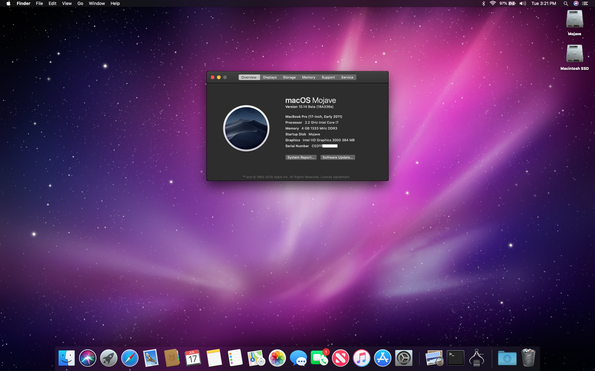

Success with beta 4 (18A336e). There are a few additions / changes, but performance seems to be mostly the same from what I can tell.
Interestingly, when comparing this to my previous screenshot of beta 3, it looks like the menu bar and window shadow got darker. (Provided this change also happened on supported Macs, would be applicable to the "Little Things" thread.)
Did you upgrade via System Prefs or install from patcher?
