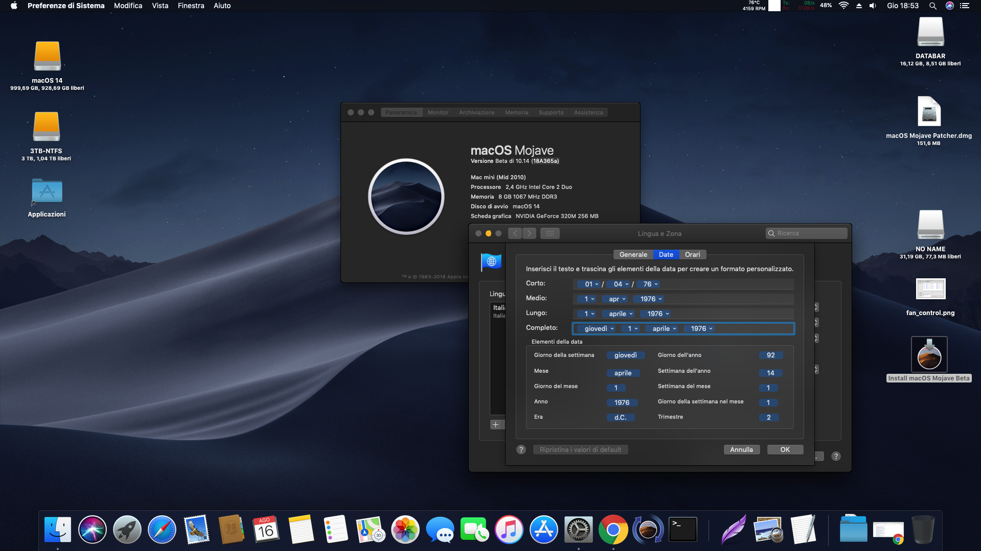

@dosdude1 @ASentientBot Mojave Beta 7 18A365a ok with macOS Mojave Patcher 1.1.2 on Macmini 2010 (Macmini4,1) Active corners now work for switching off monitor with mouse, long date format setting on Preferences still bugged thanks to Apple :)
Thank you!

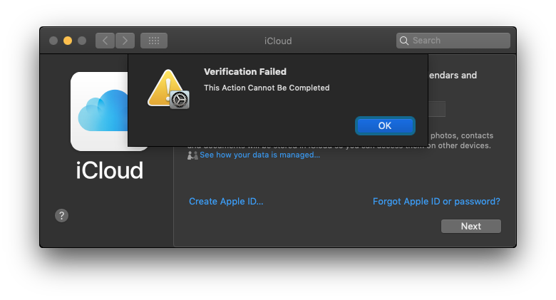

Hi, I've got another issue.
After updating mojave to DP7 I wanted to install Night Shift again.
It always worked for me. But this time the system didn't boot anymore. So I reinstalled mojave via the patcher, or I tried.
I got an error that it couldn't be installed on the volume so I checked it with disc utility and apparently there was an issue with my start volume that couldn't be fixed.
So I wiped the disc, did a fresh install and migrated my system.
My keychain got broken or forgot all my mail passwords and and after fixing this I can't log in to icloud any more.
[doublepost=1534448483][/doublepost]Though I'm still logged in at the App Store..

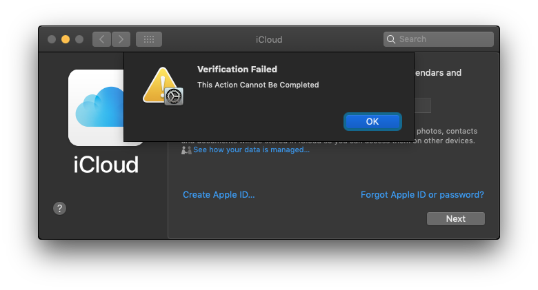

did you try and reset your password or not entered the password correctly
