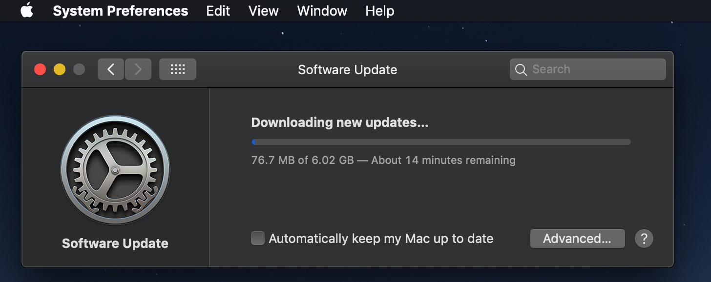

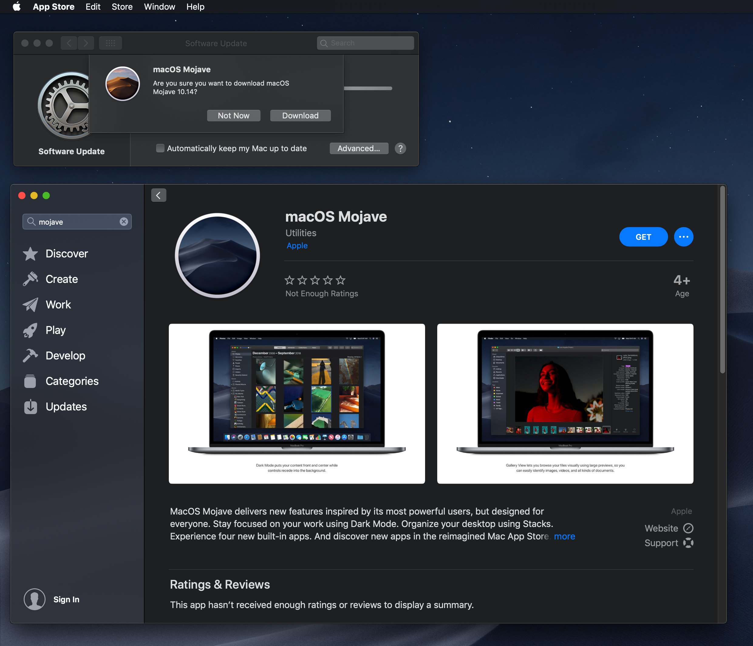

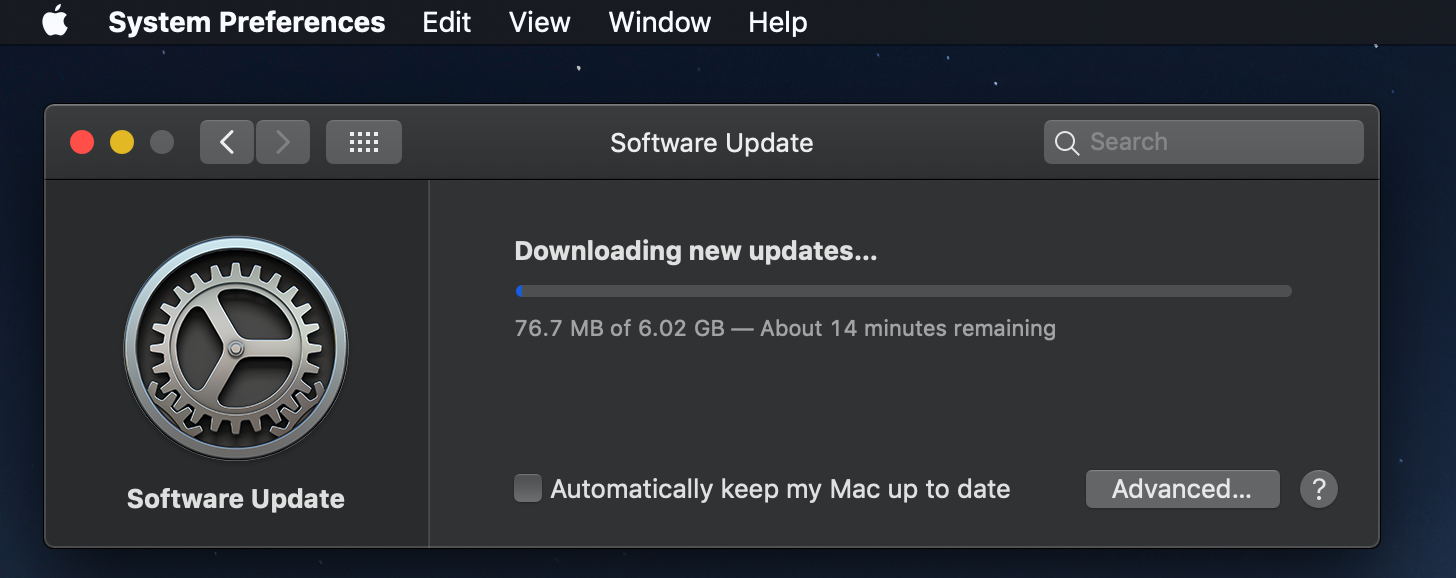

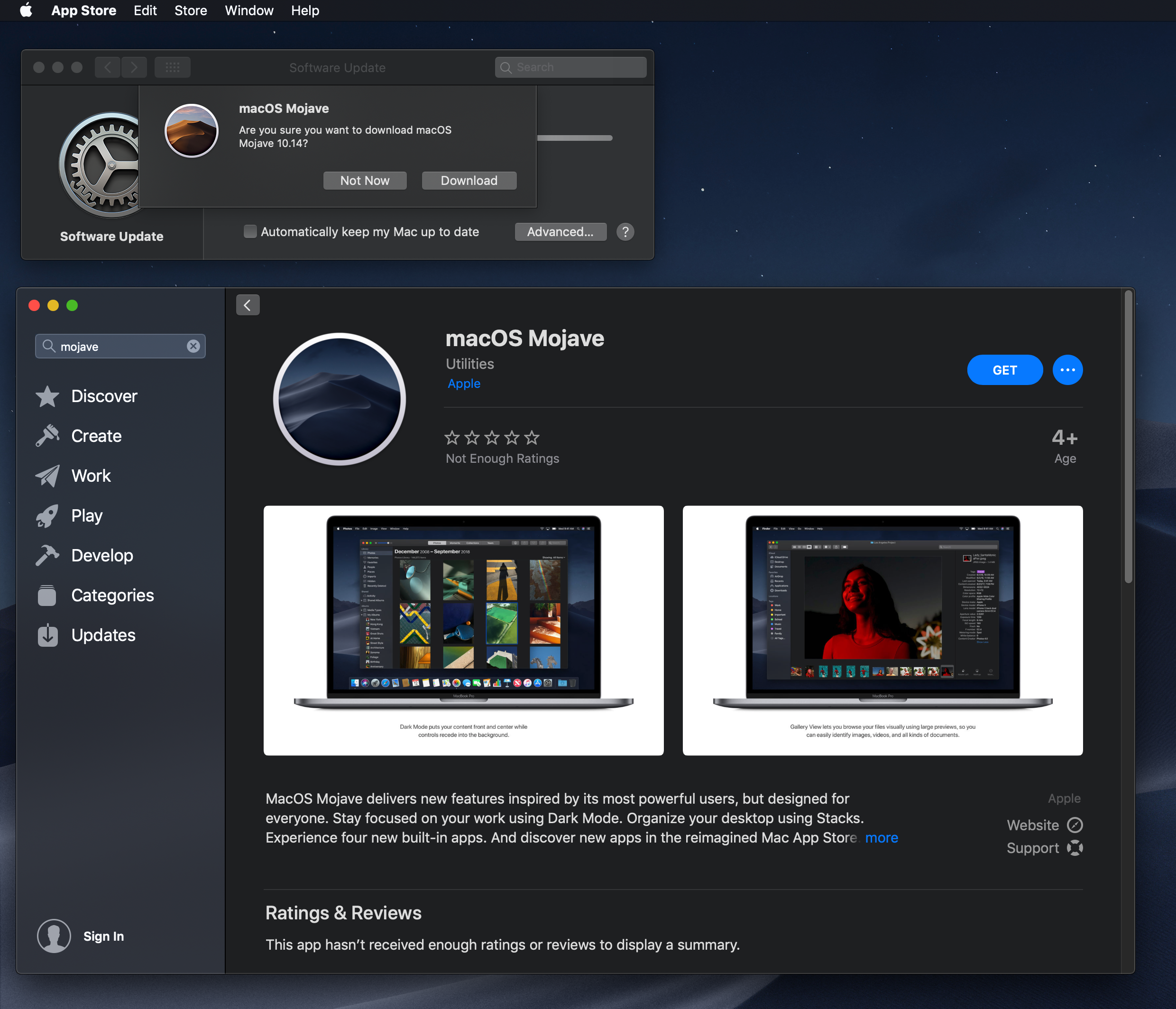

Happy September 24th!
Alternative download for the official release of Mojave 10.14.
From Mojave beta or pre-GM, go to Apple Menu -> Apple Store. Search for Mojave.
The OS will be a choice to "Get". Click "Get" and it will proceed to look for the full update and download the installer from System Preference -> Software Update.
Note: Clicking on just Software Update from a pre-release will just say it's up to date. This is a workaround for that issue.
There are also some options for the Software Updater. Not sure how useable these options are for unsupported Macs. I'm probably gonna just use Dosdude1's patcher from the full installer downloaded from Apple. Apple's downloader looks a lot like dosdude1's. Coincidence or conspiracy? lol
Install Mojave will be in your /Applications folder like always. I usually copy it to another drive for save keeping.

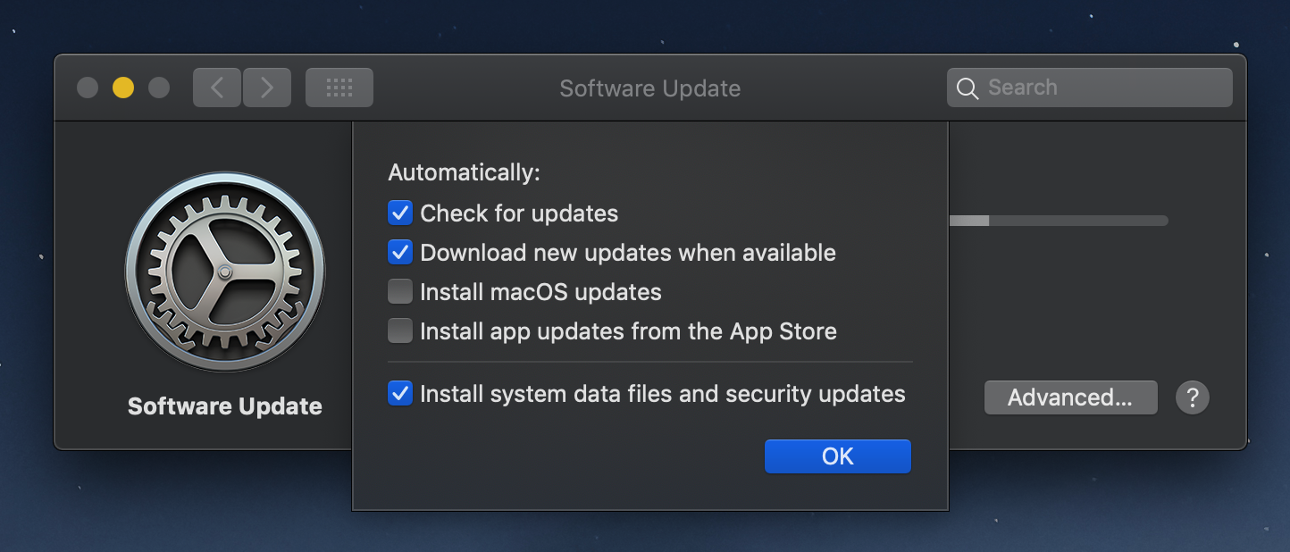

Apply the patch. I would just use the updater for downloading it and use Dosdude's patcher to install it. With the no go sign unauthorized, you be able to apply the patcher to that install.
I'm setting my system prefs for the updater to only download updates and not install anything including system data file and security updates. That way I'll have total control over what gets on my system.

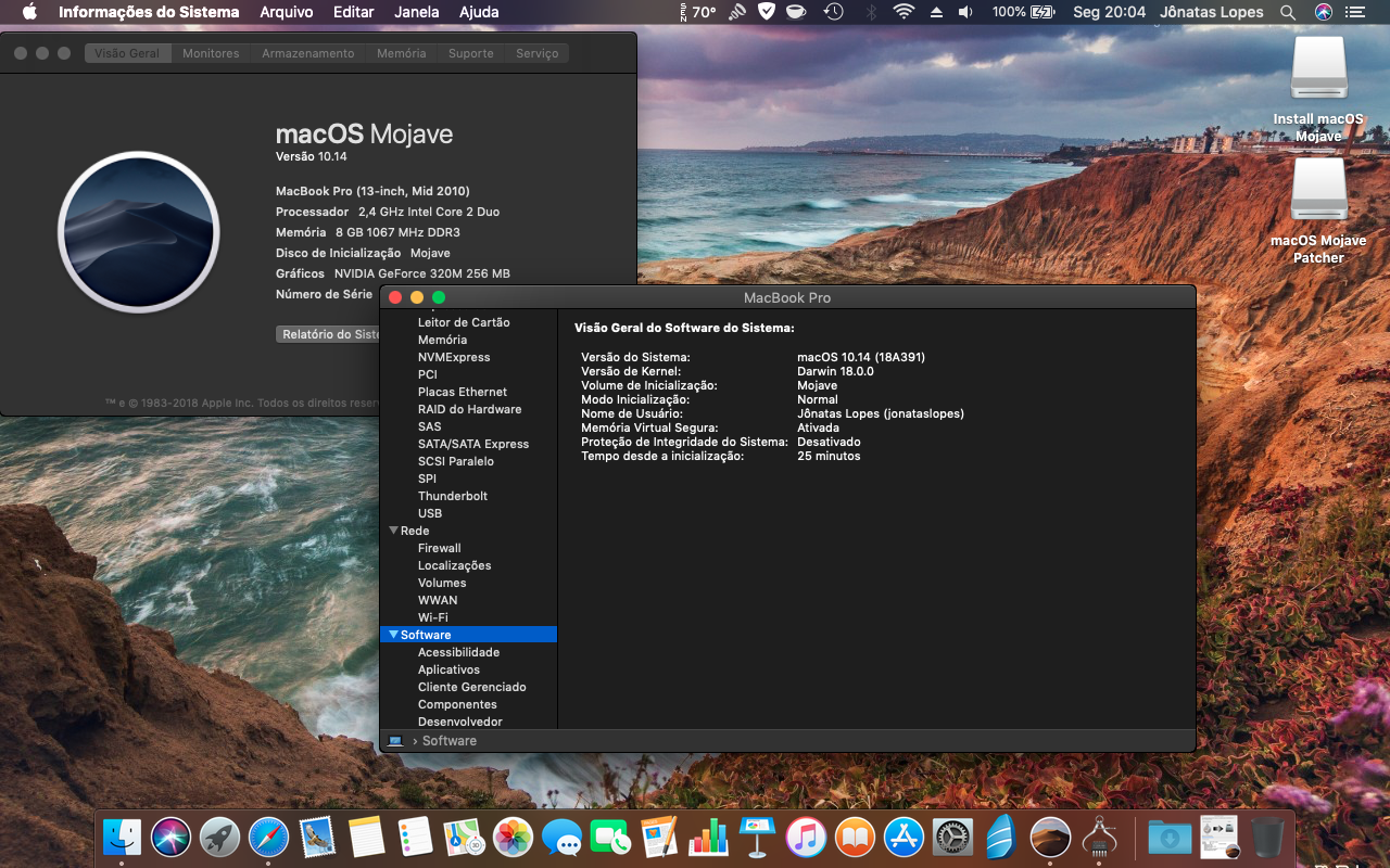

Success for me :
- Download Mojave 18A391 installer
- Patch it with @Dosdude tool (V 1.2.1)
- Intall and post-install patch over the Mojave GM 18A389
- Now all is running fine on 18A391
nota : I do not use Night Shift because I prefer "f.lux". I know @dosdude1 is working on a new night shift patch for the patch updater : am I right ?
Many thanks !
I did, just tried without to see results. Same here I disabled all except "check for updates"

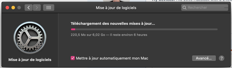

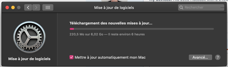

Hi,
Just to say I'm running Mac OS Mojave update final release (18A391) with no issue.
Go first to App Store (or even Apple.com first) then redirected to Pref. System Software update.
Hope everything works good as previous version (18A389)…
