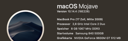

(MBP5,2 17", 10.14.4 on an external SSD with APFS, APFS ROM patch applied. Installed with patcher 1.3.0 over 10.14.3, then applying all proposed postinstall patches but APFS, then all proposed patch updater patches: Nightshift, Siri, iSight.)
EDIT: after some 7hrs of smooth daily work with the 9600M GT GPU I switched back to 9400M to see what happens. Switching requires only logout/login to take effekt. I did not observe kernel panics within 15min after switching. I then rebooted and soon got several KPs (about 10min mtbf).
Now again using the 9600M GT, smooth running so far even after rebooting.
EDIT2: after a while of running with the 9600M GT, I switched to 9400M with logout/login, without rebooting. Still no KPs after 30min... and 11hrs.
EDIT3: now observed KPs in 9400M mode under graphics load from Quicktime player. Stable only with 9600M GT.

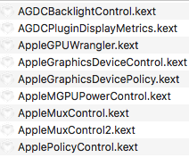

Macbook Pro (6,2) 15" Mid 2010 i7 2.66ghz, Samsung 860 EVO SSD
About my experiment, discovering that using the previous "GPUWrangler.framework" lets Mojave 10.14.5 beta1 booting (even w/o 10.14.4accelpatch), digging its dependancies, I found that the "AppleGPUWrangler.kext" is contained inside the "Plugins" folder of /S/L/E/AppleGraphicsControl.kext
I suspect that this could be one of the reasons why OpenGL Acceleration failed loading from 10.14.5 beta 1, I've already tried to replace it with 10.14.3 one but I get "omitting errors" from the prelinkedkernel building, so unusable, I'm trying to figure it out.

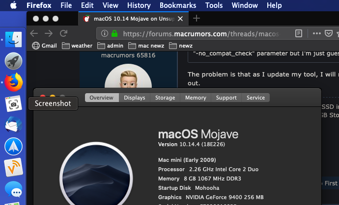

With 18E226 still get random KPs shortly after reboots mostly while in the Finder, Mini3,1 reboots without the chime and runs fine thereafter for a day or more, sleeps and generally behaves until a restart. Then, more than one KP. Ran as perfection on 10.14.3. All patches up to date, Video Accel working.
So far random KPs have not resulted in lost work.
Quandry.
p.s. That's Dark Reader in Firefox, save your eyes.
Quandry.
p.s. That's Dark Reader in Firefox, save your eyes.View attachment 829449

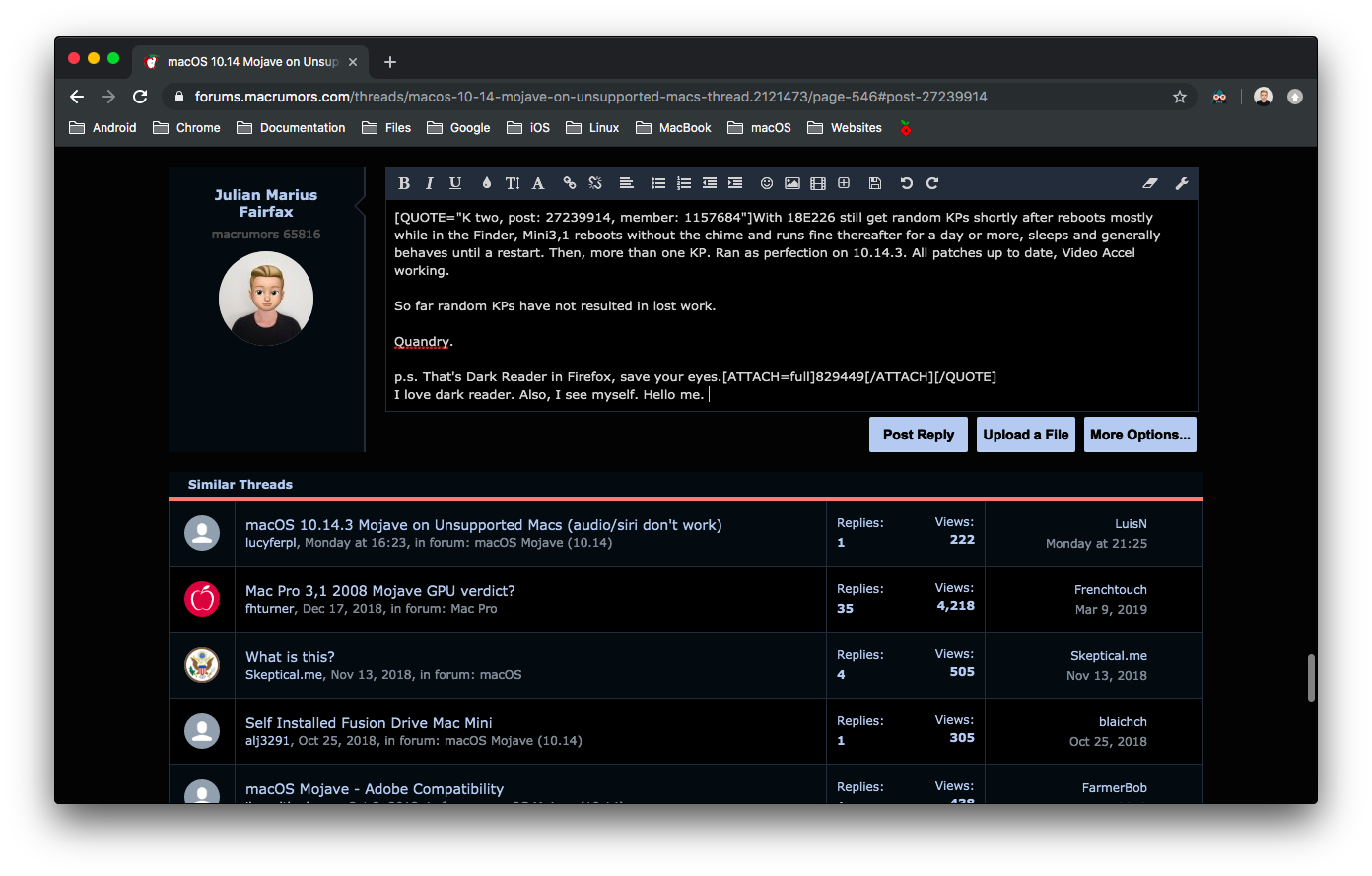

I love dark reader. Also, I see myself. Hello me.
I can never get that working with macOS Installers. Much less a patched one.
