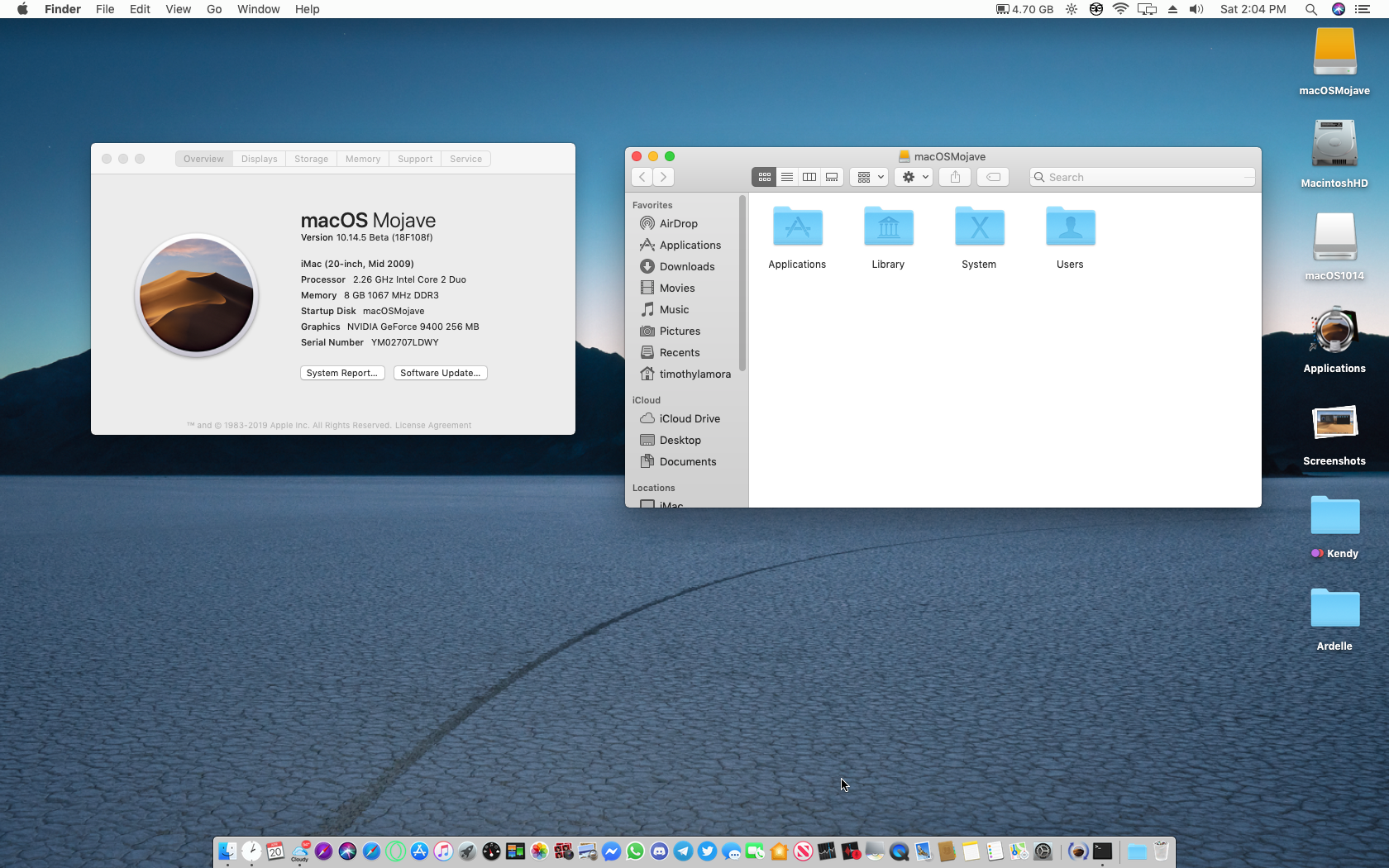

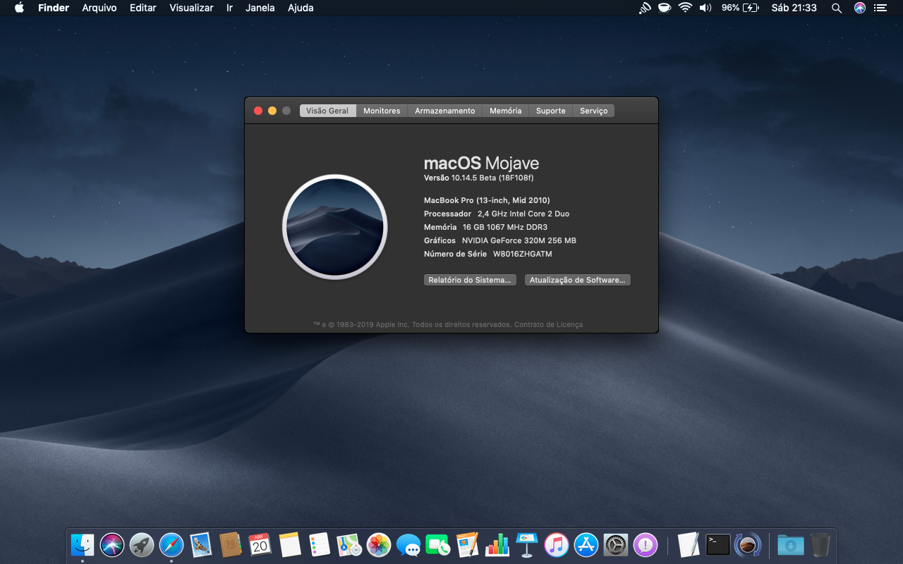

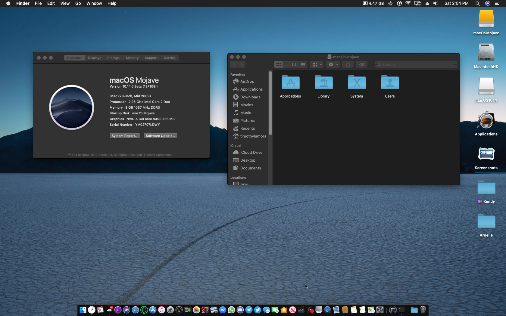

@dosdude1
Just an FYI.
Not sure why, but it seems like either .3 or .4 CoreDisplay can OpenGL accelerate .5b2.
I've tested and verified twice (@ASentientBot can confirm)
I've added .4 CoreGraphics to the mix and it is also supported, but I'm not sure what the value add is right now.
BTW a .4 set (CoreDisplay,OpenGL and GPUSupport) will still break - kind of expected that but just took another stab at it.
That's all for now.
Moreover if he adds simply .4 CoreDisplay.framework on his current 1.3.0 Mojave Patcher to "Video Patch" it doesn't affect nothing bad on 10.14.4 and it becomes ready also to fix directly every eventual 10.14.5 beta update.
Reactions: avz and webg3

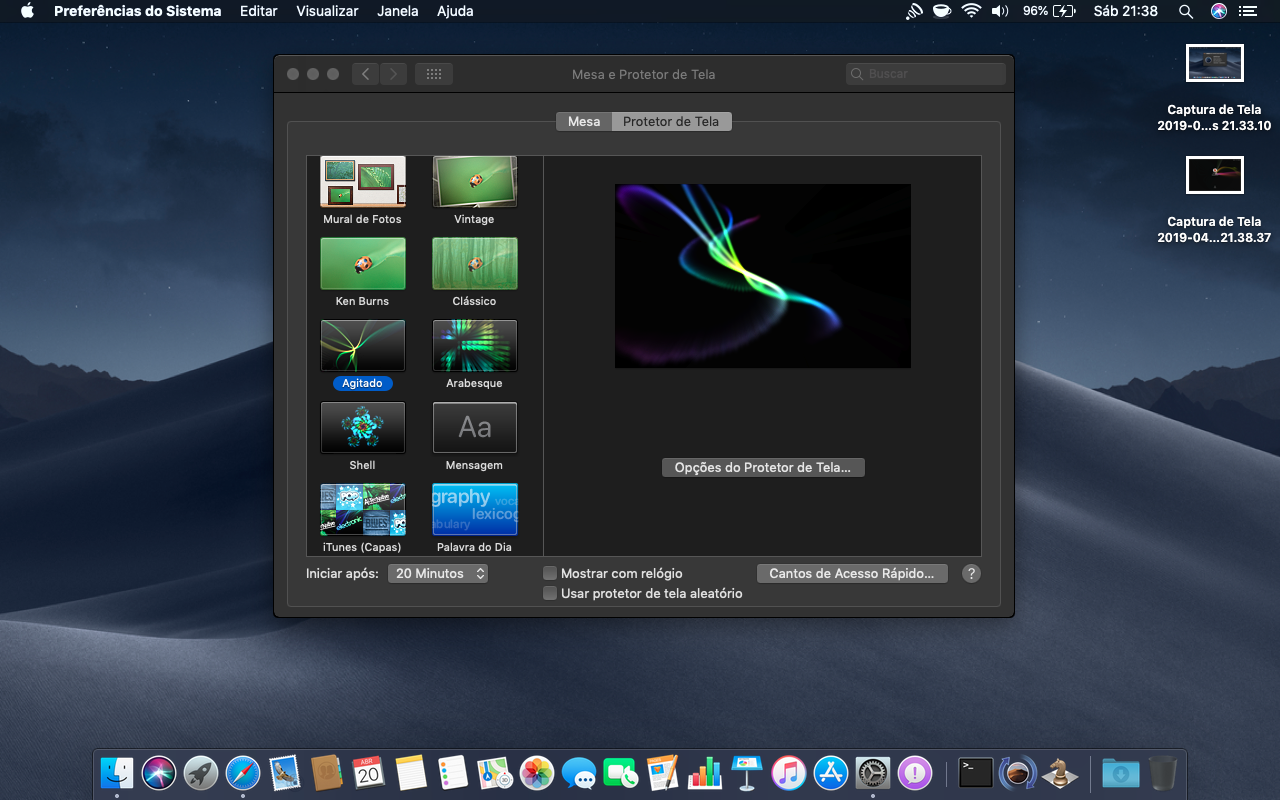

I replaced the coreDisplay then applied the post install patches this what I have for 10.14.5 no graphics acceleration and backlight

- Download this CoreDisplay.framework.zip and keep it in your Downloads folder
- Using the dosdude1 Mojave Patcher version 1.3.0 , prepare a Mojave USB Installer
- from your current Mojave update OTA to 10.14.5 beta2
- After OTA you can almost surely reach desktop without any patches, and from there replace the Downloaded "CoreDisplay.framework" into your /System/Library/Frameworks/
- Reboot into dosdude1's Mojave Post Install and apply patches for your machine with "Force cache rebuild" checked.
At next reboot you should have OpenGL acceleration

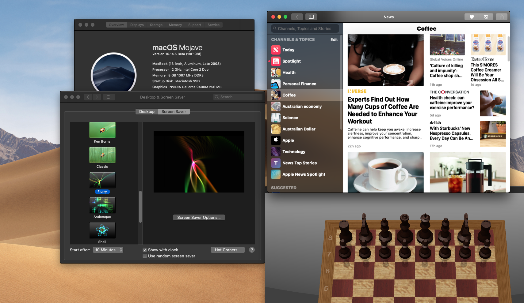

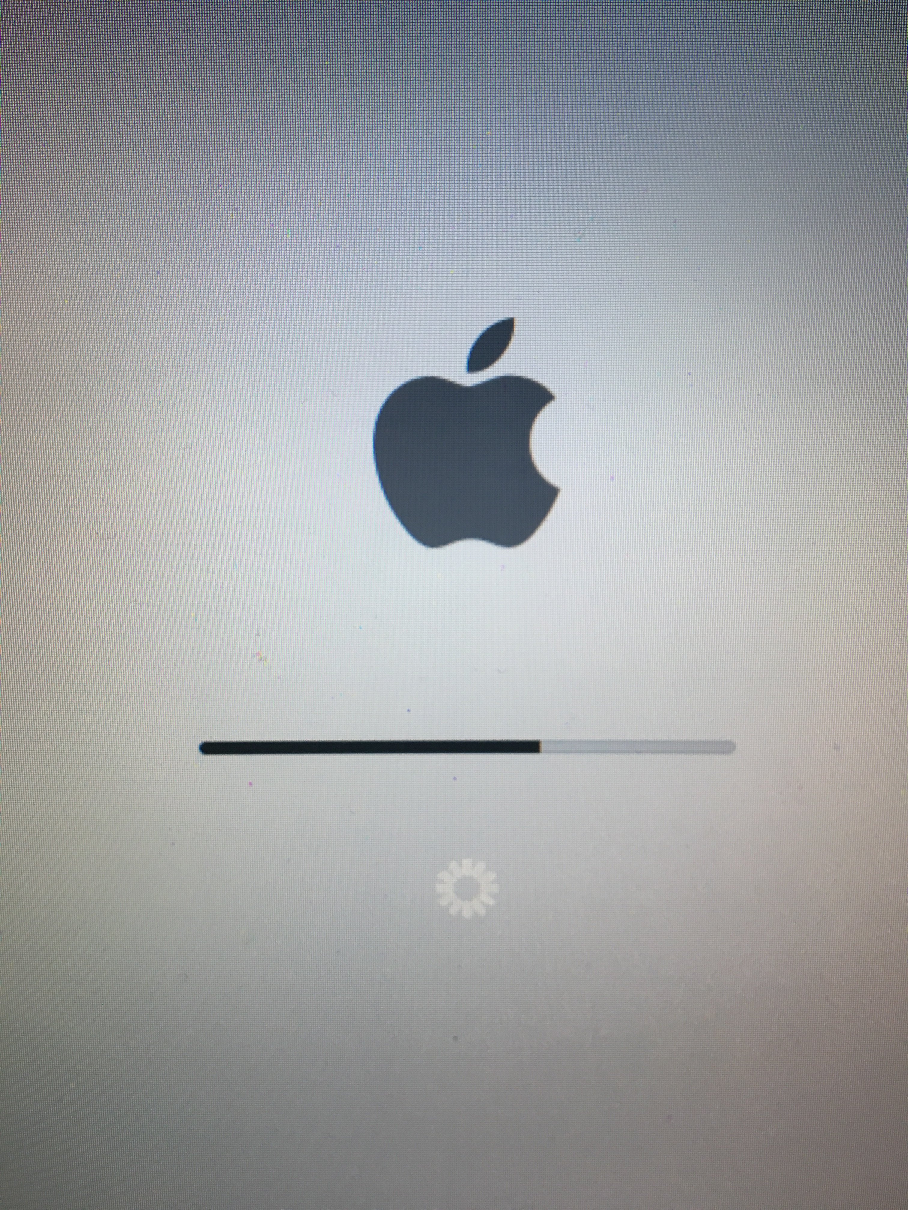

So I enrolled my MacBook5,1 in a Beta program and updated my system from 10.14.4 to 10.14.5 b2 (hey, it's free). After the OTA update I only applied plist/platform check patches(so I could probably have used the very early and basic Mojave patcher). After renaming GeForceTeslaGLDriver.bundle in a Single User mode I landed in a Desktop without graphic acceleration of course. I was very surprised at how snappy the system was even without graphic acceleration(as jackluke already noted previously). The only patches that appeared to be noticeably broken by the update is a legacy audio patch/Night Shift/Hybrid. Clamshell mode is alive and kicking although I am now questioning the practicality of it as Core 2 Duo machines do run pretty hot and it does not take long for the fans to kick in while watching YouTube(in a clamshell mode). When the MacBook lid is open on the other hand it runs much more cool and quiet.
