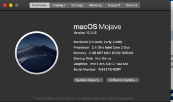

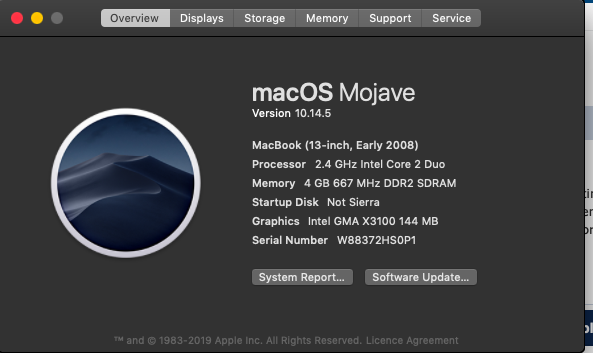

Hello everyone,
I've managed to get Mojave 'working' on a MacBook 4.1 ( early 2008 A1181). Logging in ( or booting with auto-login ) is very very slow but once things get started the system is sort of usable. Same long wait if you lock the screen and then enter your login details. Wifi works. I had a look through the system.log and have disabled services here and there. Adding a new user is very slow so perhaps there's an issue with App Store / Credential manager. Has anyone else here had experience of Mojave with early 2008 MacBooks? If so any tips on performance tweaks would be greatly appreciated.
Thanks
Cheers
S
PS Sierra runs pretty well on a MacBook 4.1
