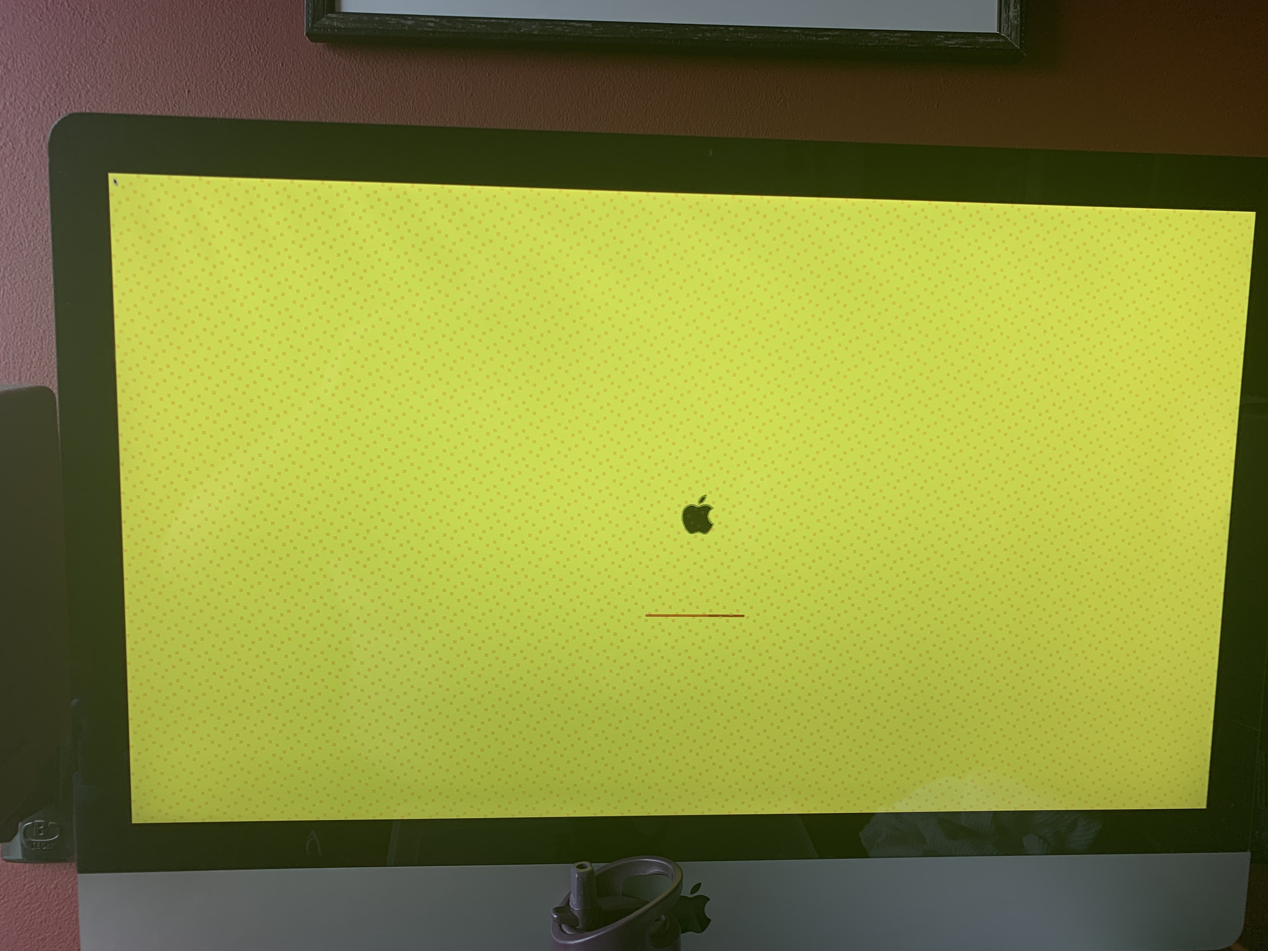

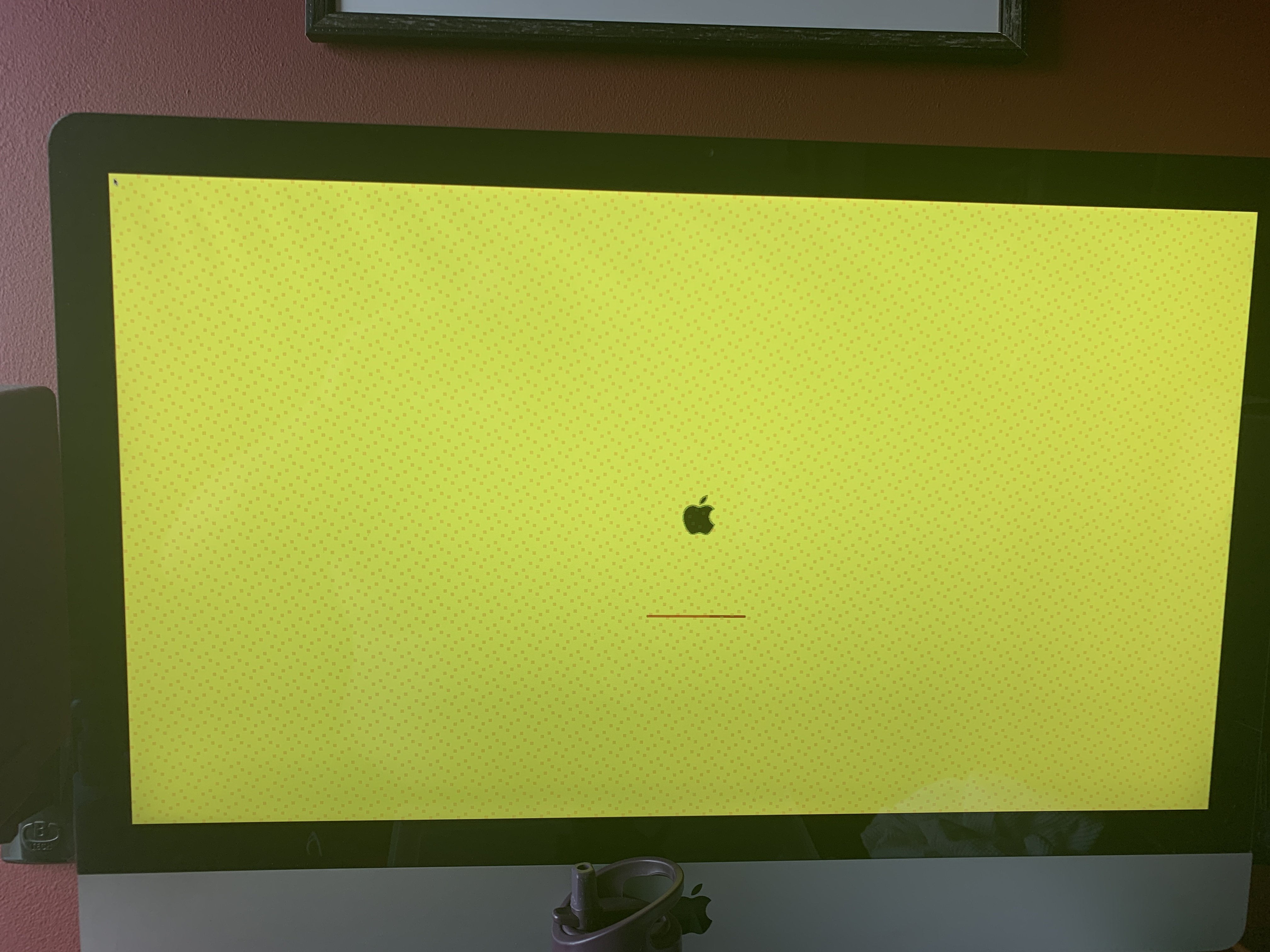

I did the install following the directions, the screen looks fine during the install, but after I do the Patch tool, I get the Apple logo and loading bar, followed by this:
Ive had an issue before with Mojave. After I installed it successfully, and after working fine for about a month, the screen would flash like the yellow image above, restart, then just go blank after the Apple logo appears. Is this a video card problem?

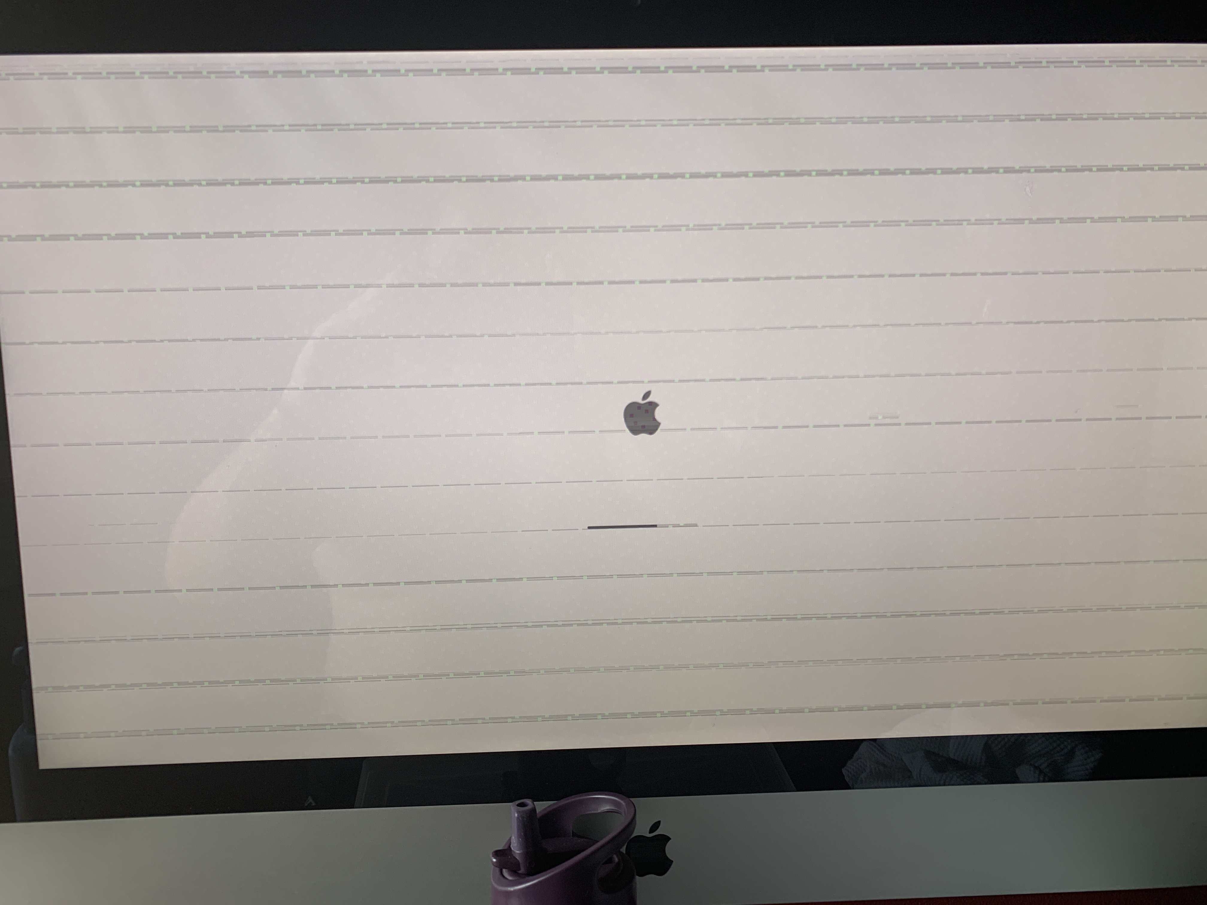

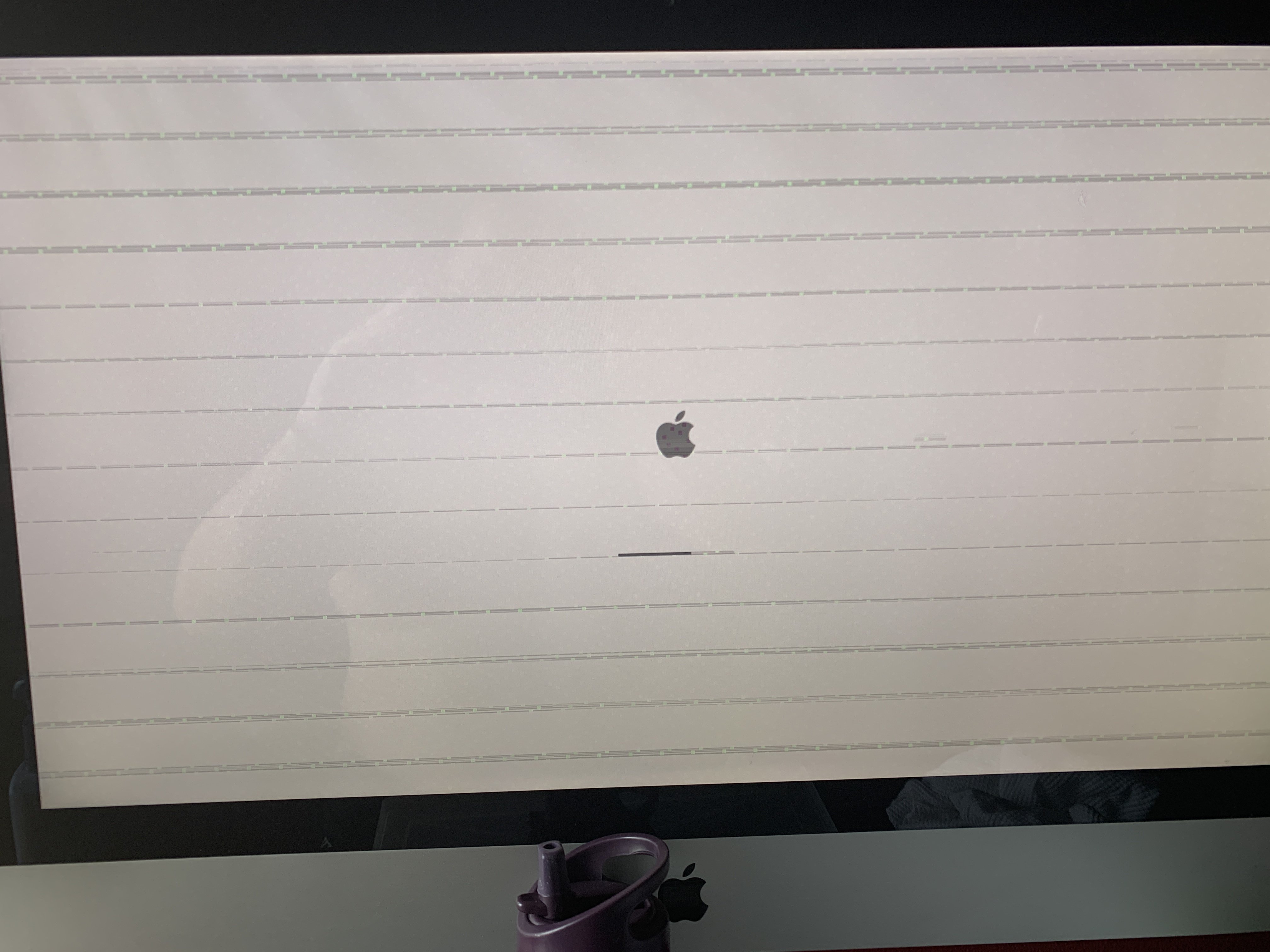

View attachment 849407 View attachment 849408
Your GPU is dying.

Yay! I figured so. The only question I have regarding that is why would everything work fine, and look fine, when I am installing the OS, but I see the issue only when it gets to the Apple logo/status bar?
I think Im going to go with this card here if it is failing:
https://www.aliexpress.com/item/32826279297.html
Radeon HD 5xxx and 6xxx series cards don't work under Mojave (not to mention they are some defective garbage). Either get a Radeon HD 4xxx series iMac video card, or get a better nVidia PC MXM card to upgrade with.

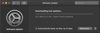

You should be able to download OTA its only 2.4 GB for me on my iMac
