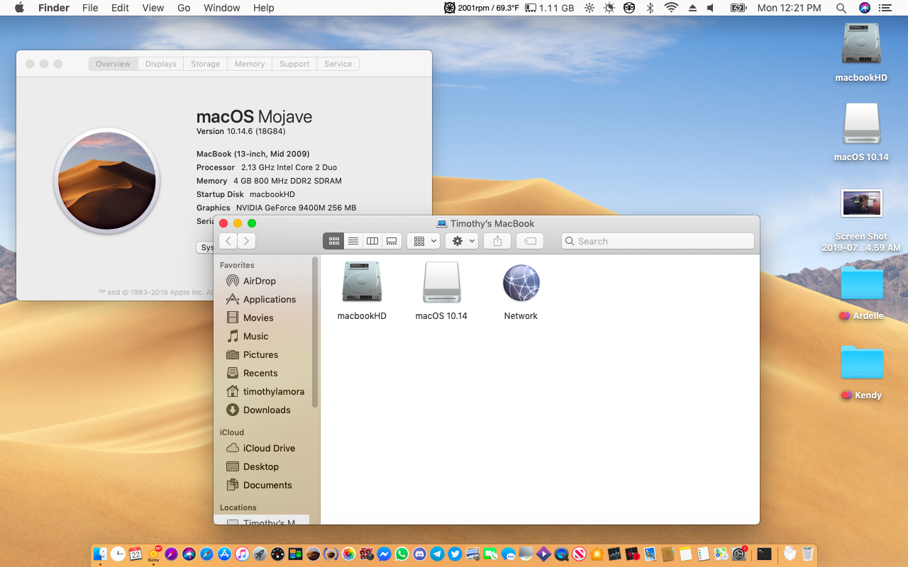

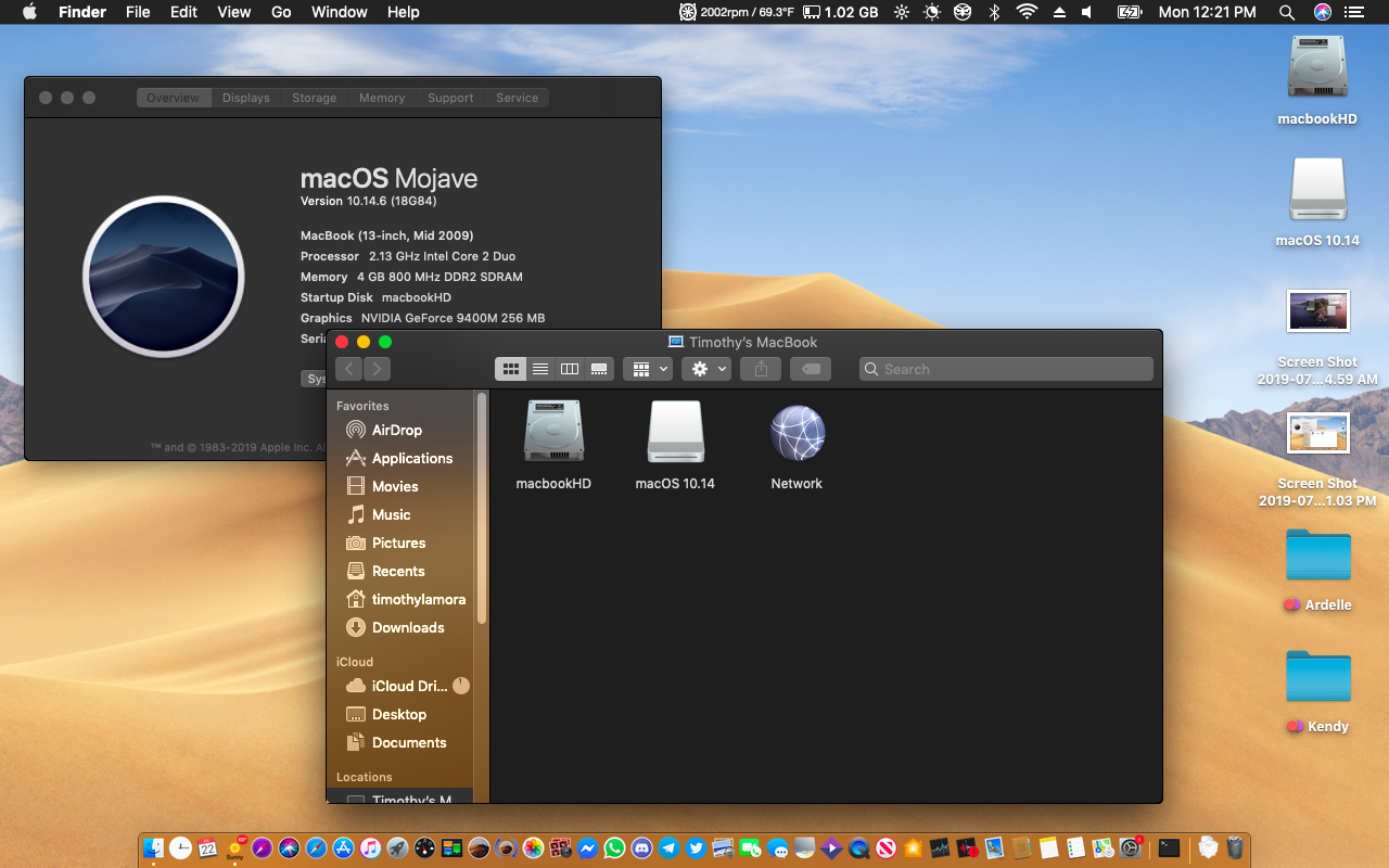

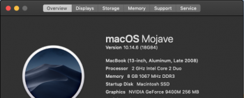

It should download 10.14.6 with the patcher soon going to try downloading it see if it is ready with the patcher will let you know I did mine OTA Successfully and the Hybrid patches and News+ are working :)
So it seems you have a APFS formatted HD/SSD and your update function works.
With the HFS-Extended Journaled HD the OTA is not working, what I knew.
I'm not in a hurry, but I would like to know when it will be possible to update via the dosdude installer.
Patience.
All systems are working well.;)

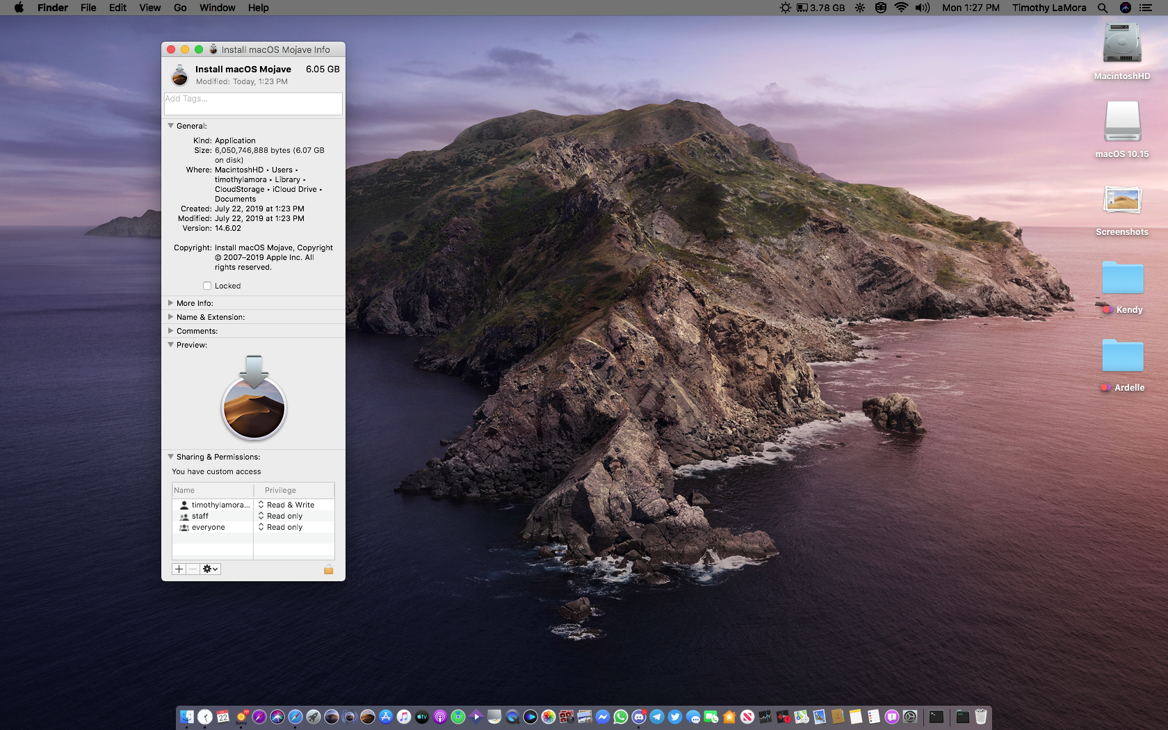

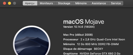

I left a message for doused on discord as I downloaded macOS Mojave using the patcher and this is the version it downloaded
Reactions: Pralaya
Yay! I figured so. The only question I have regarding that is why would everything work fine, and look fine, when I am installing the OS, but I see the issue only when it gets to the Apple logo/status bar?

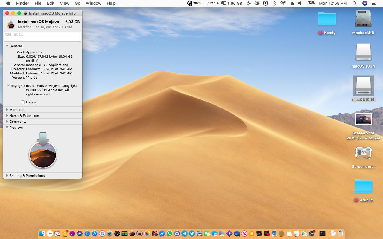

Yes it should download the current as I just downloaded macOS Mojave on my iMac and version numbers are correct just the date is wrong on my MacBook 5,2 even thought the time and date are set correct

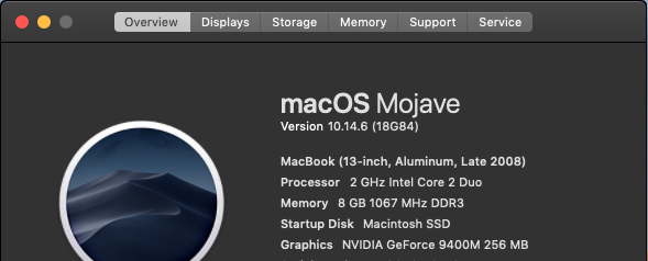

Updated my MacBook5,1 to 10.14.6 Final via OTA and then did the manual patching. The system did not boot at first but I kept my cool and the system restarted itself for the second time and successfully landed at the login screen.
Reactions: TimothyR734
