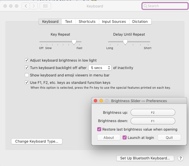

Hello friend,
I appreciate the response. I have been using the app for over a week now.
I have the keyboard mapped to dim with option+1 and brighten with option+2
Would like to take it to the next level and use the actual F1 and F2 keys if possible. 🙂
UPDATE as of March 5, 2021:
After looking around I found a way to use the F1 and F2 keys combined with this brightness-slider.app
For now I think its time for me to put this subject to rest. Hopefully this can help the next Padawan

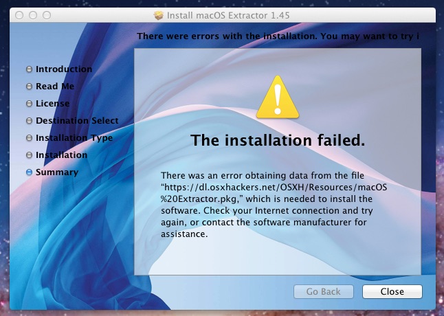

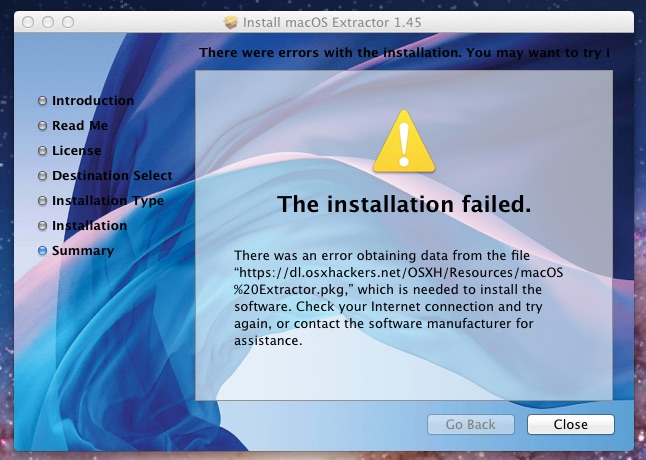

But Mojave patcher doesn't list the 2007 MP as supported? Extractor does, so I'd like to try that instead of turning my focus to Mojave Patcher.
So has anyone successfully used Extractor lately? Would anyone know why early on in the process, it tells me
The installation failed.
There was an error obtaining data from file "https://dl.osxhackers.net/OSXH/Resources/macOS%Extractor.pkg,"which is needed to install the software. Check your internet connection and try again, or contact the software manufacturer for assistance.
Edit: Dead link here, too. Perhaps the app has been pulled? I found it. Using Safari, go to - https://dl.osxhackers.net/OSXH/Resources . it's the second to last entry.
I had found that directory in my browser too, but the web installer takes more steps than just running the Extractor.pkg package. Do you know what to do after running Extractor.pkg?
I have also messaged Isiah Johnson about this 4 days ago btw. As you get a garbled link too (and I strongly suspect it's just that comma included at the end of the url, see screenshot), it seems like something he might want to have a brief look at.
I know nothing about this product, but I noticed that the URL is invalid (a single '%' can't appear alone like that). Try https://dl.osxhackers.net/OSXH/Resources/macOS%20Extractor.pkg instead.
(Copy and paste the URL; MacRumors keeps mangling it if I make it clickable.)
Thanks for your reply anyway. 🙂
I will check the web installer and see what's going on. Since macOS Extractor is no longer in development, I strongly recommend using RMC's Patcher
Reactions: K two
Thanks, that would be great.
I've used RMC's Patcher already on another old Mac, but it doesn't support the 2007 MacPros that Extractor does list as supported. It's that capability that I'm after right now. So I think I need specifically Extractor for that.

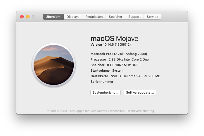

Hi macrumors community,
following this thread now for a long time and very happy to teleport my 2009 MacBookPro5,2 into the present using Mojave.
Unfortunatly I am struggeling for some weeks/months now with randomly reboots or system freezes during sleep/wake which can be solved only by hard shut-of (long pressed power button). It seems to be linked to GPU somehow (Suspected bundle: com.apple.iokit.IOGraphicsFamily). Sometimes I also had a reboot (famous boot sound "biiiiiing") with closed laptop lid. I attached system info and console log file from latest reboot.
Anyone else had this before, any idea or hint how to fix this issue?
I am happy for any hint,
cheers,
Mike
cheers,
Mike

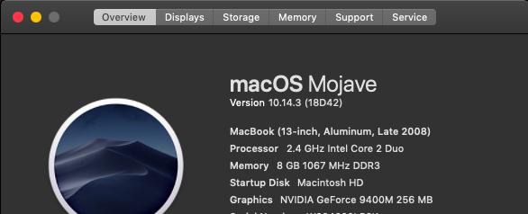

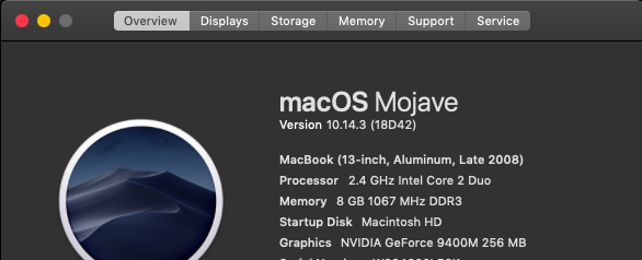

I installed 10.14.3(18D42) on one of my original HDD's formatted as HFS+ and have to say that it is perfect: minimalistic patching required(as OpenGL fallback support is still present and is very solid), no aggressive RAM caching of later versions, HFS+ ensures that no unwanted updates will ever happen while critical updates like XProtect and MRT are still happening. App Store seems to be working well. I believe that if Apple were to support Mojave on a Late 2008 MacBook, this is where they would stop.
The "%20" is code for a "Space", take out the space in the file name that shouldn't be there for a link. No one is mangling the URL, it is just created wrong.
You are correct that "%20" encodes a space. However, https://dl.osxhackers.net/OSXH/Resources/macOS%20Extractor.pkg is a perfectly valid URL, spaces are allowed (although sometimes troublesome, like this one). The problem is that on MacRumors, one must use the [icode] tag (or similar) to encode it; when making it a clickable inline link, MacRumors always decodes the space but doesn't re-encode it, making the link invalid (hence my "mangling" comment).
(Sorry for the off-topic discussion, I'll drop this now.)

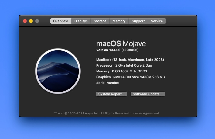

Updated this Aluminum MB5,1 with SilentKnight to the current Security Update 2021-002, MRT, X-Protect and EVERYTHING works perfectly after v.1.3.7 patches, re-applied. These are great old MacBooks.

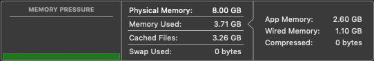

On my 2010, the second 10.4.3 update had that RAM issue where it would get gobbled up faster and performance was more sluggish. For older machines, staying on the first 10.14.3 and earlier was the way to go.
