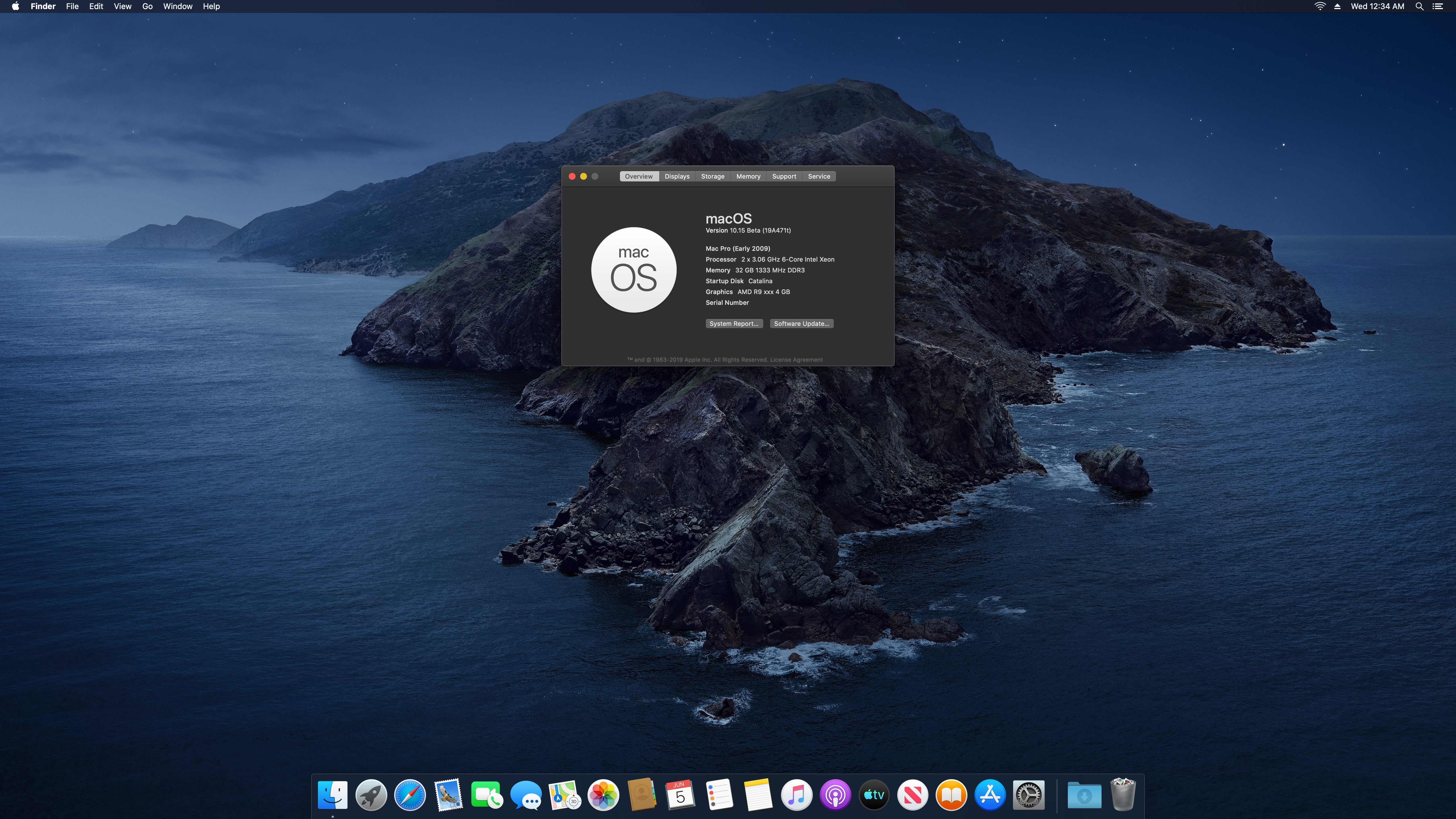

Thanks to @tsialex's guide, I can confirm the MacPro4,1 converted to 5,1 does, in fact, run Catalina Beta 1 with the only change being made is in the NVRAM to avoid the compatibility check. Once that was set, the machine booted right up into Catalina DB1. I hope it stays like this, as the machine is singing with Catalina. Worth noting that I have an upgraded AirPort Card out of either a Retina MBP or iMac (I cannot remember) with BT4.0 and 802.11ac and have had no issues connecting my keyboard and trackpad and connecting to WiFi.
EDIT: it just KP'd right as I hit send on the original message, so while it's running well it's certainly unstable. It did send the report automatically to Apple and it did notate the boot-args so I'm hoping it just gets overlooked. I'd be very mad at myself if that was the report that killed this entire project lol.

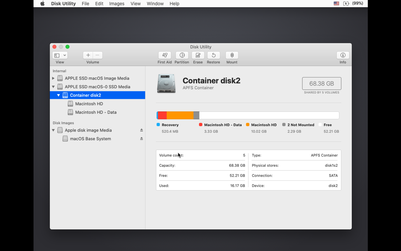

@jackluke I booted into Recovery in a Virtual Machine, and you were right. There are 2 APFS volume in a container.
Yes, practically before Catalina the main APFS structure was made by 4 Volumes:
Preboot, VM, APFS Recovery, APFSSystemLabel
with Catalina they introduced a new 5th APFS volume that is "APFS Data" which as already seen contains "Users and Device (Users) Library".
But I noticed the "APFS Data" also contains the root "/" of Catalina, I mean since I cloned a previous Mojave to an SSD and then OTA upgraded to Catalina, I remember I had on my previous Mojave root "/" some folders and files, and I found them all back on the "APFS Data" root "/".
But I have one more observation, since on Mojave we have seen that was been possible an HFS+ Installation, considering that previous APFS scheme was: Preboot, VM, APFS Recovery and APFSMojaveLabel
and when performing and HFS+ Installation "Preboot+VM+APFSMojaveLabel" were combined in one only "HFS+ Mojave Volume", while "APFS Recovery" was turned in "HFS Recovery HD", at this point I guess it's not so impossible to attempt a Catalina HFS+ Installation.
