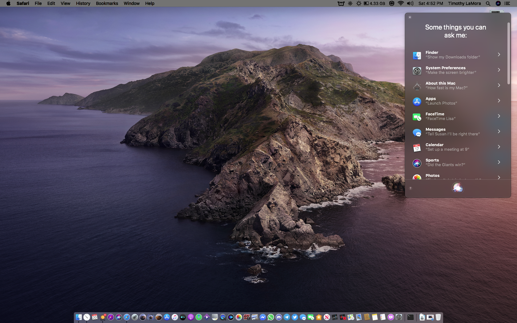

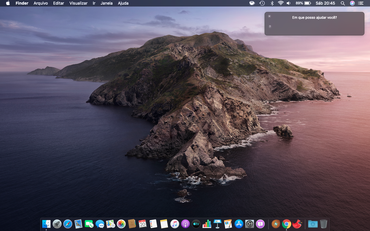

Any news about the waves calling Siri? I'm using that fix that popped in here, and it was before I applied Beta 4, yet she kept Siri running.
As far as I know that waves are broke but if you let it go a bit long the Siri logo at the bottom is animated

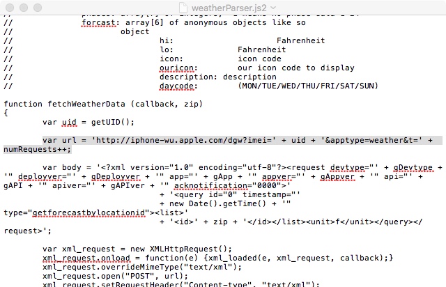

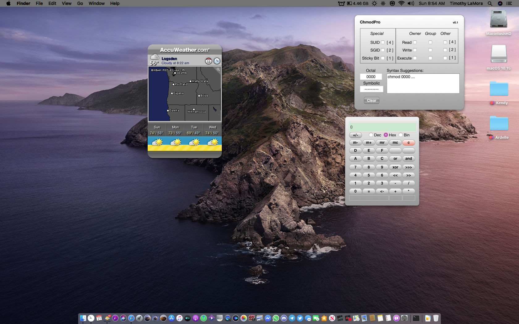

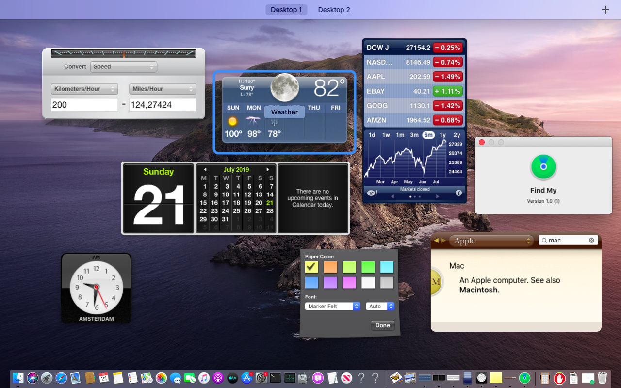

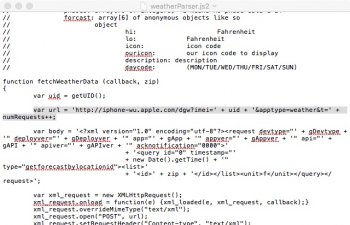

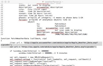

You can get the original widget working instead of using the Accuweather version:
https://forums.macrumors.com/threads/weather-widget.2175154/page-3#post-27548671
Should have said this earlier. Tiger or Leopard Weather Widget and parser file works up to Sierra. Don't know about High Sierra as I skipped that but L Caputo explains using the Tiger/Leopard Accuweather parser file with the original Mojave Weather Channel/Yahoo widget.
I confirm that method works on Catalina too, infact in Tiger/Leopard apple used as Weather API the AccuWeather (still showed to work using the previous third party widget uploaded), while starting from SnowLeopard they used the Yahoo Weather API (now disabled).
So using the weatherparser.js from Tiger or Leopard will work on the other macOS.

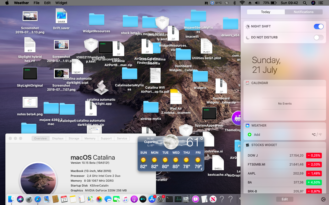

Here is a working example on Catalina, they are all .wdgt converted in .app but got a similar old dashboard effect using a desktop-space, the proof it's Catalina is that I left opened "Find My.app" the new Catalina beta4 app recently released for Mac.

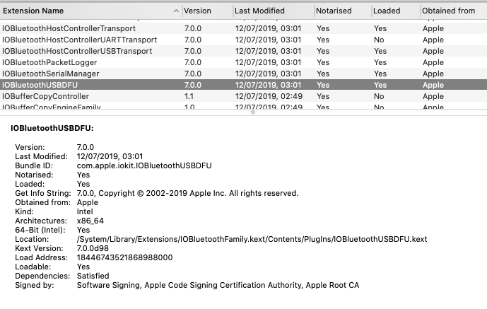

IOBluetoothUSBDFU is loaded. This is with the CAT install over my working copy of 14.5 (cloned). Will get back to you with the results of the clean install - just need to swap over the SSD. Unfortunately I cannot 100% remember if it was ok for the earlier betas but I normally have a look at all the system preference options after an install.
Edit: Just changed SSD for you. Clean install of B4 still has IOBluetoothUSBDFU loaded and trackpad preferences working. This is really odd that for some it is not working.
If a clean install breaks the Trackpad system preference panel, try going back to the upgraded Catalina and create a new user account to test if this breakage can be triggered by forcing the panel to regenerate its preferences.
