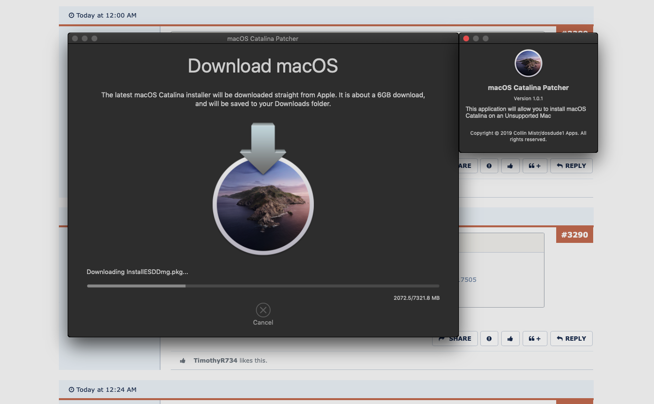

@dosdude1 @0403979 @ASentientBot I need help using @dosdude1 macos Catalina patcher and when I try to download macos after a few minutes it says error there was a problem downloading macos please check your internet connection and try again later. Please help! I have used @dosdude1 macos Mojave patcher on this same mac before and never had a problem it is running Mojave right now in fact. The mac I have is an imac 12.2. Please help!
1. Make sure your using the latest patcher which is b11. 2 . If you are using wifi make sure you are connected to the one that is from your ISP. 3. If that fails try rebooting your router. 4. If you have an ethernet cable try hooking up to your router wired and trying that.

@TimothyR734 I can only use wifi (I have Xfinity I can usually get 100 mbps) I do not have an ethernet and I am using the latest patcher because I downloaded it today. What do you mean make sure I am connected to ISP 3? This is also my only mac all my other computers are windows although I do have an iPhone and multiple ipads I don't know if that will help or not. Thanks for trying to help!:)

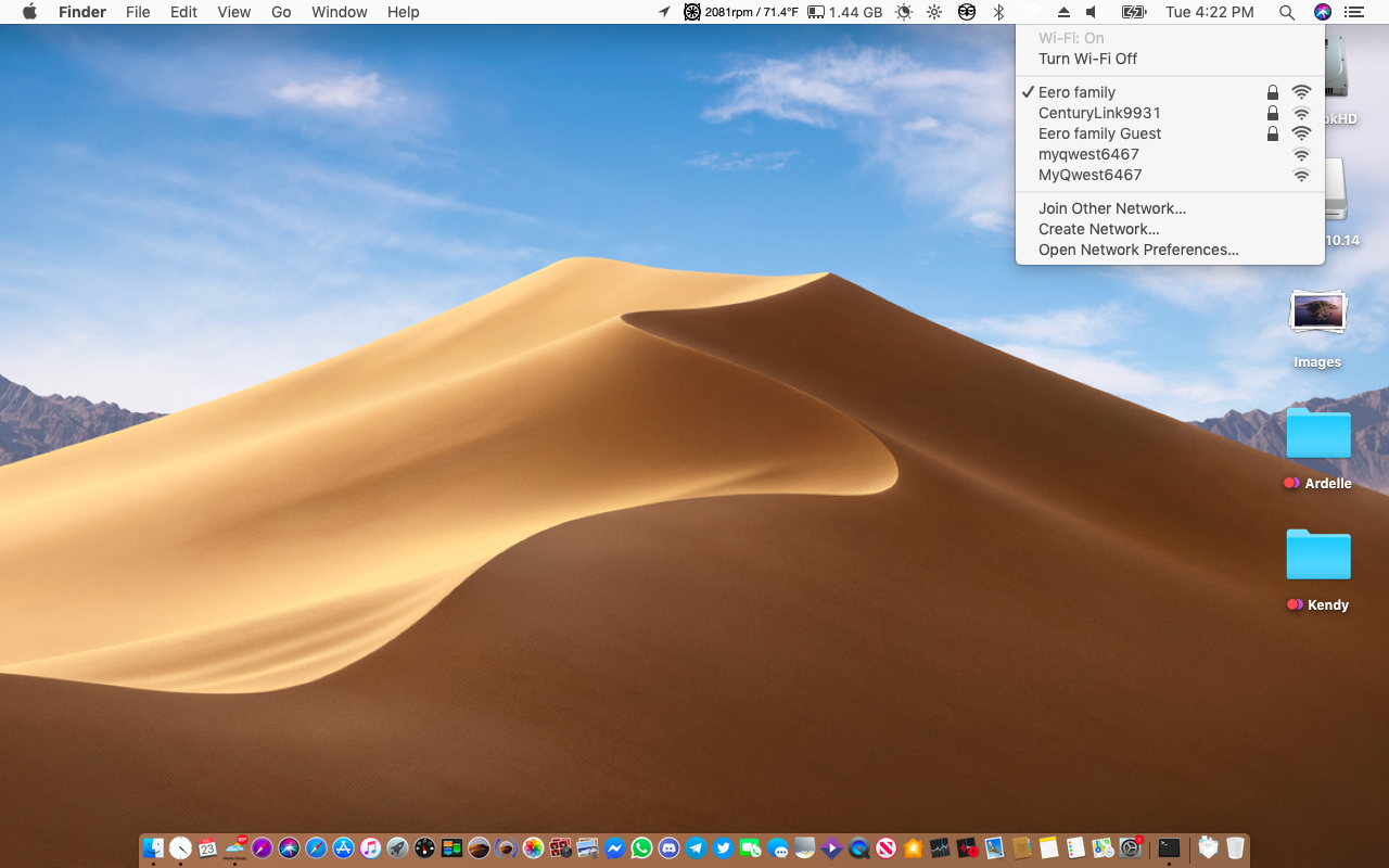

Check system date and time, also ensure your machine has enough space to download everything.
System date and time is correct and there is enough storage on the mac. I have macos Mojave installed on the mac right now, I downloaded and installed it 3 or four months ago with no problem with your macos Mojave patcher. I do not know why there is an issue downloading Catalina The mac is an imac 12,2 Thanks @dosdude1 for trying to help me solve the issue!:)
Are you enrolled in the Apple beta software program maybe that might work

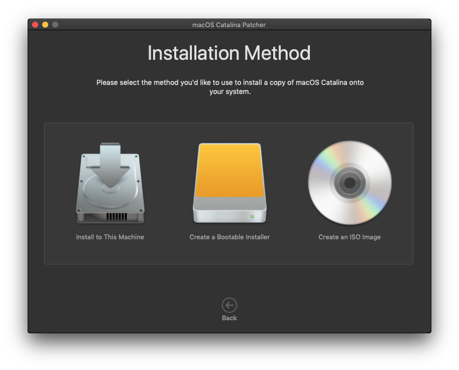

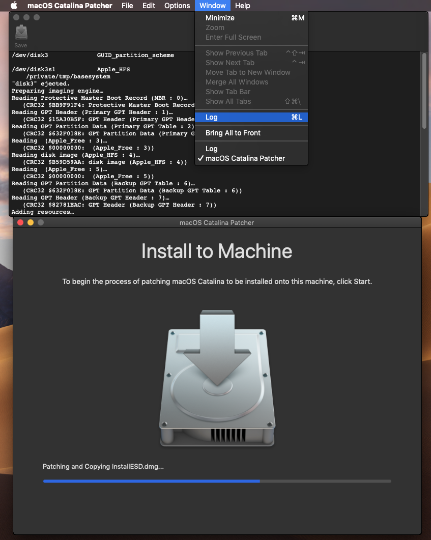

I've just released a major update to Catalina Patcher (along with a completely redesigned webpage as of a few days ago)! With this release, I have finally brought Catalina Patcher out of beta stages! All installation options are now fully implemented, finally bringing the program up to its full intended level of functionality. I have also implemented a logging feature, to more easily debug issues that may occur.
Please note, though, that at this time, the in-place installation method will only work on machines that have native APFS BootROM support. The external installer volume and ISO image methods will work on systems that do not have APFS BootROM support.
Enjoy, and of course, please report any issues!

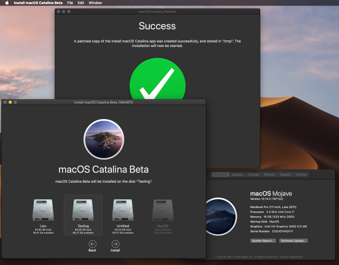

Has anyone got Catalina successfully running on 17" MacBook Pro Late 2011 (8,3) yet?
Yes, spuhead, but as in Mojave, dedicated GPU is disabled.

That is so great, @dosdude1 . Thank you so much for your work. As I have to install B4 in my Macbook Pro 2011 17, gonna try it right now
By the way, I sent a donation yesterday. Hope you receive it soon.
