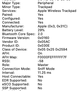

What do you have for the Bluetooth fields...
Chipset: 20702B0
Firmware Version: v150 c9317
If there really is a difference at play here, we should see a pattern on those values for the ones that are working.
Exactly the same. Here are the fields for the trackpad.

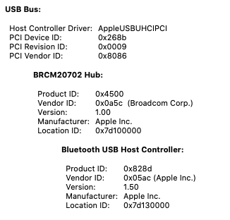

And the USB for the card.

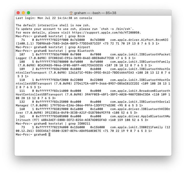

IOBluetooth*.kext are all Catalina B4 - dated 12 Jul. Here is the output requested. Airport did not produce an output. Hope they may be of use.
It's case-sensitive you should type "AirPort", but the result for AirPort and Brcm is the same.
I confirm that you are using the stock Wifi/BT kext Catalina beta4 (19A512f), I've compared with a supported Mac of mine and they match exactly:
AirPortBrcm* driver version: 1400.1.1
IO80211Family* driver version: 1200.12.2b1
IOBluetooth* driver version: 7.0.0d98
