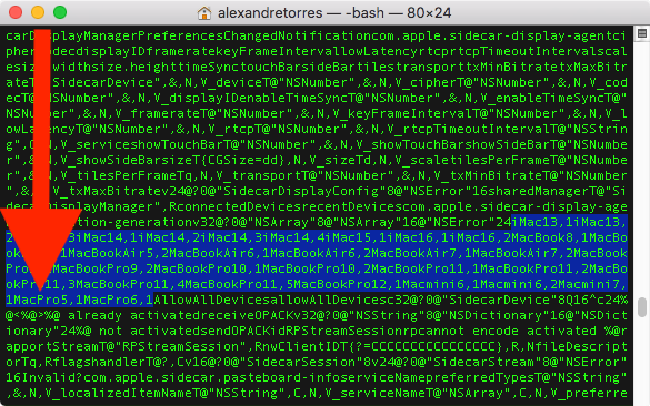

Sidecar requires a Mac with HEVC playback support... to enable it type
com.apple.sidecar.display allowAllDevices -bool YES
HEVC encoding, not playback. Broadwell Quicksync support playback of HEVC but not encoding, that's why only work with Macs that have Skylake or newer processors. iMac Pro have AMD HEVC encode support from the VEGA GPU.
Macs that have Catalina support but do not work with Catalina Sidecar:
iMacMacBookMacBook AirMacBook ProMac miniMac Pro
iMac13,1, iMac13,2, iMac13,3MacBook8,1MacBookAir5,1, MacBookAir5,2MacBookPro9,1, MacBookPro9,2Macmini6,1, Macmini6,2MacPro5,1
iMac14,1, iMac14,2, iMac14,3, iMac14,4.MacBookAir6,1, MacBookAir6,2MacBookPro10,1, MacBookPro10,2Macmini7,1MacPro6,1
iMac15,1.MacBookAir7,1, MacBookAir7,2MacBookPro11,1, MacBookPro11,2, MacBookPro11,3, MacBookPro11,4, MacBookPro11,5..
iMac16,1, iMac16,2..MacBookPro12,1..
The interesting thing is that MP5,1 is there…

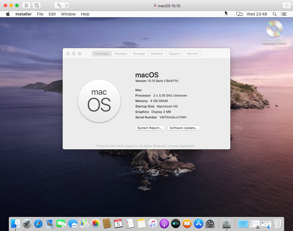

With this github project you'll get Catalina set up in a VM in no time:
https://github.com/foxlet/macOS-Simple-KVM

I got it running on Parallels on 2008 Mac Pro. And Anka Build by Veertu but only on a supported Mac. Tried QeMU seems complex.
