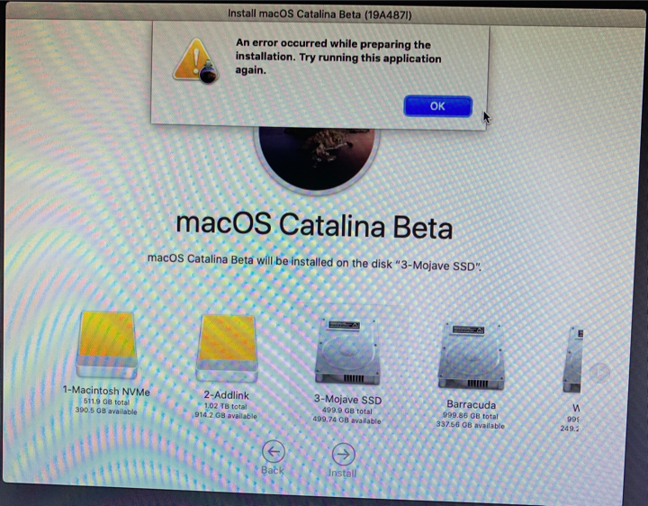

So, I made a USB installer from the latest patcher. Booted into Mojave Recovery, disabled sip, adjusted to the correct no_compat boot-args. and rebooted.
In Mojave, I selected my new patchd Catalina USB installer as the startup disk and rebooted...
I initialized the Catalina install by selecting the "Reinstall macOS" and pointed it to an SATA SSD formatted to APFS.
Then I get this... (I tried several times and gave up, what am I doing incorrectly?)
EDIT 1:
Tried again, same result. Tried installing directly to machine from Mojave, no joy.. Same error...
Deleted everything... I’ll start from scratch again if anyone Presents an idea to try.
EDIT 2:
Resolved thanks to @tsialex - I thought I had the latest patcher/catalina installer but the build number listed right in the window title bar indicated otherwise. I didn't even notice it. After this was pointed out by Alex, I downloaded the newer 1.04 patcher version and pulled in a new Catalina Beta installer. With some small trepidation, I discovered a stuck copy of the older version in my /tmp folder. Once that was deleted, the patcher worked properly, and the install went off without a hitch. I don't believe this stuck file was directly responsible for the original problem, as I use a USB stick for the 1st and 2nd attempts. However, during all these trials, the old patched installer in my /tmp folder became firmly embedded and I had to use a utility to help me delete it. All is well now... Thanks to those who helped.

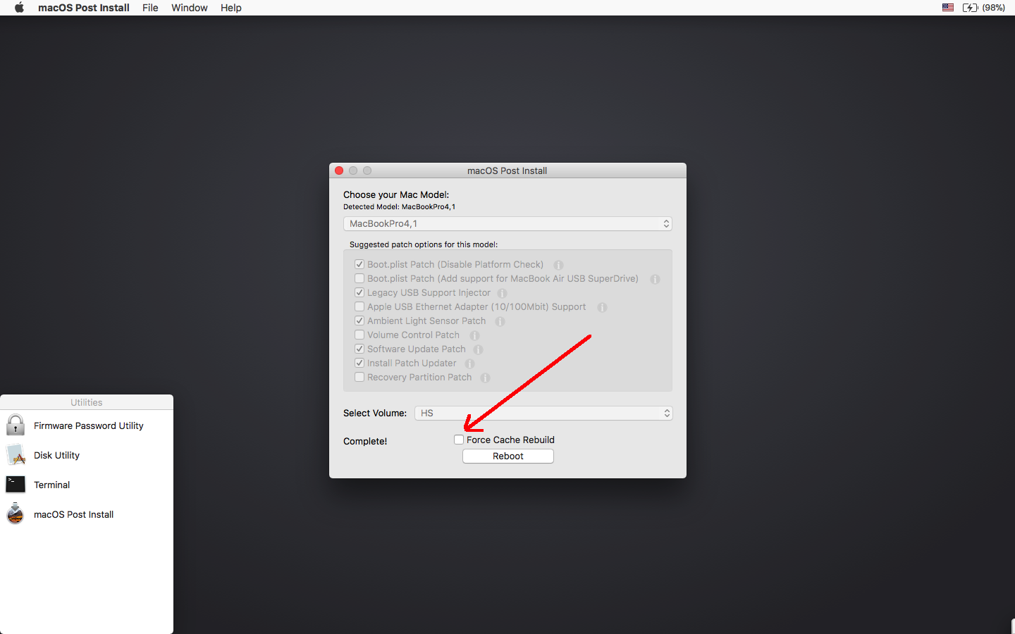

how do I patch the hard drive in APFS? Catalina is installed on an APFS partition
You have to boot from the patched usb installer that your created to install patch Catalina in the first place. When booted, select the 'macOS post install patcher' option in the list. Also, you will need to check the 'force cache rebuild' checkbox when it appears after the patching occurs.

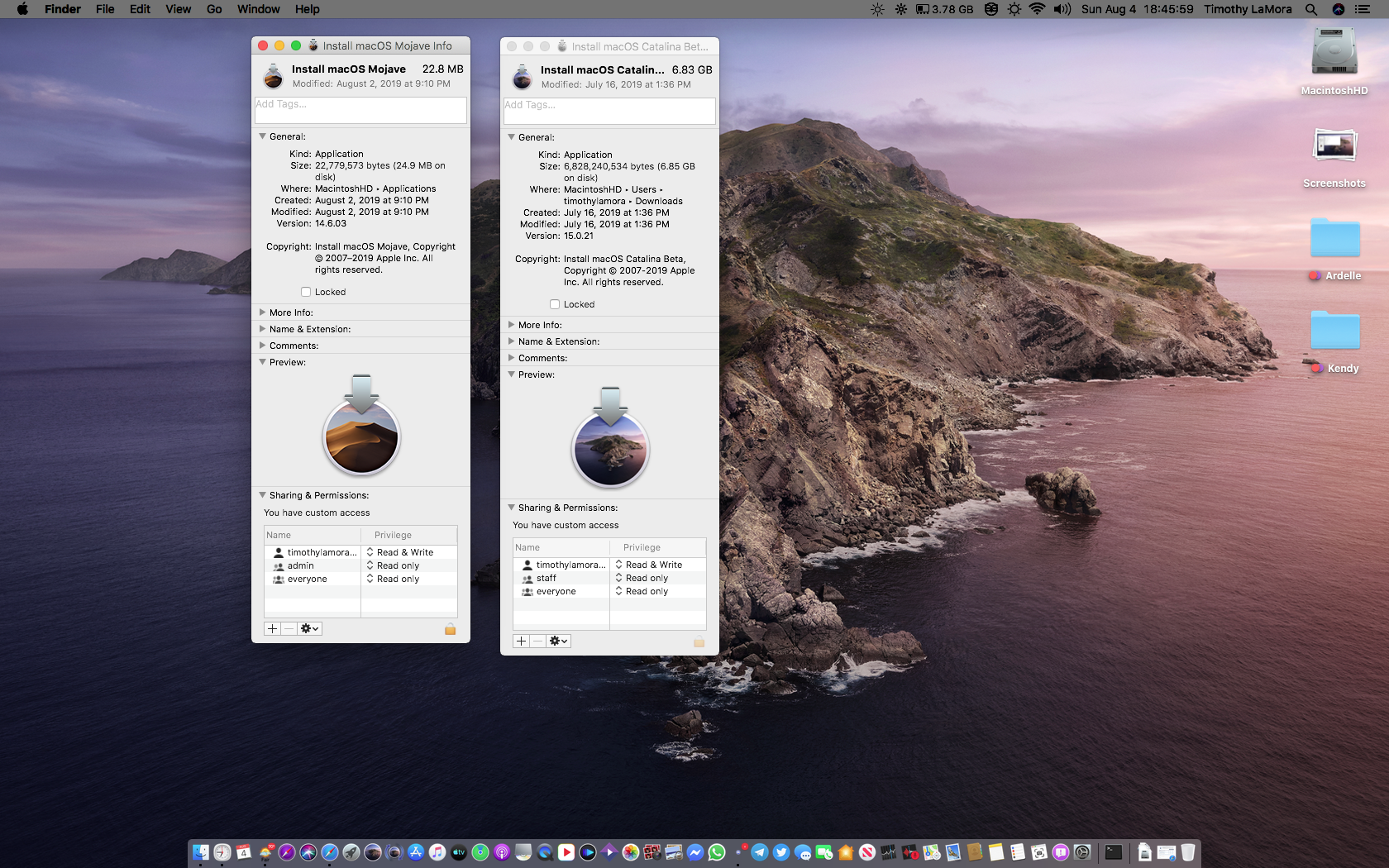

Is your Catalina Patcher USB at least 16GB and have you checked using first aid also check to see if you downloaded the full installer from the patcher it should be 7.3 GB for example I installed the macOS Mojave 10.14.6 Supplemental update had to make a new Mojave patcher then downloaded Mojave on my iMac 9,1 but it was only 22MB went to my MacBook 5,2 and downloaded Mojave and got the full installer 6.5 GB
I have already made several times, he does not boot from the hard drive. The system is installed but when I start I see no hard disk. have it just as you have said .....
EDIT:
I had the same error when I attempted to install macOS Sierra on APFS volume.
Reactions: crjackson2134
macOS High Sierra is the first macOS release that supported APFS as the boot volume. The macOS Sierra release only supported APFS as the non-boot volumes.
