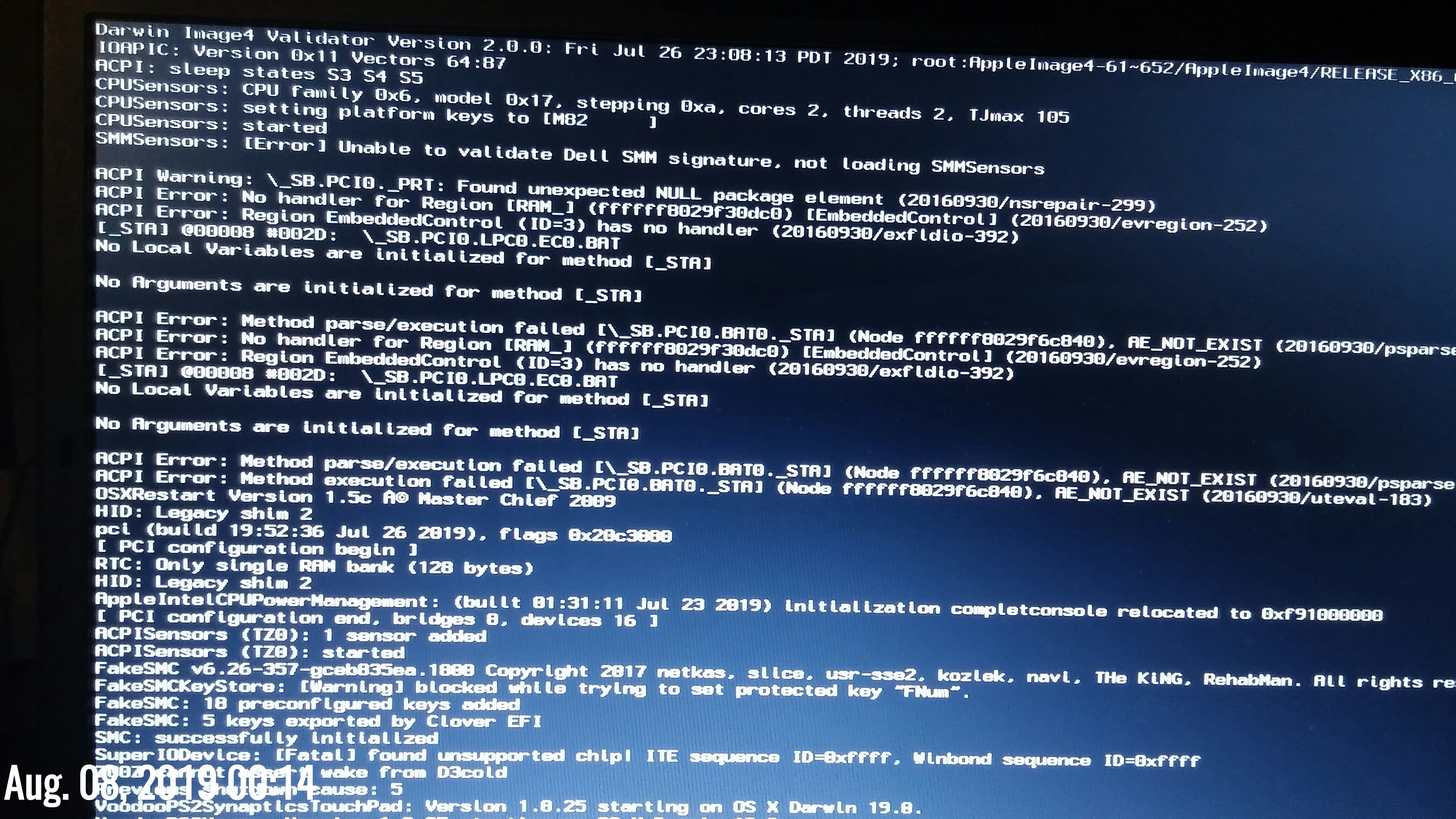

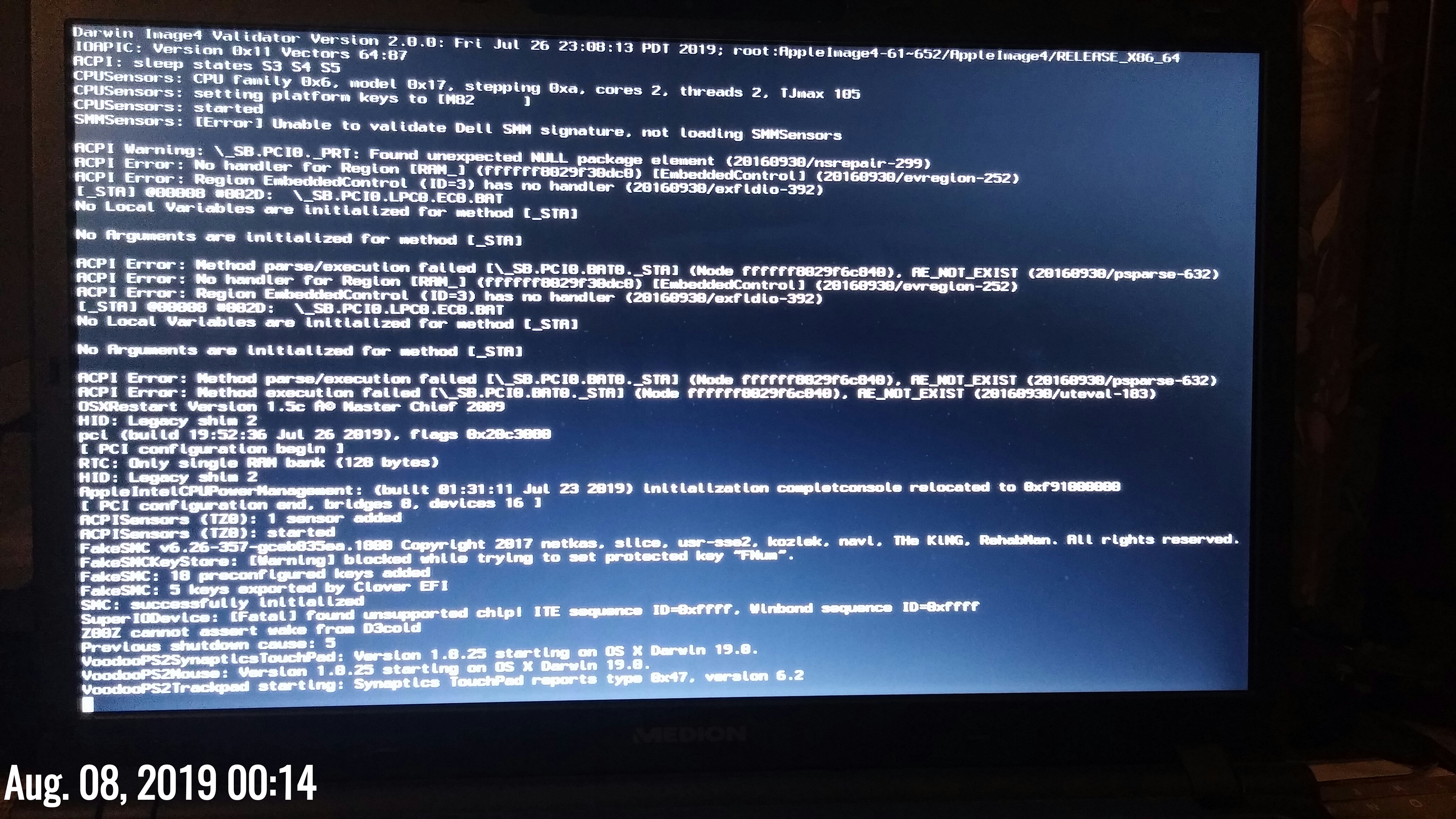

DP5 Catalina can not be ready. After level 2 of the installation, where the patches are then installed
and then reboot, it boots half way to the loading bar and stops.
I boot with -v are many ACPI Error error messages to see.
Even without dosdude1 patcher (test with 1.0.3 and 1.0.4), if I use the same kexte as the DP4 install, it is the same.
I then loaded a second time the full file of the DP5 (6.81 GB), but then the same.
Has something serious been changed from DP4 to DP5? My DP4 runs immaculately
without any problems and also then with dosdude1 Patcher 1.0.2 installed.
Does anyone have any tips for me, My Hack Book runs as MBP 5.2 see signature.

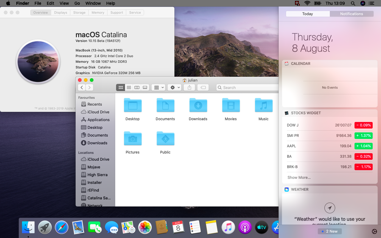

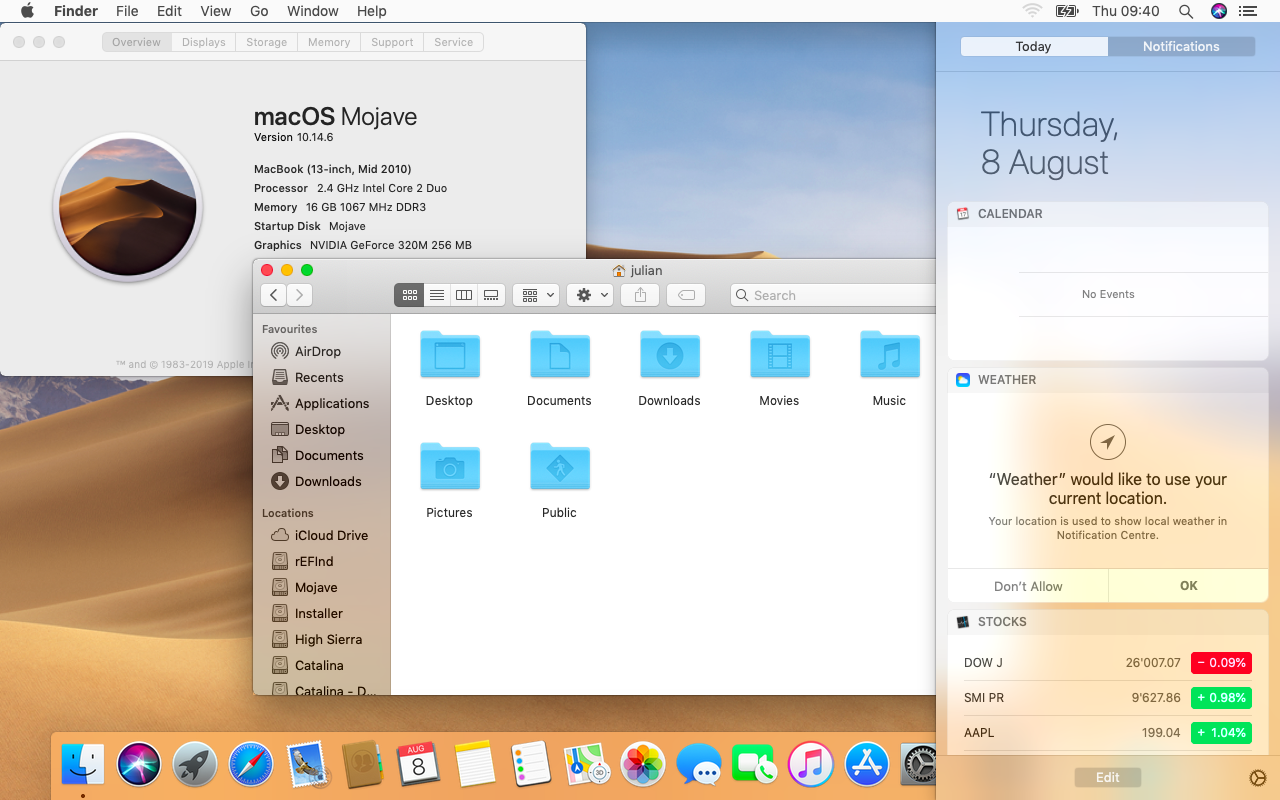

I just released a new tool for macOS 10.14 Mojave and macOS 10.15 Catalina.
Here are the release notes from GitHub: "BlueSky is a command-line patch tool for the SkyLight and HIToolbox frameworks. This tool is intended for non-Metal graphics cards running unsupported versions of macOS 10.14 Mojave and 10.15 Catalina. This tool fixes transparency issues by swapping UI materials in the SkyLight framework and setting the menubar and context menus to opaque in the HIToolbox framework. The HIToolbox framework patch is only supported on macOS 10.14 Mojave. The download size for the zip is around 100MB. If you download only the script then BlueSky will automatically download the full zip file that includes all the patched binaries. The original binaries are also included in the zip file and are used for the patch removing options. Backups are also made before and after patching in /Users/Shared. These backups can be restored manually but should only be used as a last resort. Please contact RMC if you need help in recovering a damaged system."
Download link: https://github.com/rmc-team/bluesky/releases/tag/1.0

View attachment 852098 View attachment 852099

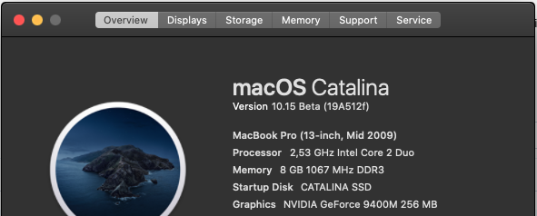

Yea! That worked for mine MBP 13 mid 09 on 10.15!
successfully installed latest beta on MBPro 5,5..with apfs ROM patch applied, used DOSDUDES1 latest patcher on a brand new ssd Samsung 860 evo,usb connected.!! And samsung flash drive 64 g as installer.Latest patcher is remarkably easy to use!!for a newbie!! I installed it over beta 2! siri,NS,Trim,Maps,Ftime,messages are on!!!photos not!! Temp is stable 55-65 c!!less beachballings and very stable!!Colin!!you make me happy!!!Have a good day you ALL!!View attachment 849958
